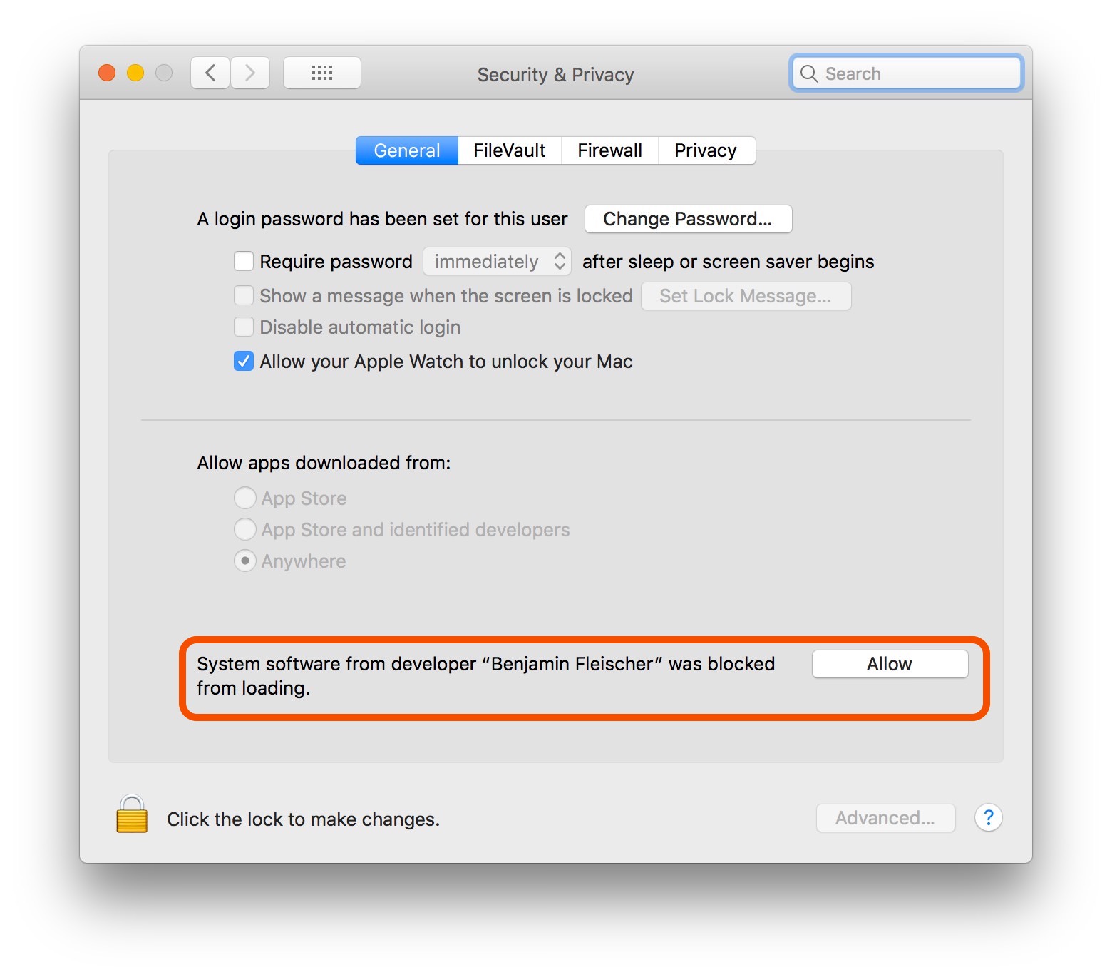

Check your security preference, may be you didn't "allow" the Nvidia web driver yet.
e.g. Something like this.
Reactions: Synchro3
Checked, nothing showing here.. Device detected properly everywhere in the OS, just severe lagging and graphics acceleration problems. Working fine on the same system with El Capitan and under Windows 10.

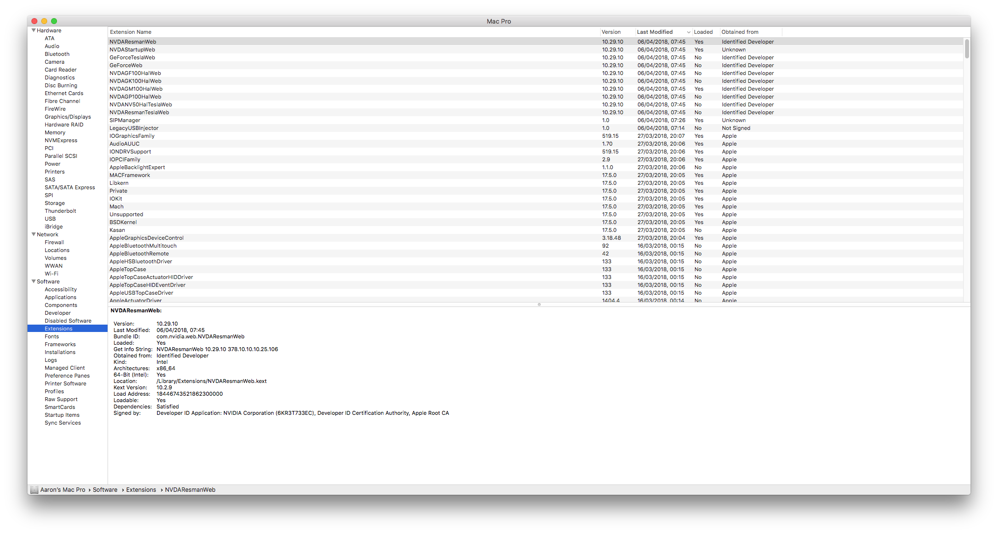

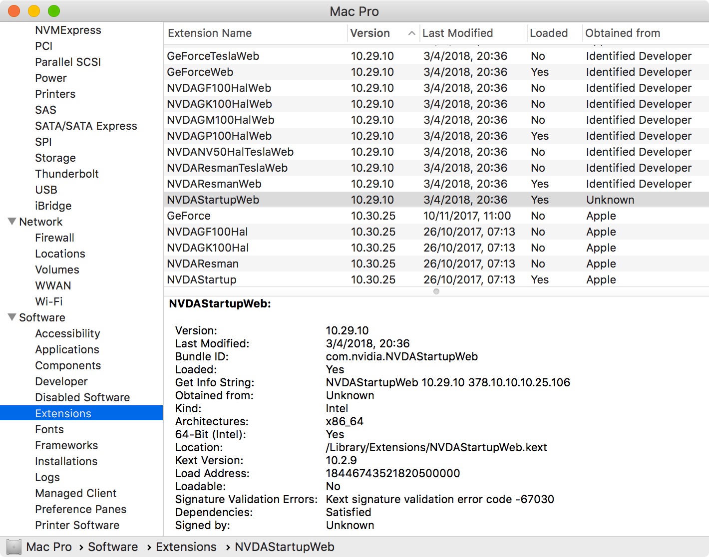

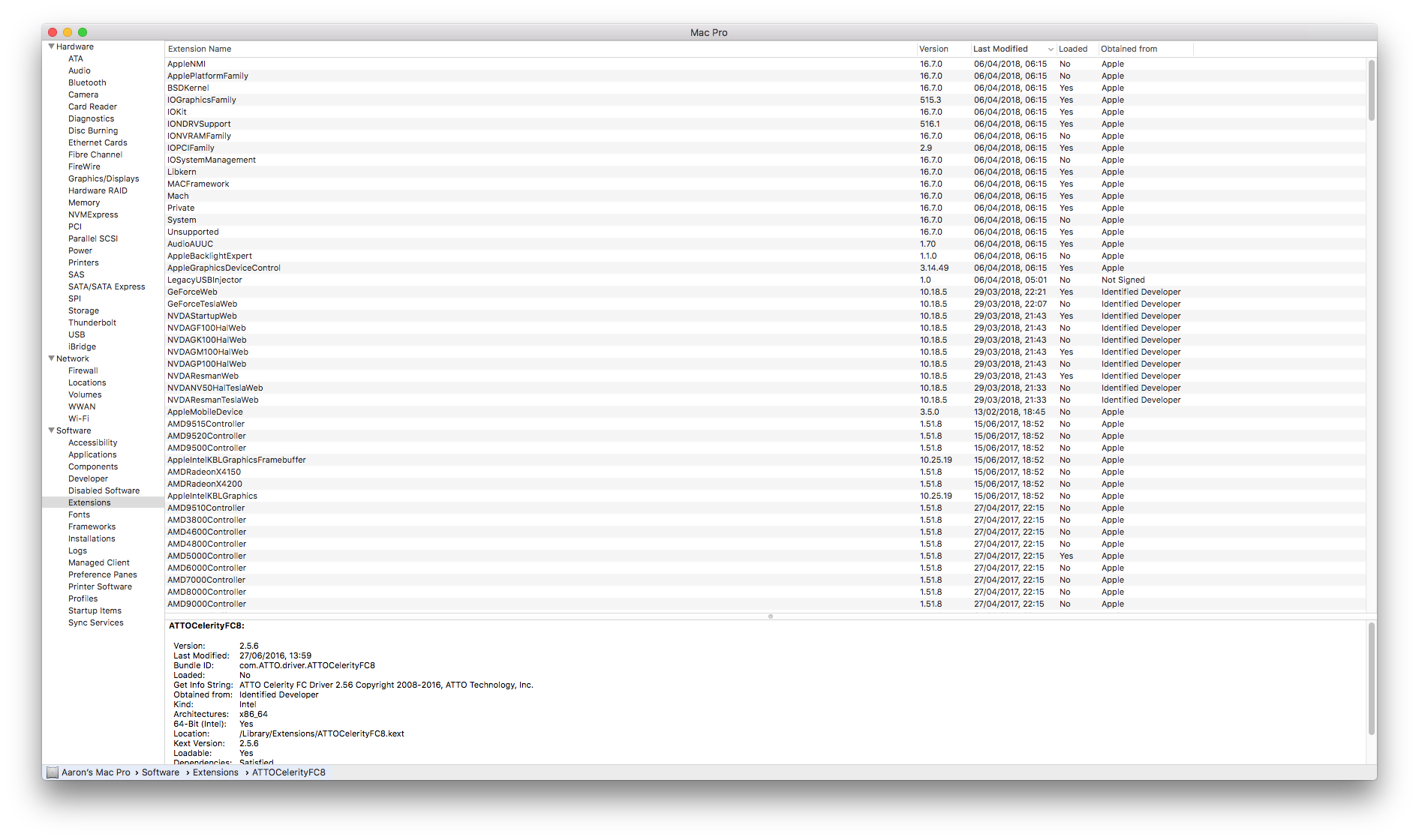

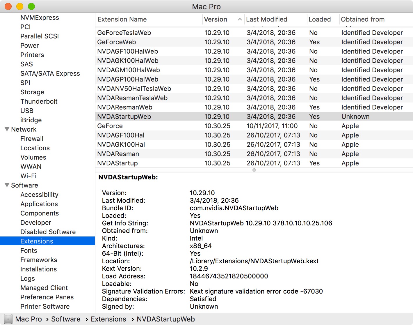

Can you confirm if the driver is really loaded properly?
In the Extensions page, use Version or Last Modified to sort the list. And then locate the Nvidia stuff.
Ohhh damn, didn't noticed the status (sorry, I've only had about 4 hours sleep in the past 2 days working on this lol) So, what can I do now?

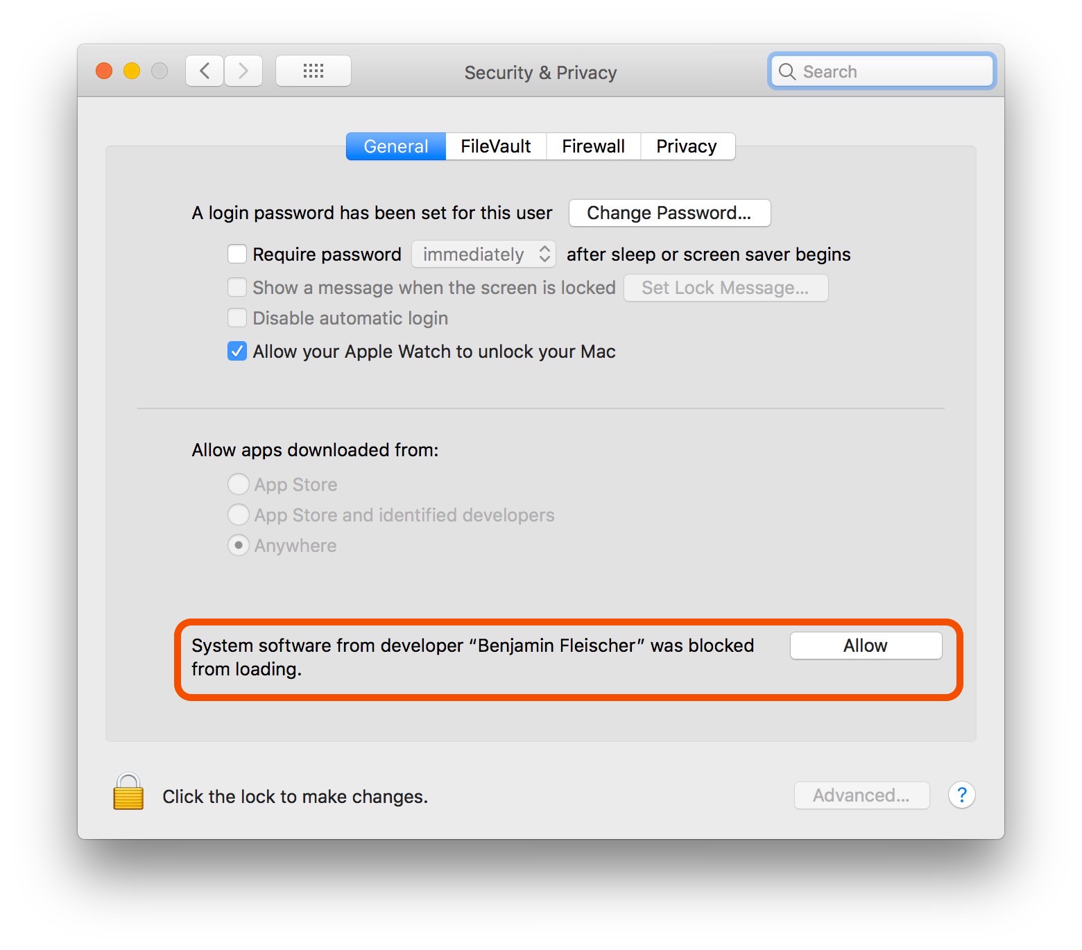

Not sure what cause that. But you may try
1) If SIP is disabled, try enable it, and check security preference again.
2) Or completely remove web driver, then install it again (recommend with both SIP and Gatekeeper ON)
3) Or completely disable SIP, and let the following script to install the web driver for you.

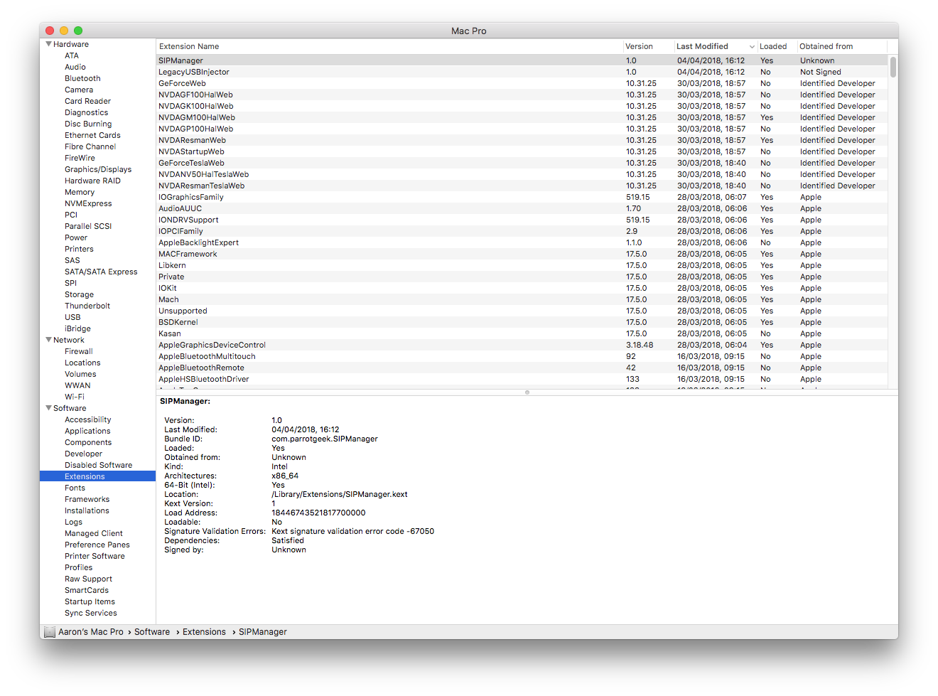

So, after much testing and working.. I've tried everything you mentioned, disabled / enable SIP, "allowed" the security prompt, removed and reinstalled drivers (both v103 and v105) but still nothing.
I've spoken with NVIDIA who basically say the drivers released recently (specifically for this model of Mac) are not designed for this card, and that they don't plan to release an update either.. but the fact is, this worked perfectly until just recently when this update occurred.
I'm fresh out of ideas 🙁
FYI, NVIDIA does not officially support cards past GTX 680 for Mac. Their driver works with newer cards but not officially. Opening a case or ticket with NVIDIA on Mac requires an officially supported card.
Suggest to fix the missing loader files, that’s not normal and likely part of the problem. On the face looks like it’s an installation issue... but you’re saying it’s not.
I agree with you 100% that it's an installation issue, but then again, how many ways can you install the driver. If I'm missing something, then I'll be sure to correct it, but here's an overview of the steps I've taken:
  1. Enabled SIP to see if it would prompt for "security Allow" - which it did, and I "Allowed" the extensions
  2. Rebooted to see if that resolved - which it did not.
  3. Uninstalled the web drivers (with SIP enabled) and reinstalled the drivers directly from NVIDIA
  4. This did not solve the issue, so uninstalled the drivers again.
  5. Rebooted - driverless
  6. Rebooted again and disabled SIP
  7. Downloaded the drivers using the bash command by Benjamin
  8. Rebooted the system
  9. Tested graphics, same issue present
  10. Rebooted and Enabled SIP again to see if it prompts me to allow the extensions
  11. Same issue present.
So you see, I think I've tried everything. I REALLY appreciate you sticking with me on this and trying to get it sorted. If we manage to resolve this, it'll please a lot of people!

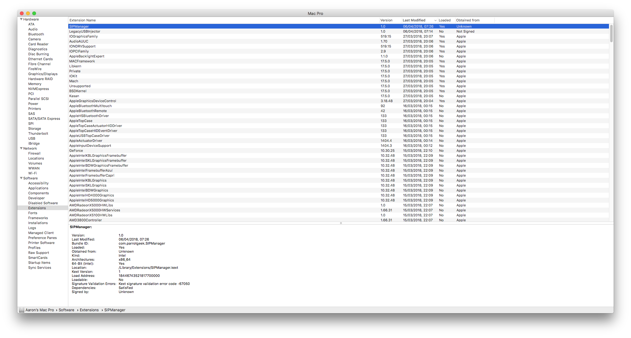

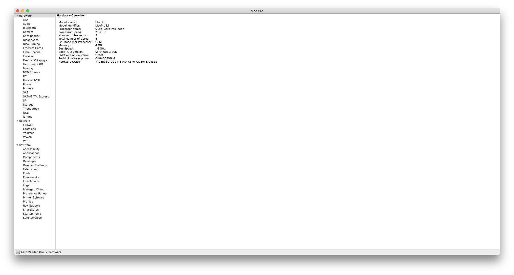

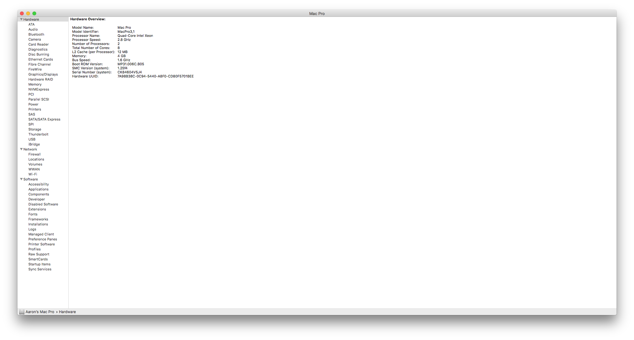

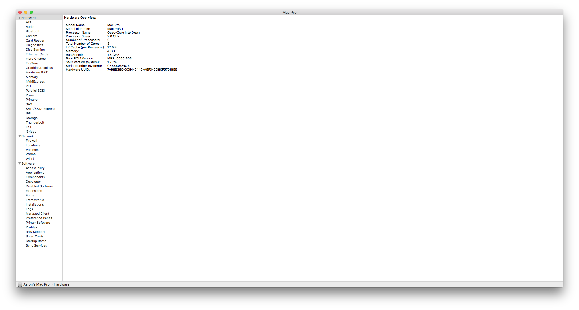

What does system report > hardware show?
Why are you not on the latest NVIDIA web driver if you’re using 10.13.4? That alone is an issue, unless you really know what you’re doing with driver rollbacks. And even then, the newest drivers WORK but have some color issues for some users with flashed cards.
Well, since messing around so much, the card isn't even detected in the system anymore. I am on the previous drivers as a result of using the script by Benjamin Dobell (which apparently detects the most compatible card) but of course, the first drivers I installed were the most up-to-date ones.

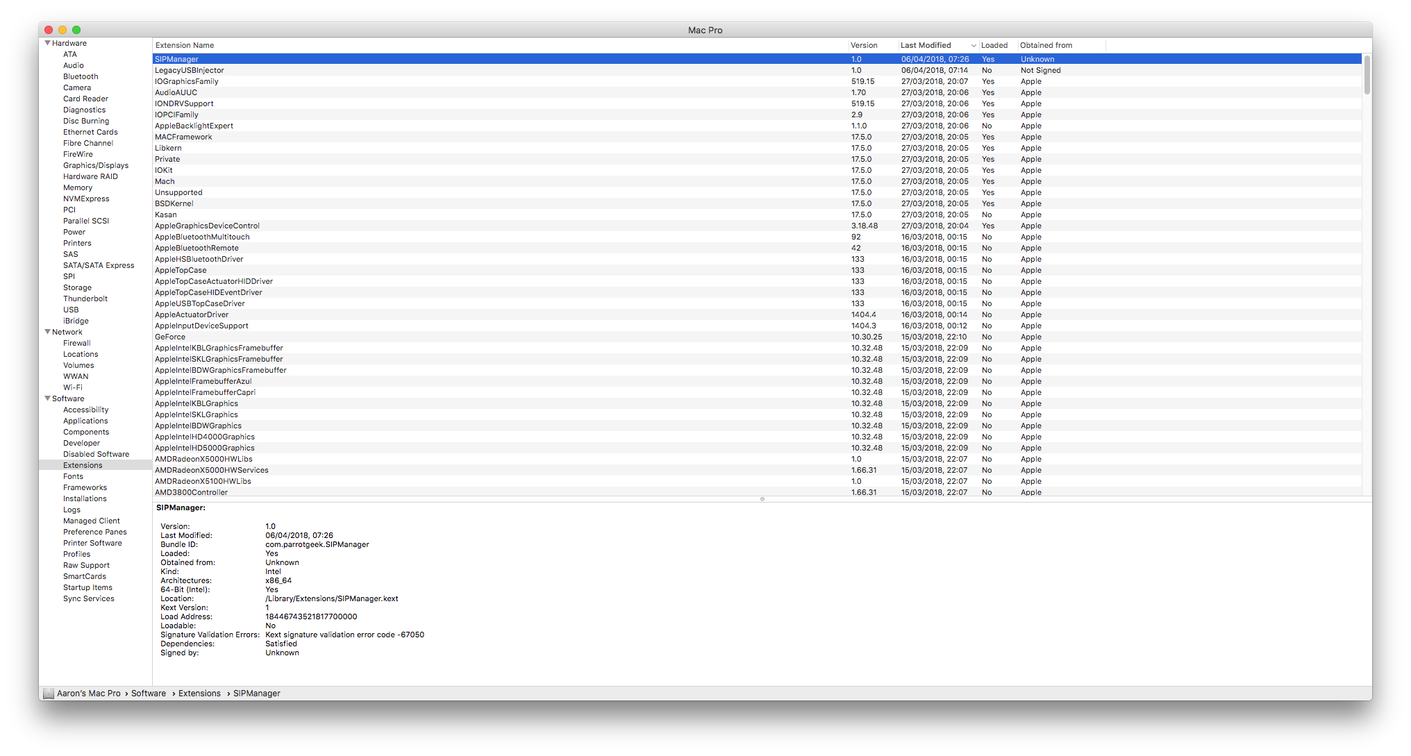

UPDATE: So I've installed macOS Sierra (not High Sierra) and installed using the script by Benjamin.
Code:
bash <(curl -s https://raw.githubusercontent.com/Benjamin-Dobell/nvidia-update/master/nvidia-update.sh)
Managed to perform all software updates in macOS and can confirm that it's working 100% totally fine.

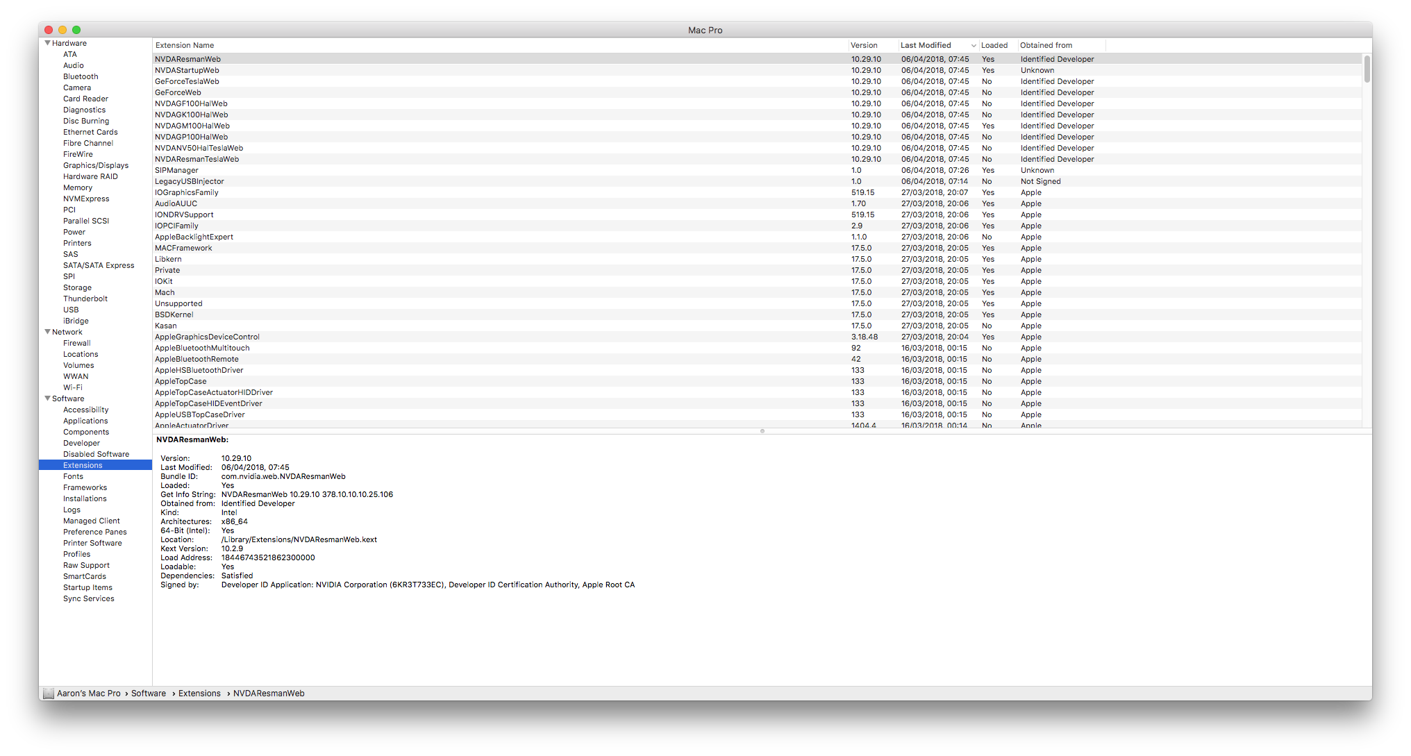

Extensions are as follows:

Showing both the Hardware Overview with the Extensions summary will help in the future, FYI.

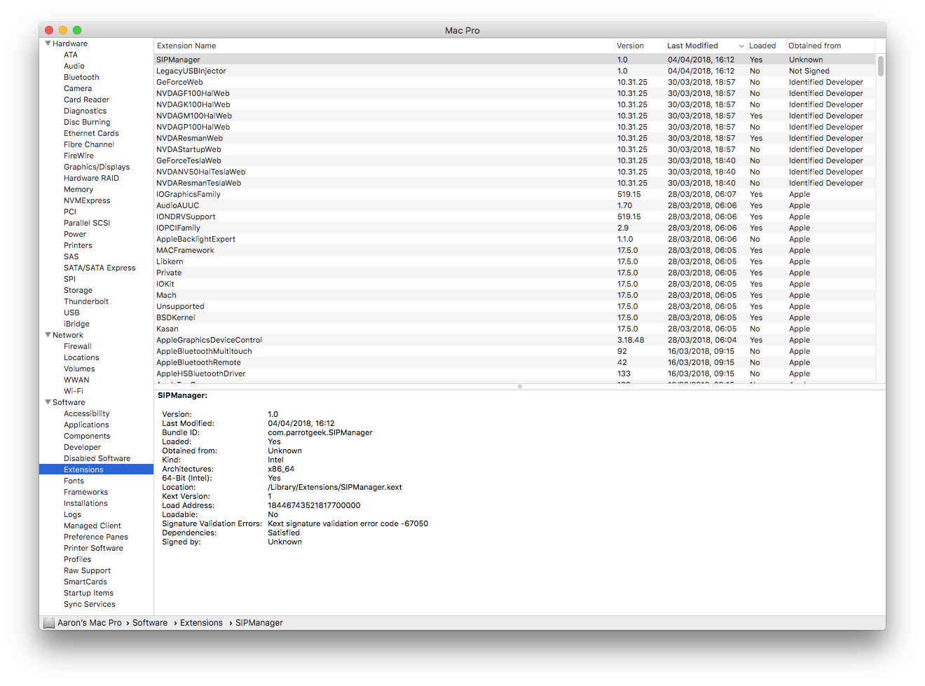

So, installation complete, using DosDude1's High Sierra patch tool and installed default recommended patches.
Here's the overview of the "fresh installed" extensions, without NVIDIA being installed yet.
I've also included a print file of my entire Extensions list, and then I'll upload the new versions when the NVIDIA drivers have been installed, using the script mentioned earlier.
[doublepost=1523027372][/doublepost]Just completed the Installation of NVIDIA Web Driver 378.10.10.10.25.106 via the terminal command and it's done exactly the same. Inverted menu bar, weird grey areas in the heading of windows etc.

UPDATE:
Installed the NVIDIA Web Driver 378.10.10.10.25.106 using the script mentioned previously, system restarted, graphics card detected, but same issue with corruption / lagging interfaces etc.
System profiler seems to be reporting all is well, but still not okay. I've included a video also, this will show you the sorta of issues that are present. (notice the boxes and flickering.. also the inverted menu bar colour).
Thanks. I didn't see your reply before installing High Sierra onto the USB HDD, it's done now. In fact, I'm writing to you from it.. The purpose is just so I can go in and test it if I need to see if there have been any updates or fixes for this problem in the future. But sure, I can also always slide it into the Mac itself to try out.
View attachment 757160 View attachment 757161
UPDATE:
