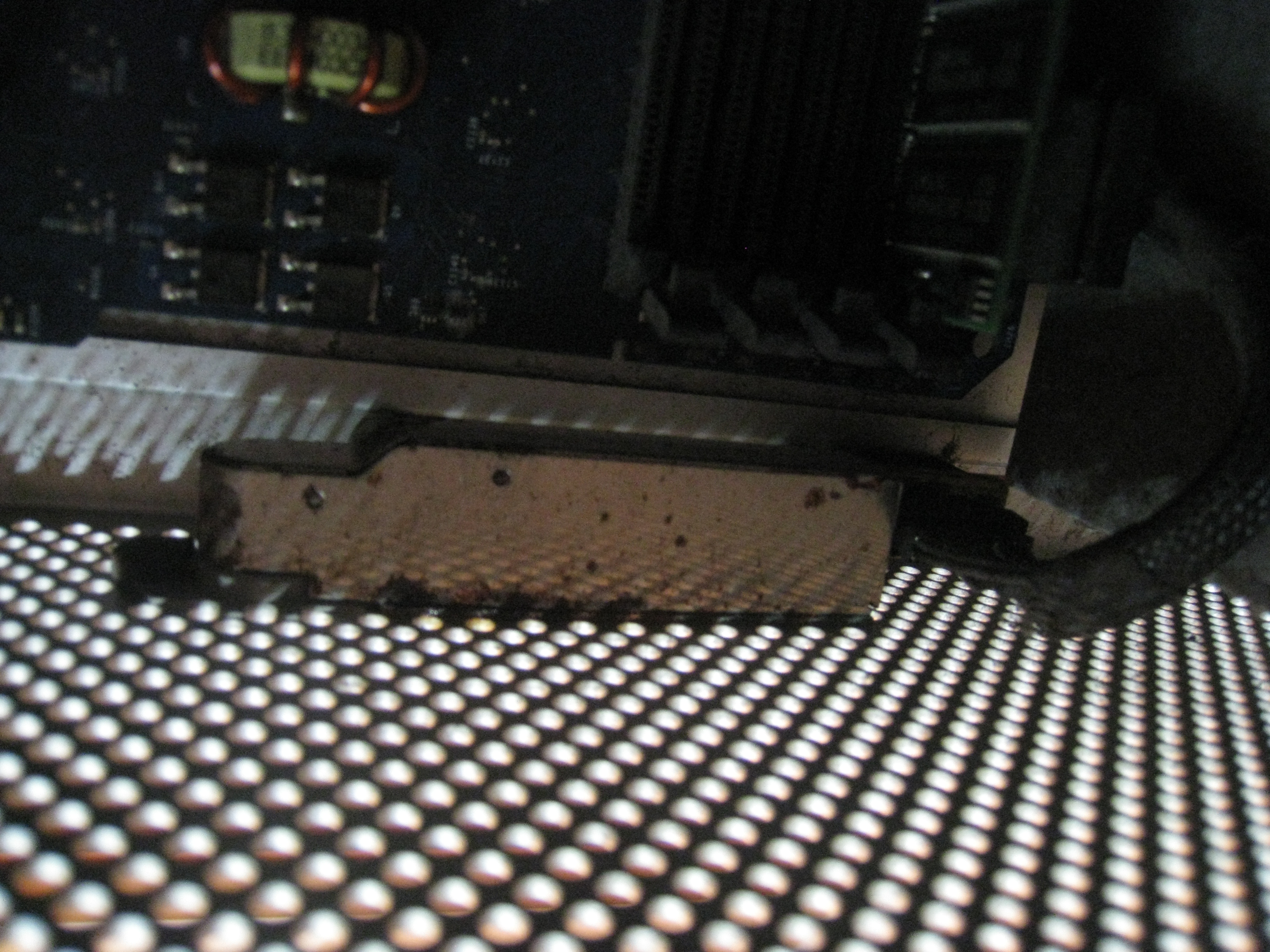

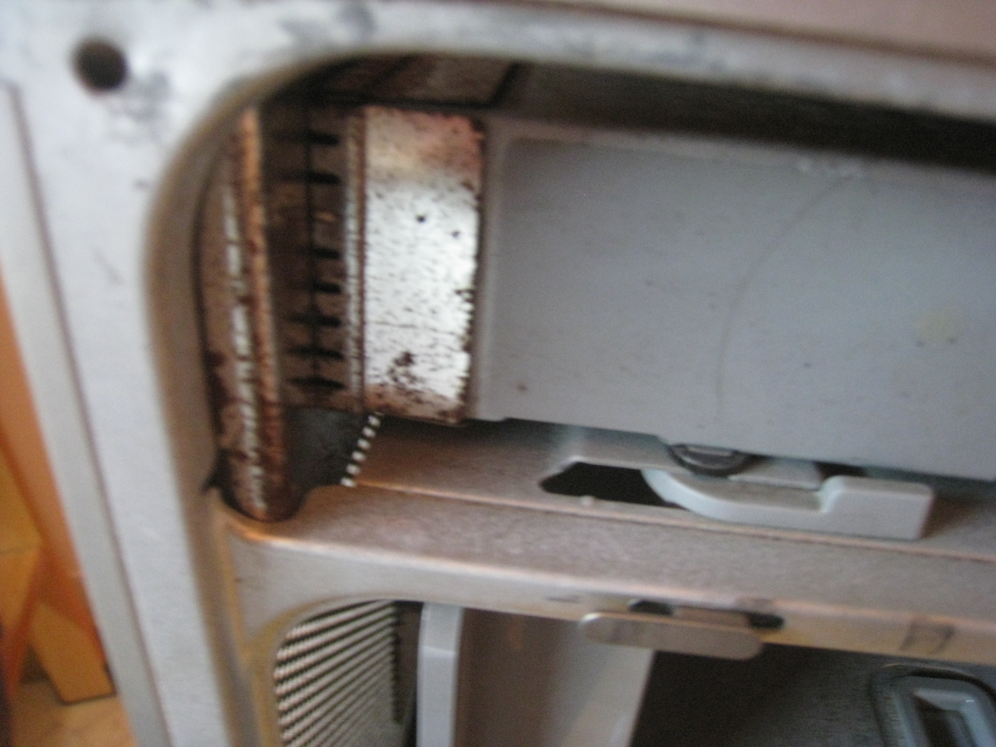

Just got a dead G5 (2.0 DP) off my local market, the case is polluted by chemicals(I believe it's used in a factory before it died). It comes without any memory, hard drive screws, air deflector or PRAM battery.
First thing that I do is to reset PMU while unplugged. It didn't work afterwards then I try again while plugged in and it turned on with no chime (power led blinks quickly).
I noticed that I forgot to install the memory, I salvaged one 512 MB and one 1024 MB DIMM off my old PC, installed it and still not booting.
Some more information:
When I plug in my G5 onto an outlet, I can hear the normal "click" sound, so I am quite sure it'n not caused by the PSU.
Since the G5 seems to be exposed to chemicals for a long amount of time and corroded some of the metals inside(See pics below), can this be the cause of my problem?

Defective solder joints on RAM slots.

It's possible that the solder joints of the dimm slots have been corroded?

Also, you're probably want to wipe down the internals and clean them of any chemicals if you're keeping the computer, the metal is only going to continue to corrode.
Buy the air deflector, it's extremely important to have one for cooling purposes.
As far as a DVD+R DL goes, the superdrive should definitely read it unless it's a bad copy or the drive is busted, retail copies of OS X ship on DL DVDs. Just get a retail disc and see if that works, if not, replace your DVD drive.
Right now, what should I use to remove the rust on the power button/superdrive EMI shields, as well as the white substance on the CPU heatsink?
I wonder what kind of chemicals can cause such cometic damage (May become structural or hardware damage soon if I ignore it)?
