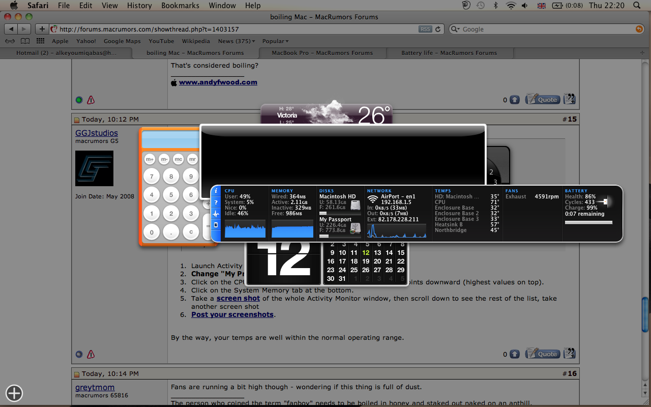

yessss
TEMPS
HD: Macintosh 35
CPU: 70
Enclosure base:35
Enclosure base2:35
Enclosure base3:34
Heatsink B:58
Northbridge:47
FANS
5431rpm

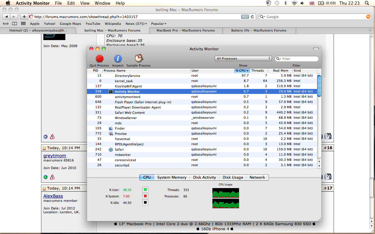

  1. Launch Activity Monitor
  2. Change "My Processes" at the top to "All Processes"
  3. Click on the CPU column heading once or twice, so the arrow points downward (highest values on top).
  4. Click on the System Memory tab at the bottom.
  5. Take a screen shot of the whole Activity Monitor window, then scroll down to see the rest of the list, take another screen shot
  6. Post your screenshots.
By the way, your temps are well within the normal operating range.
Those are very normal temps. My computer often gets up to around 85-95, but that's when I'm hosting a server, watching an HD yt video and playing call of duty at the same time.
If you want to reduce the temperatures, may I suggest Arctic Silver 5 or download smcFanControl to change the speed of the fan.

ok ^_^

It's very unlikely that your Mac needs cleaning. The culprit is the runaway DirectoryService process. Follow the link I posted to resolve that issue, and your heat and fans should return to normal.

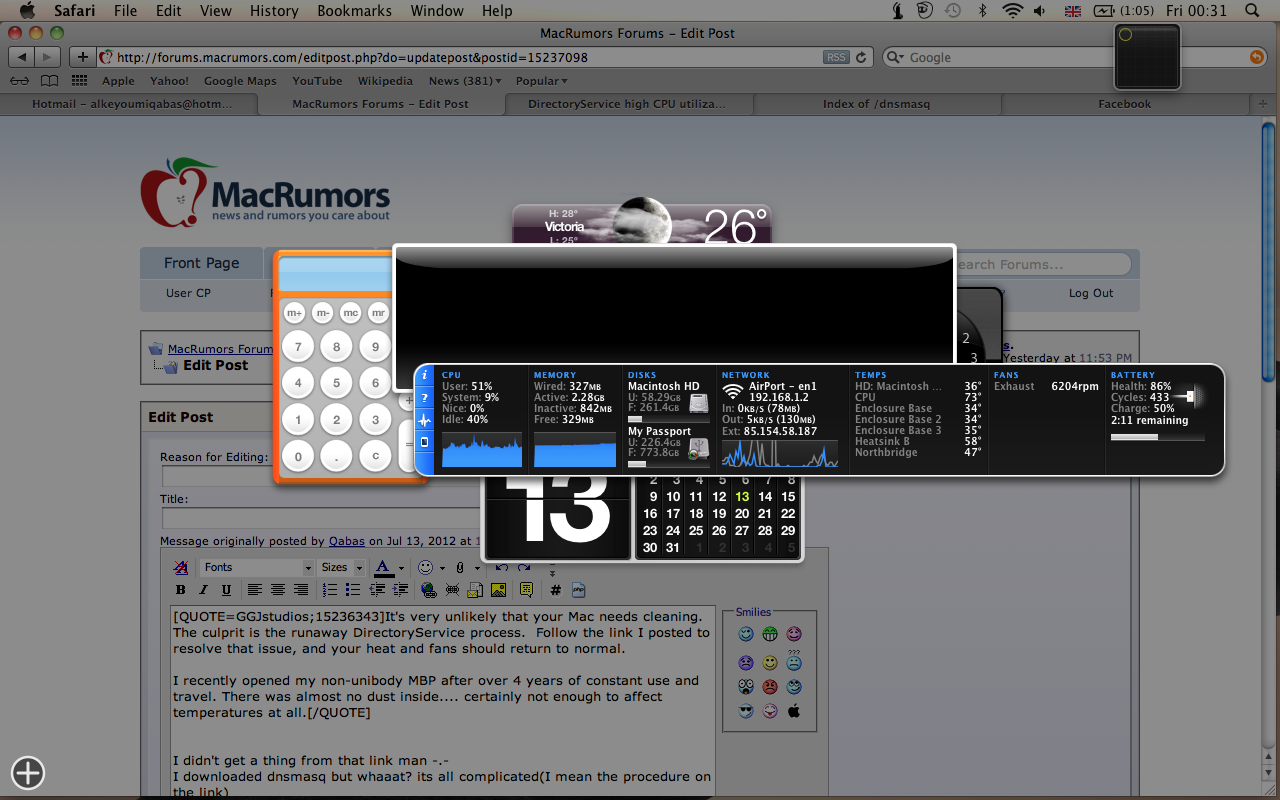

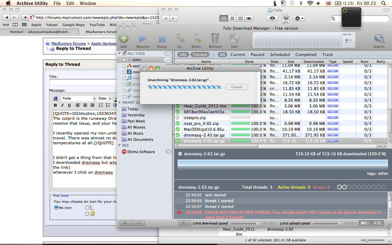

I didn't get a thing from that link man -.-
I downloaded dnsmasq but whaaat? its all complicated(I mean the procedure on the link)
I couldn't understand it<<how am I supposed to do it -.-
what if i took my laptop to the nearest apple store? would they do all of that for me?
