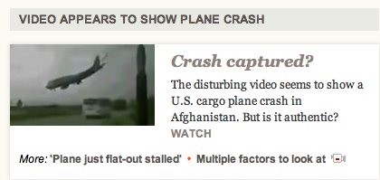

Seriously CNN? Is there questions of the video being fake cause I am at a loss as to why CNN would put this up.....
A 17 knot loss of airspeed should not cause a stall, however -TSRA (light thunderstrom rain) in the weather report could be associated with a microburst. Normally when I think of a microburst, I think of a thunderstorm over head. Did not see that in the video, but...
I don't think TSRA would as well, but you are onto something. With that quick of a shift in wind direction, wind sheer would definitely be a factor in the loss of airspeed. That would explain the loss of air speed. That, plus SOPs for departing out of a war zones like BGM are all contributing factors. I'd expect changes to be made to those SOPs.
Simple. Sensationalism in the hopes of attracting people to their site to get hits and make money. It should say a lot when media outlets sacrifices their integrity for profit.

While anything is possible, I think the odds are relatively low that the autopilot would hijack the aircraft and drive it into this situation. Even so, some pilots put the aircraft on autopilot right away after takeoff, but many, I even would say most do not. Even if they did, and they are monitoring, they would see this situation developing and click it off before it gets out of hand, to make a correction.
What could mess up a recovery from an unexpected nose high situation? A cargo shift, engine failure, or flight control malfunction, keeping in mind the cargo shift could precipitate the situation.
Why is the guy so eerily quiet on the YouTube video? You'd think that if you saw something like that happen right in front of you you would say "Hly ****" or something. No?
I've witnessed multiple car pileups and accidents, obviously nothing on this magnitude and my reaction is to be silent and watch it intently.
