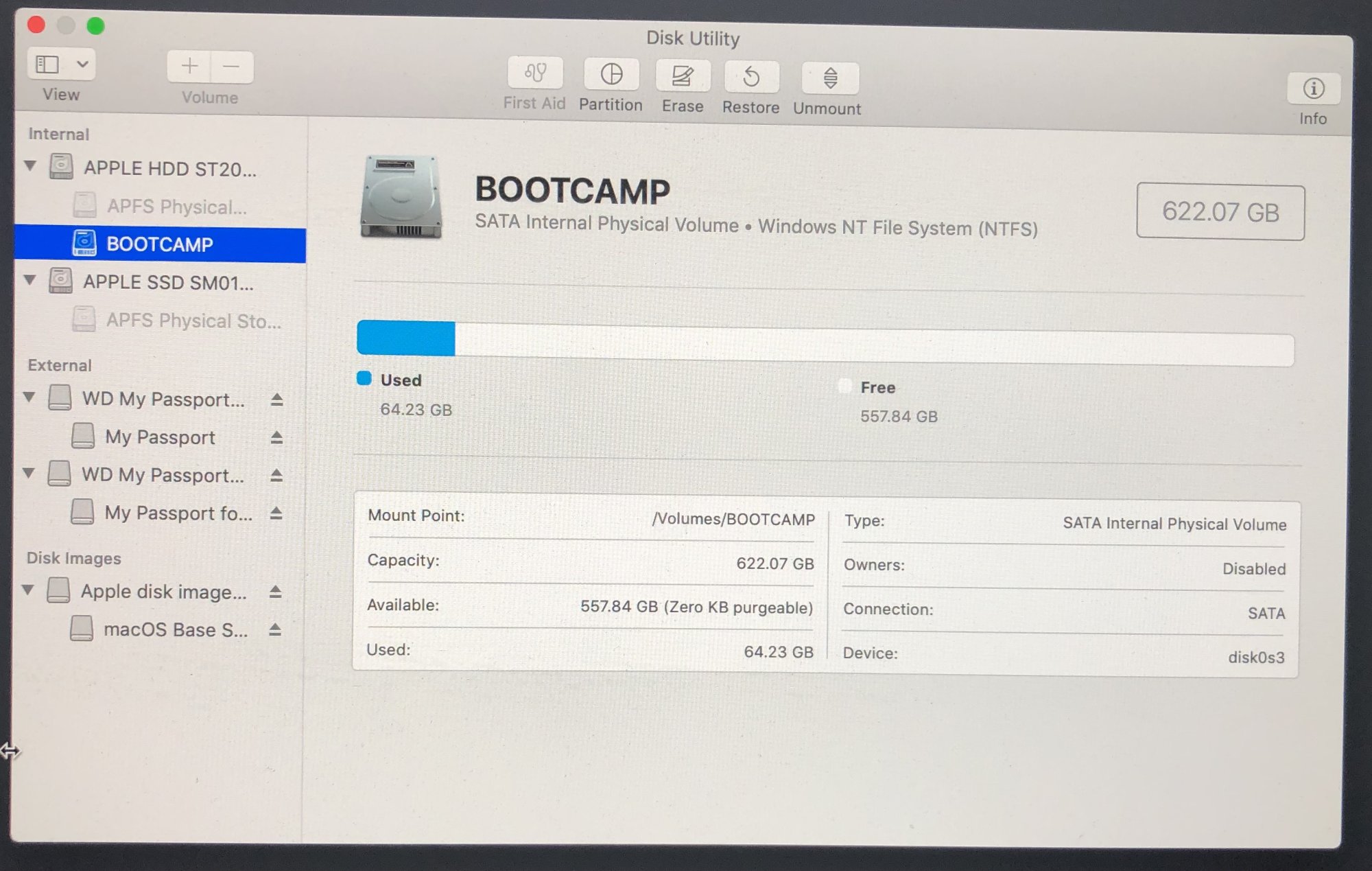

I tried resetting the Fusion drive today and it wouldn’t let me do it because of the Bootcamp partition. Here’s the screen cap.
"I tried resetting the Fusion drive today and it wouldn’t let me do it because of the Bootcamp partition."
Get rid of bootcamp.
Then... start over.

Yeah. I kind of figured that, but how do I do that? I clicked on Bootcamp in Disk Utility and then “erase” and it asked me for a name and format.
Yes, you will need to change the format for the bootcamp partition, as it is NTFS. The idea here is that you have to remove that bootcamp partition, as you can't reset the fusion drive when there is a non-writeable partition in place.
One method to do that is to choose the device (line starts with "APPLE HDD ST20..." Erase that device, which will then remove all associated partitions (bootcamp, which is what you want to remove. Erasing the device takes that partition, too.) And, after erasing that drive, you will then be able to reset the fusion drive, following the steps that you tried to use before.
Reactions: ChuckLDJ

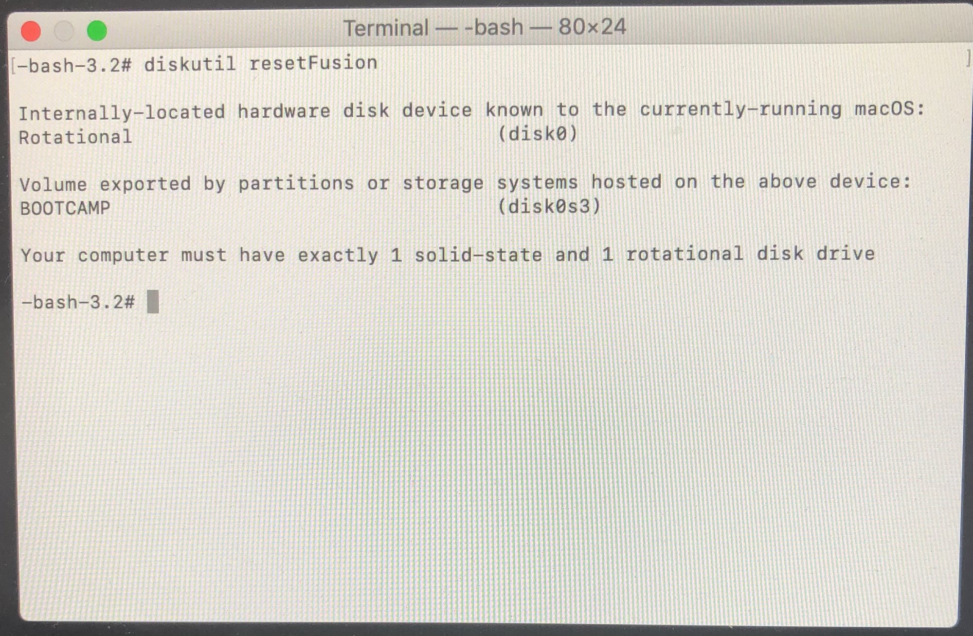

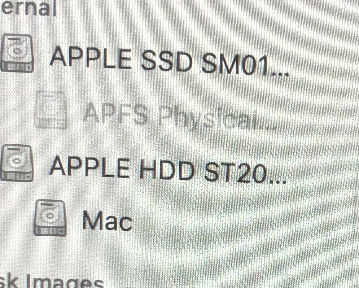

This is what happens for me. I go to Disk Utility. I click “view all”. Then I click on “APPLE HDD ST2000…”. Then click “erase”. It asks for name so I just type in Mac. It asks for format so I have it at Mac OS Extended (Journaled). It asks for scheme so I have it at GUID Partition Map. Then click erase. When it’s finished, under “view all” it shows Mac beneath APPLE HDD ST2000…(see the attached photo). Apparently I’m still doing something incorrectly because when I go to Terminal and type “diskutil resetFusion” it tells me that I must have exactly one solid-state and one rotational disk drive.
I guess you should run one of the commands further down in that linked article...
Well, now I feel more like an idiot than before I started. I could have sworn this machine came with Mojave installed but apparently it didn’t. The Fusion drive is now reset. Thanks for the help and sorry for the aggravation.
