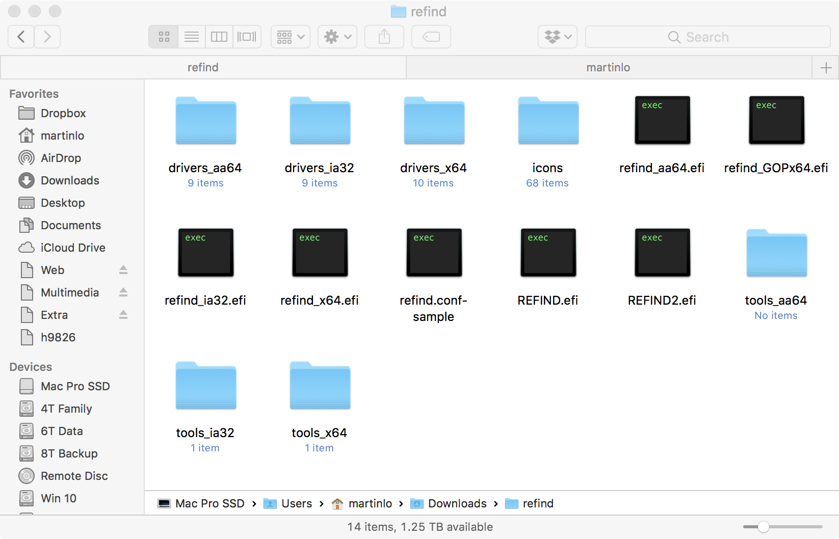

2) Unzip it, you should able to see something like this inside the folder.

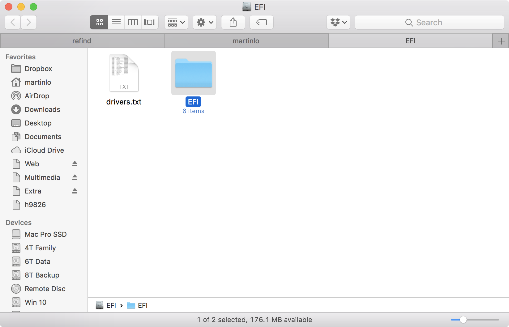

7) Open this drive in Finder. Depends on the drive you chose, it may be blank, may be have something inside. If there is already a folder also call "EFI", you are good to go. If nothing there, then create a folder called "EFI" (capital letter) by yourself.

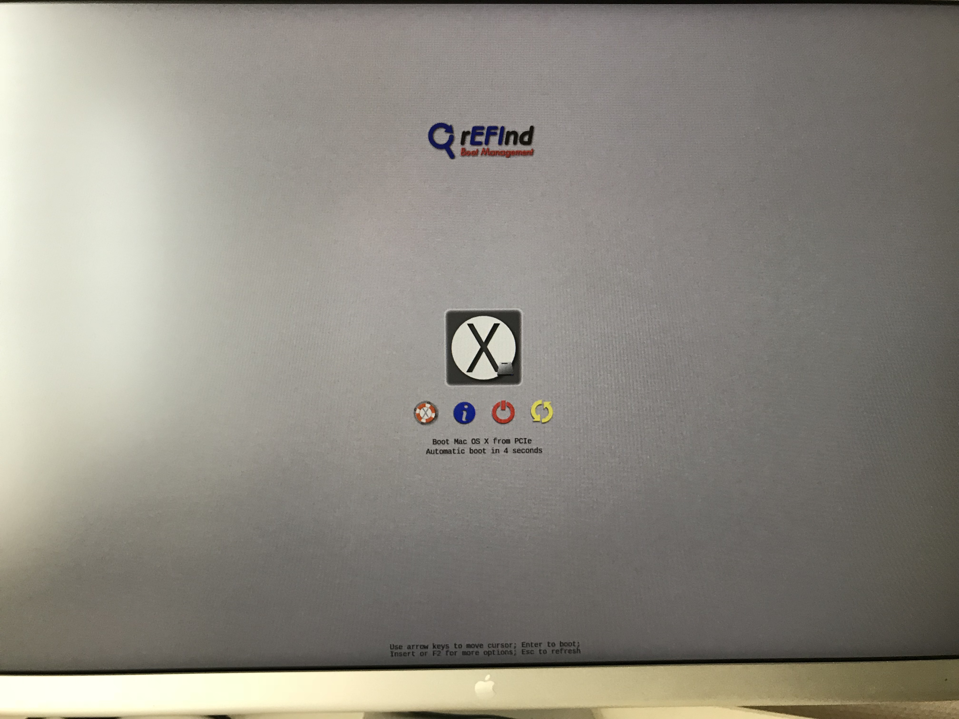

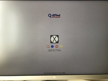

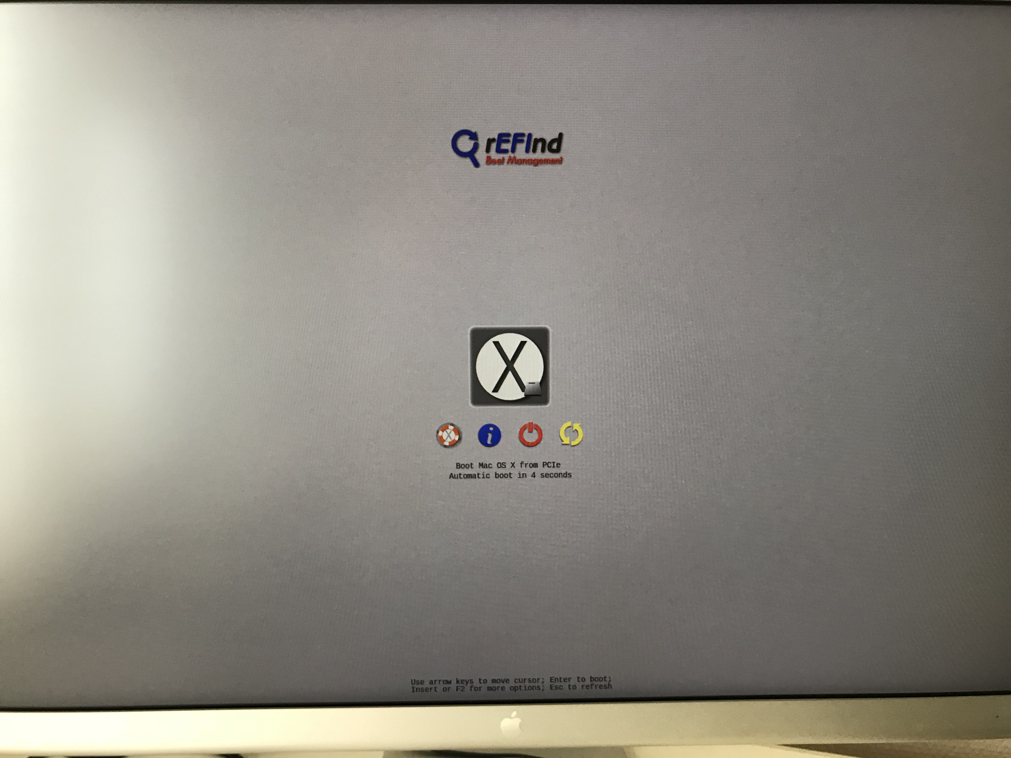

I assume this is the result we wanted? Mac Pro 3,1 with VEGA FE showing boot screen.
Awesome, I figured it would work with the 3,1, just don't know why it doesn't seem to with the 5,1.
4,1 untested, as I assume most folks already flashed them to 5,1.
Million thanks, you proved DearthnVader’s work is actually good.
