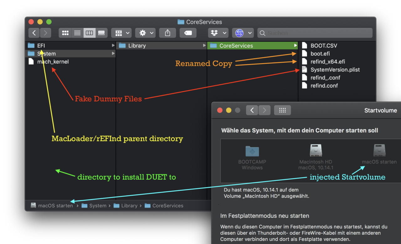

This is just how Clover BIOS works. It's basically loading Clover EFI using Duet. For some further testing you could just install Clover in BIOS mode to an internal MBR disk and then replace the clover files with for instance the MacLoader or rEFInd ones.
Theoretically it should even be possible to create a refind MBR EFI USB disguised as macOS, which automatically start a legacy boot residing on itself which in turn starts MacLoader or a second ordinary instance of rEFInd in the EFI/REFIND directory.
PS: I use this do enable BOOTCAMP's restart to macOS feature which does not work on APFS. – refind.conf if configured to automatically chain load macOS.

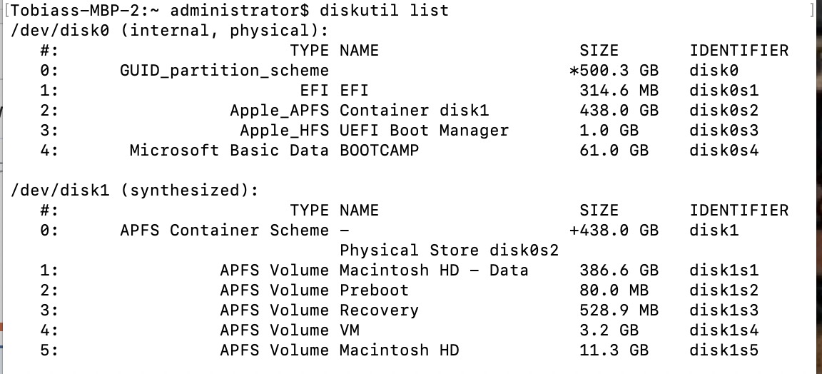

Hi there,
I have a question about configuring the next-loader boot options, as I did not fully understand the documentation.
I installed next-loader after I had installed Windows 10 with the help of Apple boot camp.
The installation of next-loader went smoothly, but now I have three boot options, which are automatically recognised: "Windows EFI", "Mac OS X" and "Windows (Legacy)". I used only first two options (Windows and Mac OSX). "Windows (Legacy)" does not work and I am not sure where this option is coming from. A screenshot of my partition table is below.
I would like to remove the "Windows (Legacy)" option from the book options, but do now know how to do this in the configuration files (loader.conf or stanzas.conf). Any advice would be appreciated.

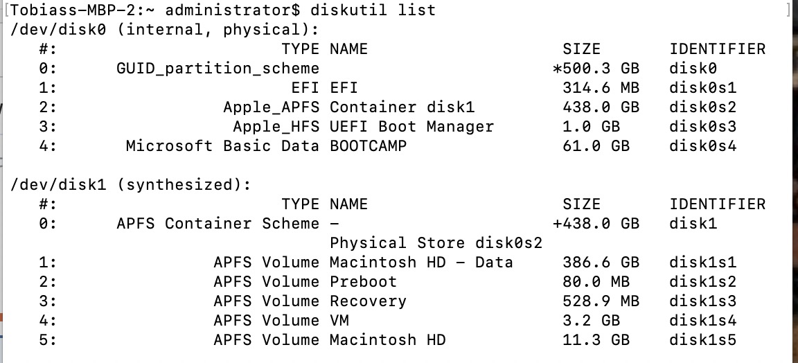

Hi there,

Thanks for the quick reply. I am fairly happy with next-loader and would prefer to keep it, as it should not be too difficult to remove the unwanted third boot option. Any possibility for an advice on how to remove it?

I have never tried Next Loader but know it is a fork of Refind and think that the config would likely work on the same principles as Refind's.
You can therefore try adding "Windows (Legacy)" with the quotes, or perhaps just "Legacy", to the dont_scan_volumes option.
I presume there is such an option.
This is a band aid around some other issue why a non existent thing should be coming up but should work for your purposes.
