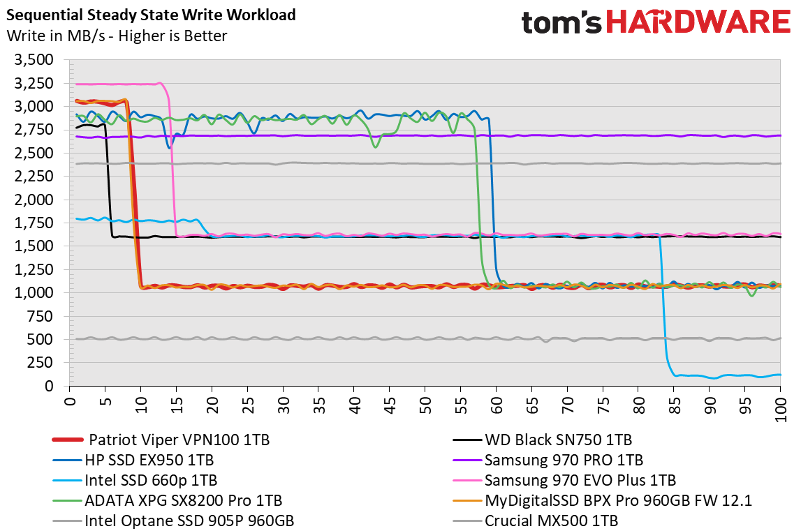

Sabrent Rocket is a fine SSD, high TBW, a bit slower than a 970 EVO in sustained writes. I have the 1TB version, assuming the 4TB version is similar.
It uses the Phison E12 controller which I posted about here with performance comparisons. The difference between the Sabrent Rocket and the Samsung 970 Pro is sustained write speed. In a large file copy the 970 Pro will sustain write speeds close to 3,000 MB/s for the entirety of the copy. All its flash chips are fast ones.
The Sabrent Rocket, 970 Evo, and most other NVMe blades like surely whatever OWC is selling, will start out fast near 3,000 MB/s in a large file transfer, but after a certain number of GBs copied it will slow down to somewhere between 1,000-1,500MB/s for the rest of the file. These drives have a mix of fast chips as cache and the rest are slower chips. Sabrent Rocket has less of that fast cache than 970 Evo, but most NVMe SSDs that aren’t the 970 Pro work the same way.
The Sabrent Rocket will perform similar to the Patriot Viper in this test:
If writing very large files isn’t an important part of your workflow then the Sabrent Rocket is a fine SSD generally. If you do often write large files of many GBs per file then the 970 Pro would be the way to go.

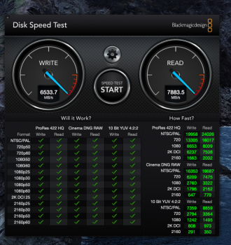

im kind of surprised at how slow the sonnet is. Shouldn’t it be getting somewhere from 12-14GBs end it seems to get about half of that per this 9 to 5 article:
with 4 4xlanes that each could do 3.5GBs, something seems lost in translation?
Reactions: dpzim
SoftRAID may give better results. Compare Disk Utlity (7467 MB/s) #212 and SoftRAID #214 (11141 MB/s) in a Hackintosh PCIe 3.0 x16 slot.
Since performance is so bad with Disk Utility and the x4 card, consider Amfeltec's x6 card. The extra 2 slots will definitely fulfill the x16 slot's potential.

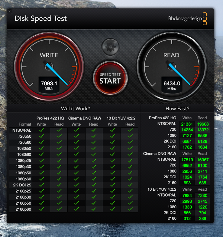

I just installed the Sonnet M.2 4x4 PCIe card and 4 x 2TB Samsung 970 EVO Plus NVMe M.2 into my new Mac Pro 2019.
Installed into Slot 5
Configured as APFS (Case Sensitive) each drive.
Then RAID 0 all 4 drives together to create a single volume (non boot drive)
APFS (Case Senstive), 64kb chunks, GUID.
Here's my first speed test (attached).
Does this speed look correct? A single drive was about half that, but thought I'd get faster than 6300 write speeds with 4 in a RAID 0.

I just redid my RAID 0 with SoftRAID instead of Disk Utility and am getting roughly the same results. Hmmm...
This seems no faster than the OWC 8TB solution that is cheaper and could fit on an 8x slot (no fan and save 16x slots). Thoughts??
