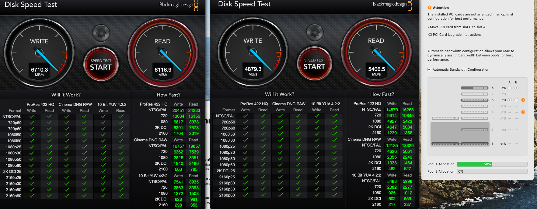

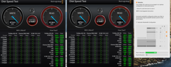

Update on testing. Sonnet 4x4 w/ 4 x 2TB Samsung 970 Evo Plus drives set-up in RAID 0 through Apple Disk Utility for 8TB total.
I tried the card/drives in two slots (slot 5- x16 and slot 6- x8) to see how much difference there was in speeds. Results attached - Left side is the x16 and right x8 slot results.
Also, I'm getting an "attention" message to move the card from 3 to slot 6. What does the Pool A Allocation (See screenshot) at 50% mean?? Is the "not arranged in an optimal configuration because the card is a x16 and I have it in a.x8 slot? Is there any possibility of disk error or other problem or is the machine just warning me that it will be slower?

The "Attention" msg you attached indicates to move the card from slot 6 to 4. Slot 6 is x8 and slot 4 is x16. This makes sense since the Sonnet card is a x16 card.
Pool Allocation information...

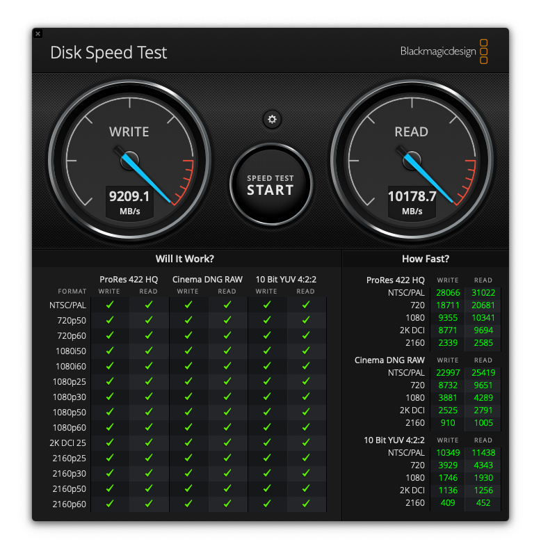

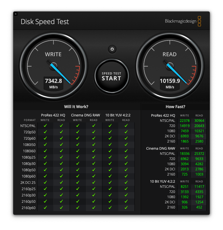

I have a Highpoint 7101 with 4 1TB Samsung 970 Pros. For creating a Raid 0 array using disk utility, what chunk size would be best for Photoshop/Lightroom use? Thanks for any input.
I bought the sonnet 4x4 with 3 wd sn750 2tb sticks and so far so good. I’ve used soft raid for ages but since OWC acquired them, they seem to have slowed down on their development on APFS support and encryption support. On 5.8.1 soft raid keeps trying to reinstall the boot driver every time I open softraid.
3x RAID 0 on soft raid on HFS+ gives 6900 write and 6500 read on blackmagics short benchmark. Disk utility raid 0 was slightly slower.
3x RAID 0 on APFS on disk utility since softraid doesn’t support APFS was 5900-6000 on both read and writes.
I require encryptionon every piece of storage and turning on encrypted APFS reduces performance to Around 3500 on read and writes.
