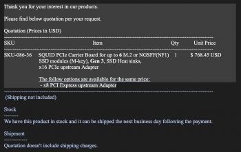

I have a quote request to Amfeltec, and will post back the quoted pricing. I'm sure it will not be cheap.
Amazingly, I received a quote from Amfeltec a few minutes ago....
