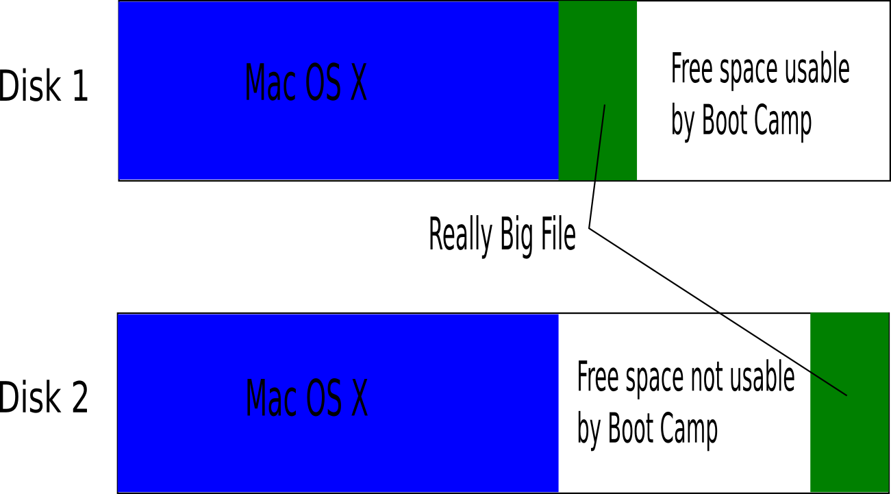

Look you guys, it's not very complicated.
If you have files near the end of a volume, you can't shrink the volume without leaving those files outside the volume. Diskutil, which resizes the volume, won't move those files closer to the beginning, no matter how much space you have left in your drive. If you guys want a picture, I'll make one later.
EDIT: Ok here's a picture that should clear things up. Also, it reveals why a volume doesn't actually HAVE to be very fragmented; just one misplaced file will do. Note how both drives have the same amount of space free, but one can have a large Boot Camp partition while the other can barely have any.
pretty much, easy fix. i just got iDefrag, used that to burn a bootable cd and then booted of that and defraged my hardrive. Problem solved.
p.s nice drawing 🙂
