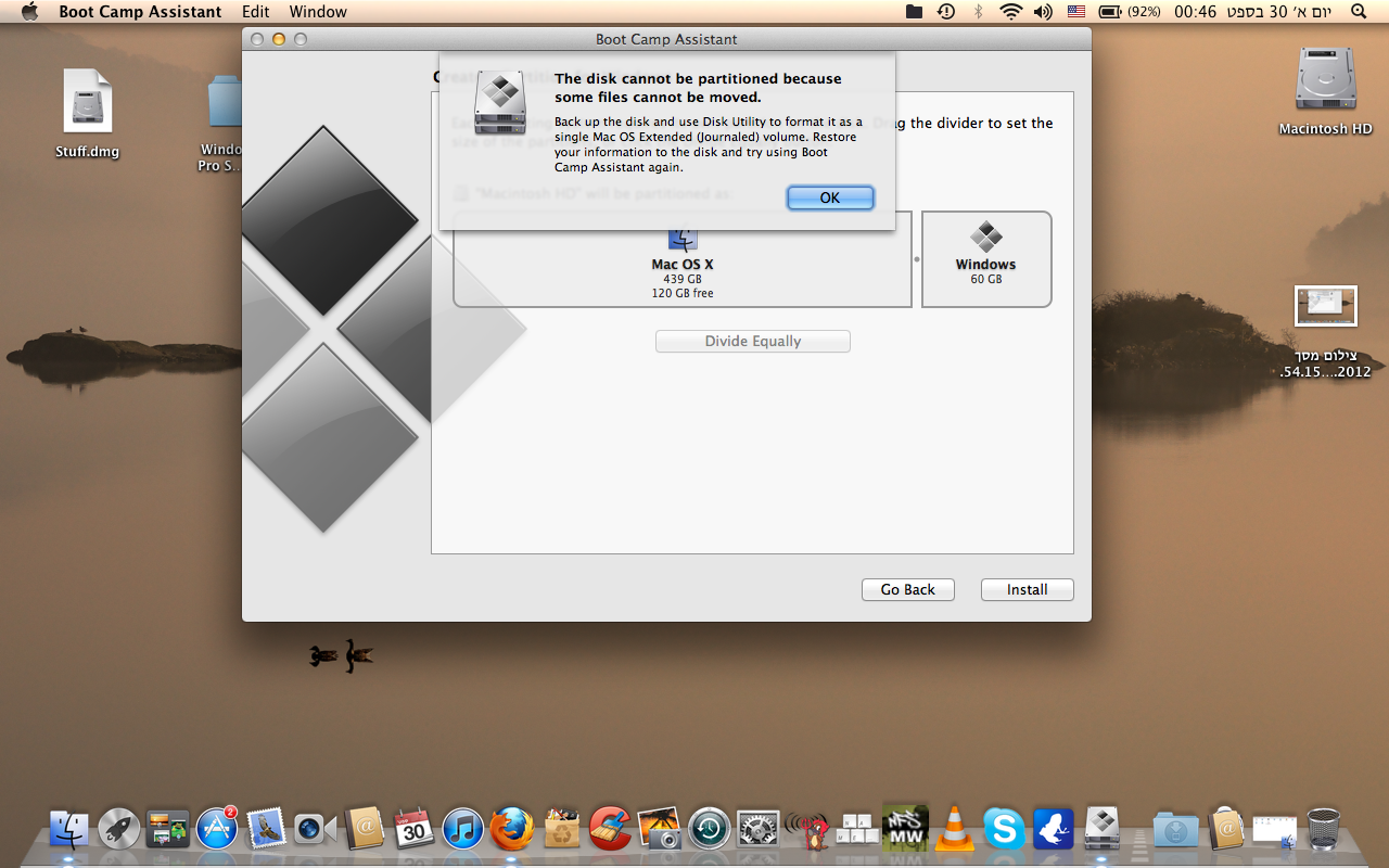

BootCamp problem
cant move files...(see the picture)
what should I do to solve that problem?
I want to install windows 7 ultimate in other partition on macbook pro 2011
thanks
thanks
Take a look at some of the posts above yours. This is far from uncommon.
B
