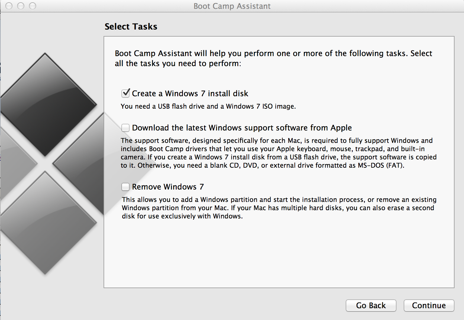

Bootcamp assistant will do it for you (see image).

I've been going round and round for the past 6 hours trying to do this myself. I've tried just about everything that I've seen on this forum. WRT the above - my bootcamp assistant does not have that as an option. It only has the last 2 options....

What Macbook are you trying to do this with? The only time that you don't have the option to create a USB disk from an ISO in Bootcamp Assistant is if you're trying to do with a Mac that has a superdrive.
