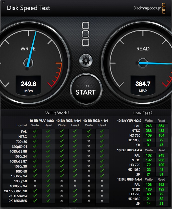

Just an FYI regarding booting my mid-2011 27" i7 from the new 256GB LaCie Rugged Thunderbolt SSD. In short, it works perfectly so far, and no surgery required (edit; 13 months - rock solid through may sleep cycles.). It wakes from sleep without issues. I cannot tell any real difference from an internal SSD. I use SuperDuper to mirror the SSD to the old HD boot partition once a week (in addition to TM and my other backups...). I'll report back periodically with updates.
I also enabled TRIM using Trim Enabler and a re-boot...
Blackmagic 1GB: W 250 MB/s R 378 MB/s (HDD ~90 and 95)
Boot Time to Login: 19.4s (was 90.1s with HDD)
Lightroom 4.2: 4.1s (was 14.7s)
Parallels XP Boot: 9.4s (was 45.8s)
iPhoto: 4.7s (was 14.7s)
Photoshop Load: 5.3s (was 12.7s)

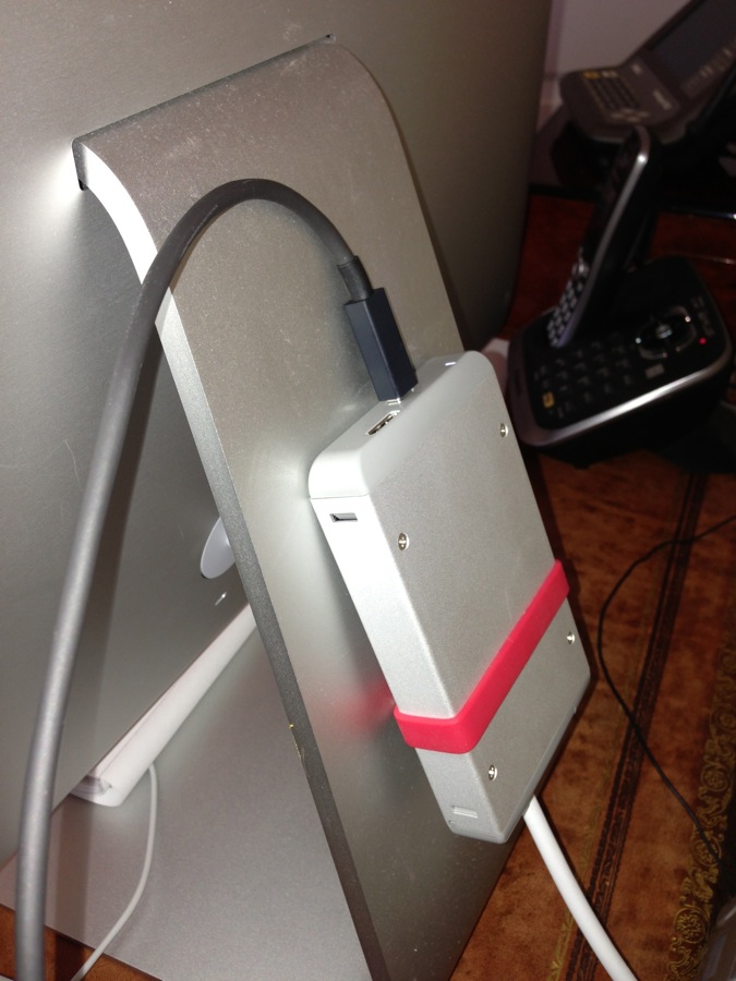

While not as fast as a best in class internal 6GB SATA3 SSD, it's certainly an easy way to move to an SSD environment. I just rubber banded the drive to the back of my iMac after removing the orange bumper. No power required.
This is a cheaper and more compact external 256GB option than the GoFlex STAE122 + SSD + cable combo (~$420). The LaCie is $349 including the TB and USB3 cables.
I did not know you could remove that ugly orange case around it. That looks much better without it. But seriously, get a Twelve South backpack for a more proper hard drive mount on the back 🙂

Just an FYI regarding booting my mid-2011 27" i7 from the new 256GB LaCie Rugged Thunderbolt SSD. In short, it works perfectly so far, and no surgery required (edit; 3 weeks - rock solid through may sleep cycles...). It wakes from sleep without issues. I'll report back periodically with updates.
If stable, this is a cheaper and more compact external 256GB option than the GoFlex STAE122 + SSD + cable combo (~$420). The LaCie is $349 including the TB and USB3 cables.

The Elgato is slow, that Lacie looks the goods going off that blackmagic screenshot. The write is about the same as my 2011 MBA and the read is much faster. Not bad for an external solution!

The read speed is quite a bit faster than the read on my 2011 11" MBA.
Don't forget that this benchmark only looks at sequential write and read and not the random read and write, which are very important factors to determine how well the SSD will actually perform.
