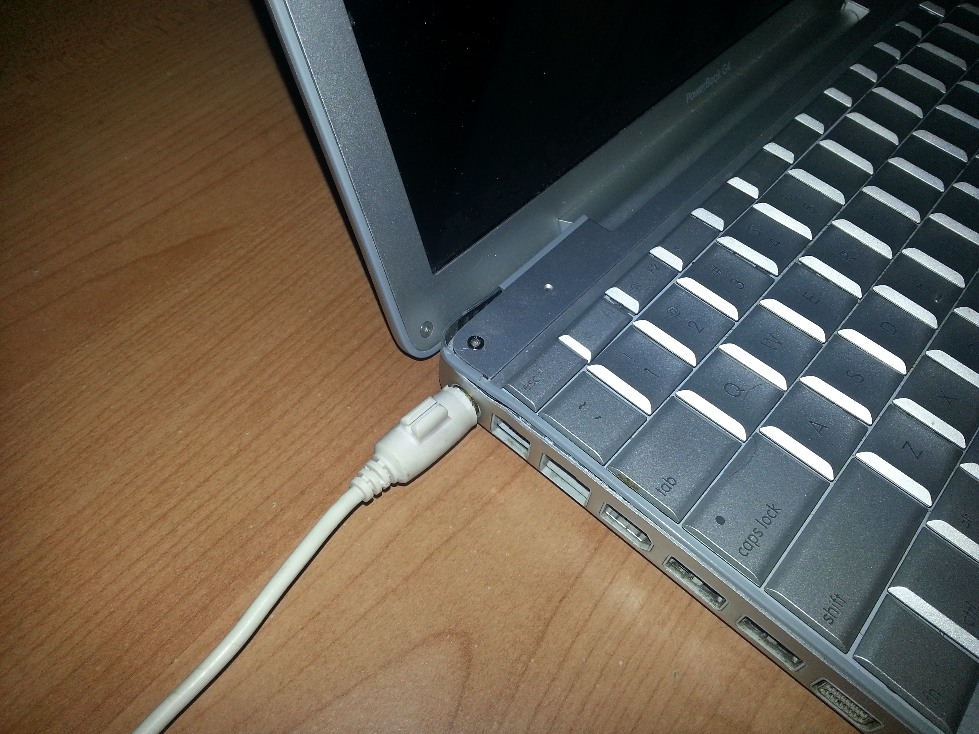

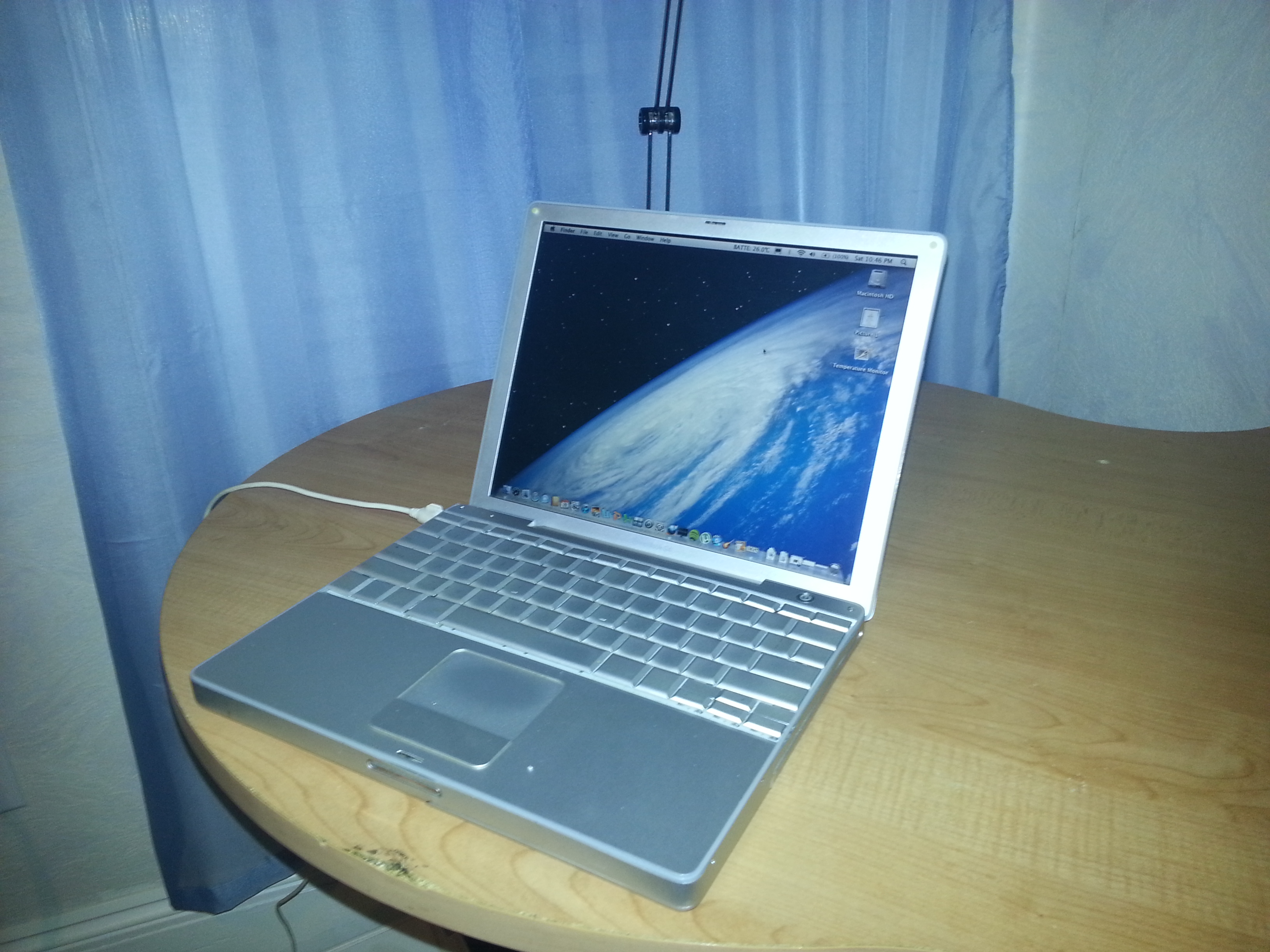

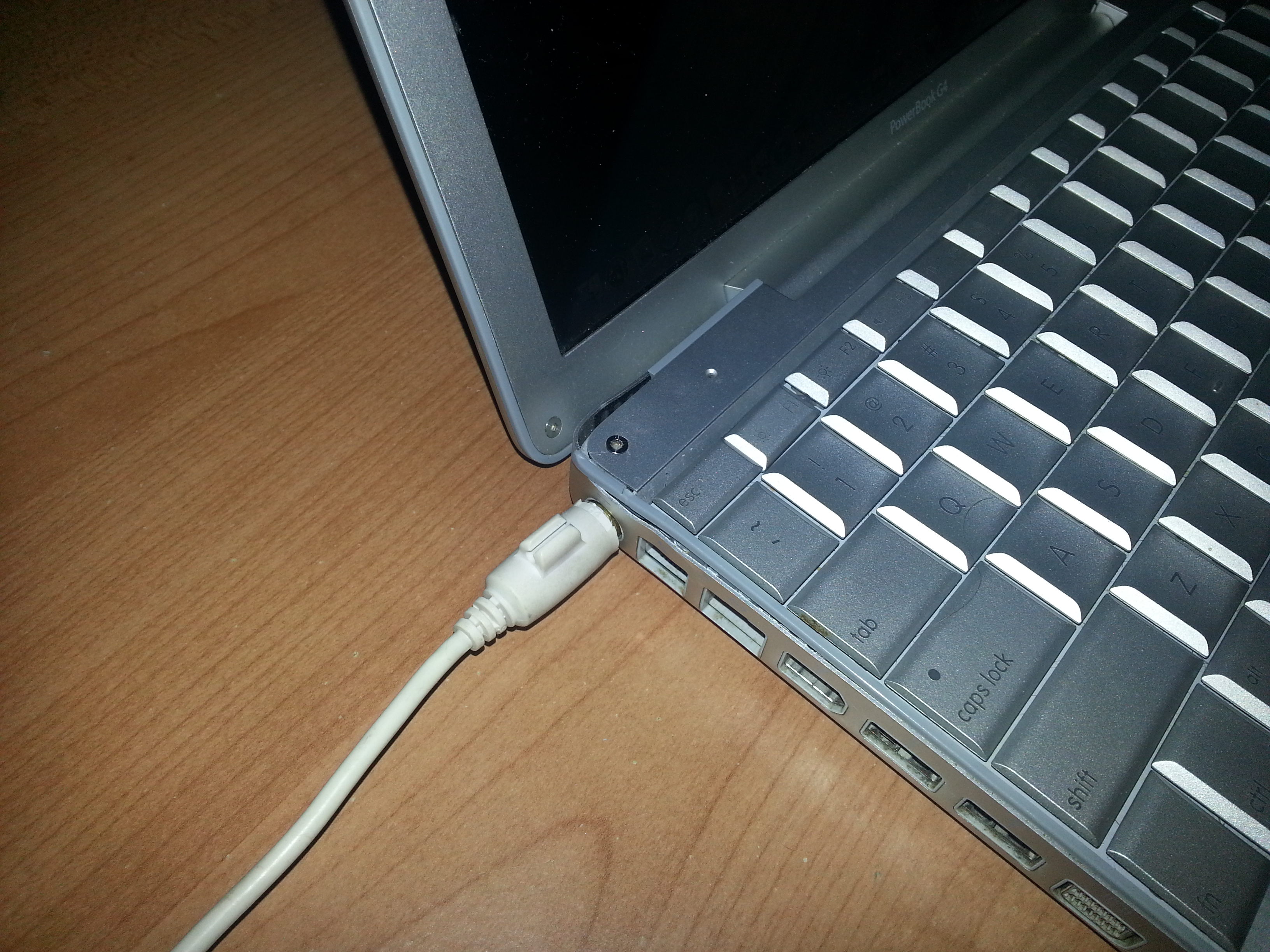

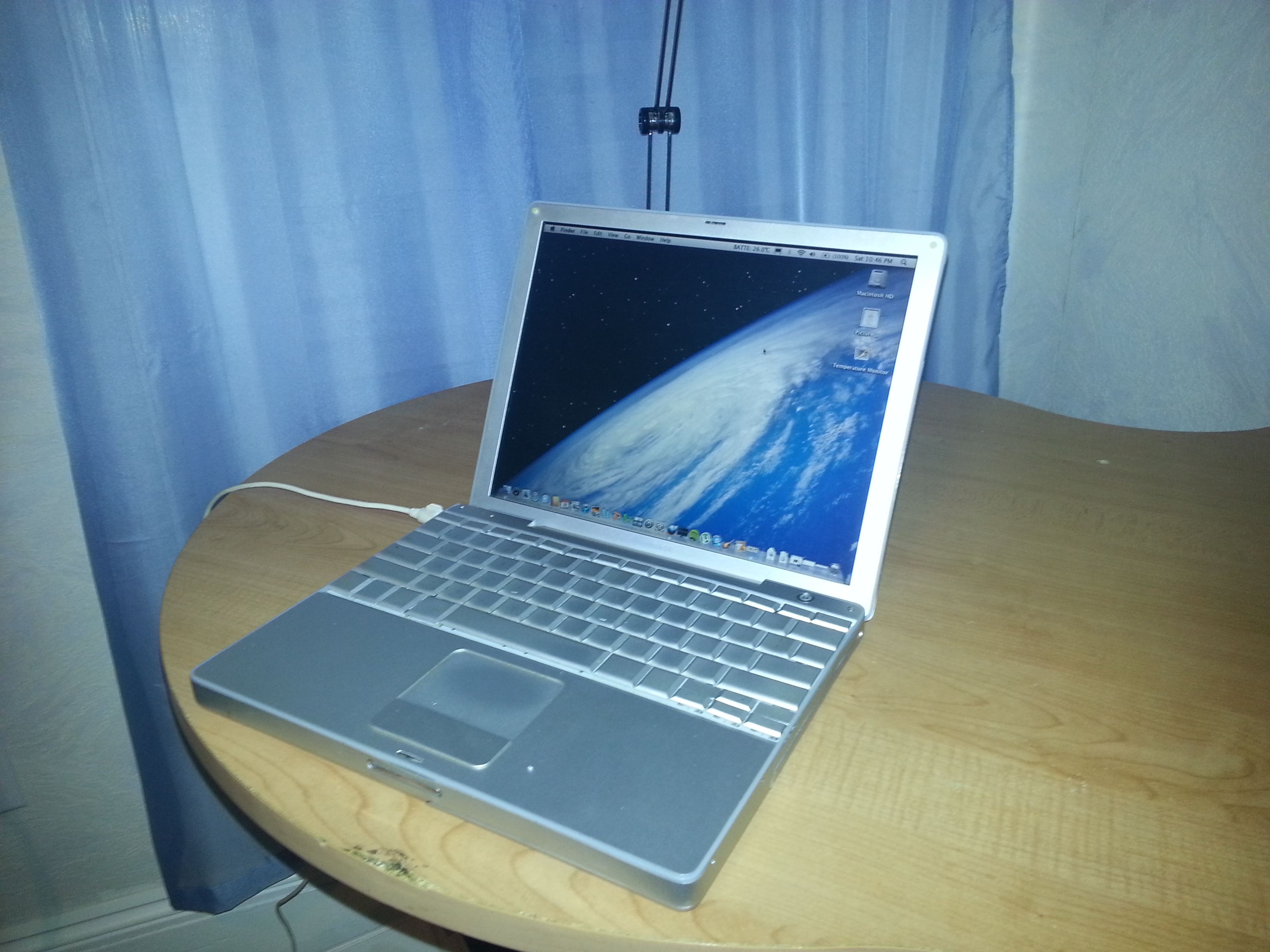

Attached some finalized pics for you guys. In the second one you can see the initial damage from the fall. A piece of the plastic finishing broke off and the bottom half is deformed.
Also, I used a latch for the broken F12 key from my old keyboard (didn't fit), so the key is positioned oddly. At least it works.
Thanks for the advice and help guys!

Awesome! Glad it's working! The second pic explains a lot about the DC-In board. Usually a fall like that happens when the Mac is plugged in. Guess which part hits the ground first?
The plug hitting the ground or object first flexes the connector on the DC-In board which weakens/breaks the solder. So, now you have a loose connection. But you fixed that so you're good.

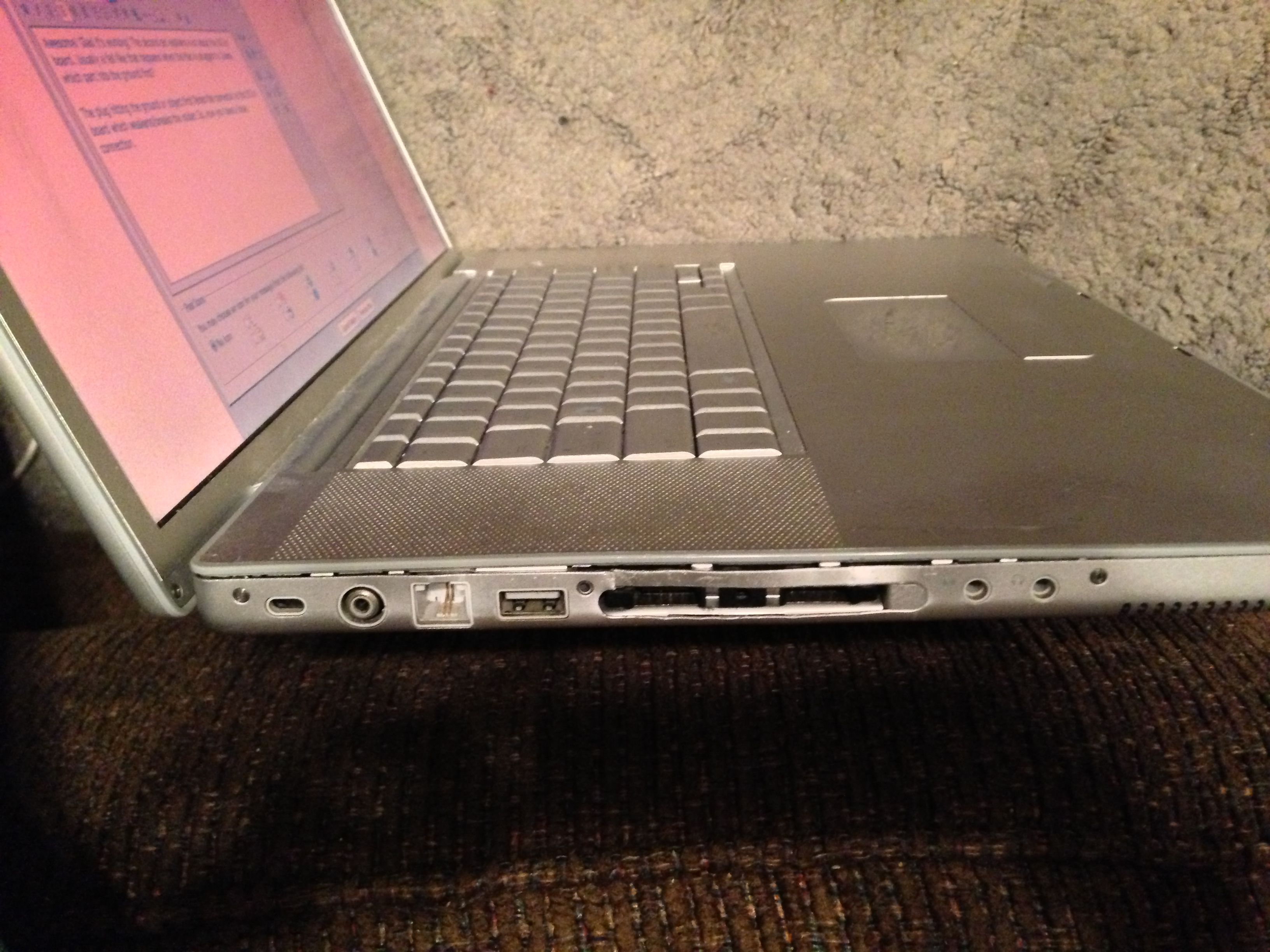

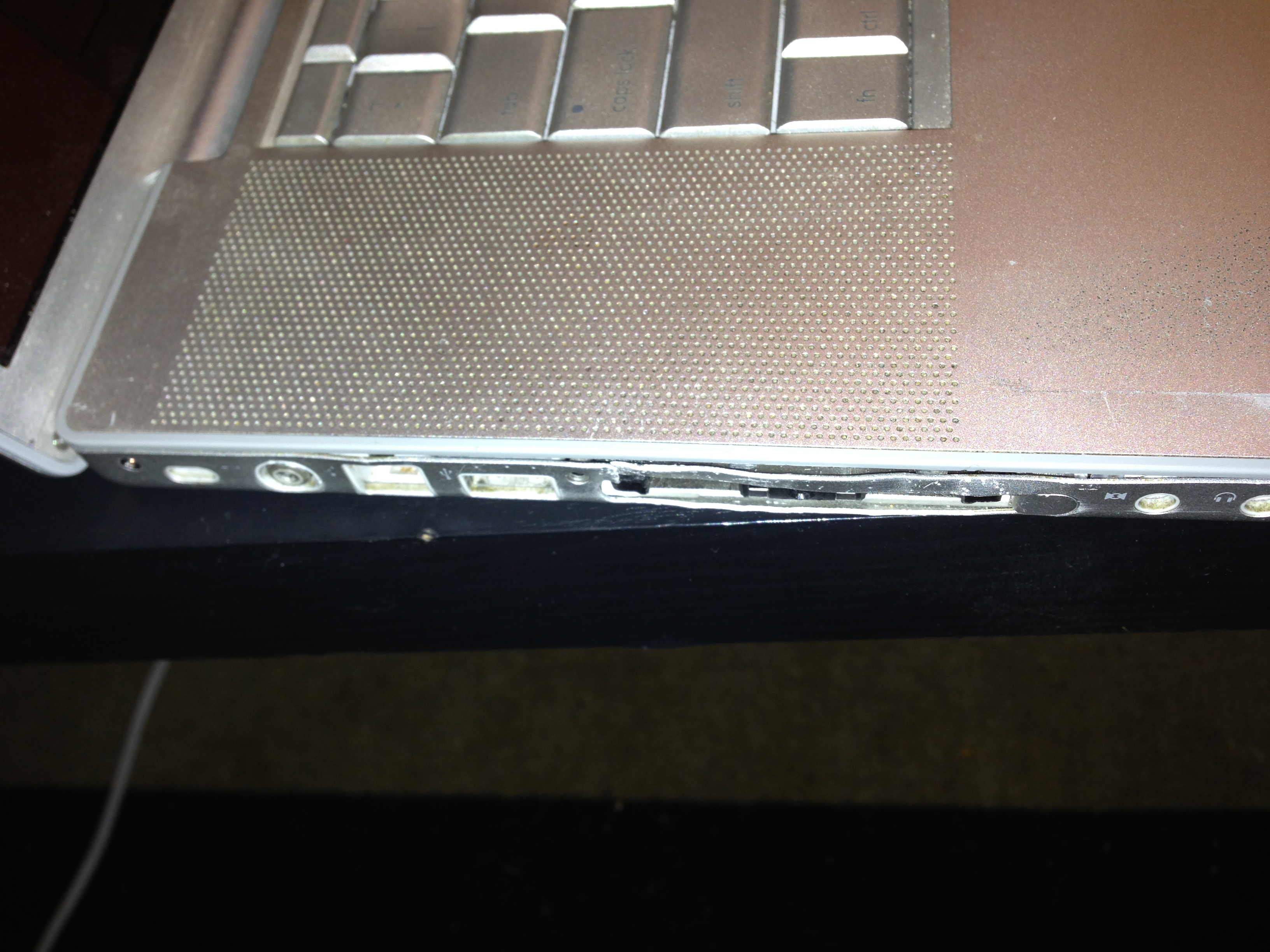

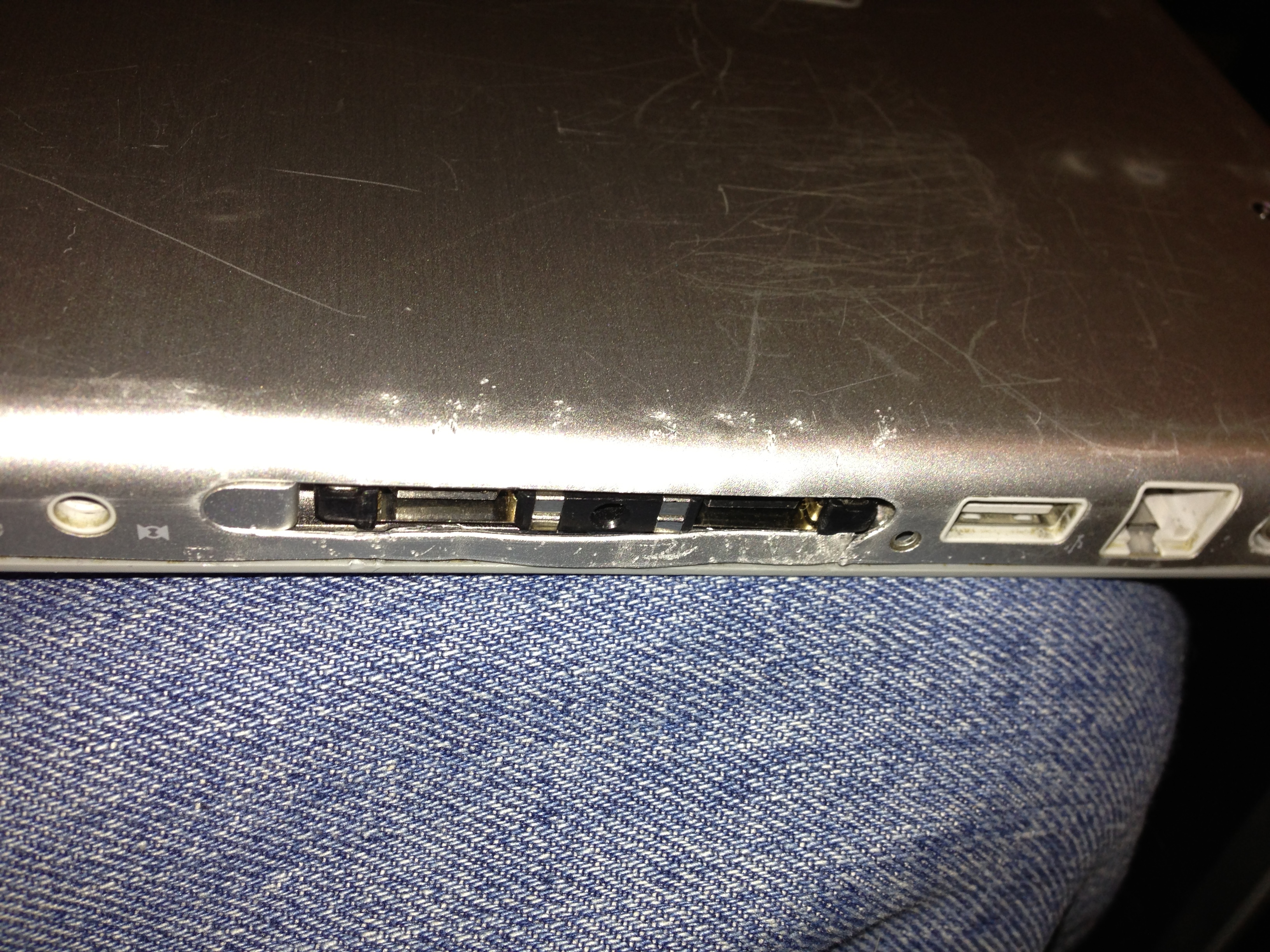

Here's some pics of the left side of my 17" PowerBook. The original owner somehow dropped it in such a way that the card slot area got bent in (bottom case). One of the screw holes in that area is stripped out because of this so I've always had a small gap in the left side and the top case towards the LCD screen. A while back I purchased a USB 2.0 PC card and stuck it in. Stupidly I tried to pull it out. Since the bottom case was bent in I ended up mangling the top case part over the slot in order to get the card out. That's the damage you see on the left side. I managed to get most of it bent back inward, but it's aluminum so of course it's now stretched out of shape. At least the gap isn't so bad anymore though.

The aluminum Powerbooks are very high quality, but the aluminum bends so easily, ruining an otherwise great product.

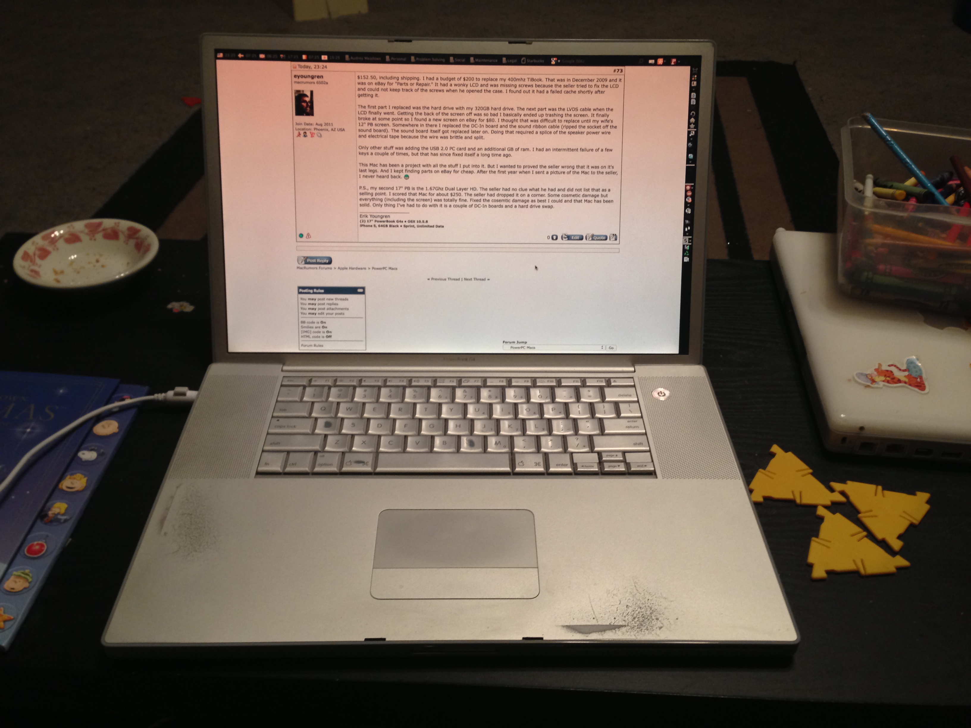

Here's a pic of the Mac you asked about. The scratches and finish issue came with the Mac. I have no idea what the seller did here.
Oh, since it's in the picture. The Mac on the right is a iBook G3 Dual USB. My daughter's Mac (she's 4).
