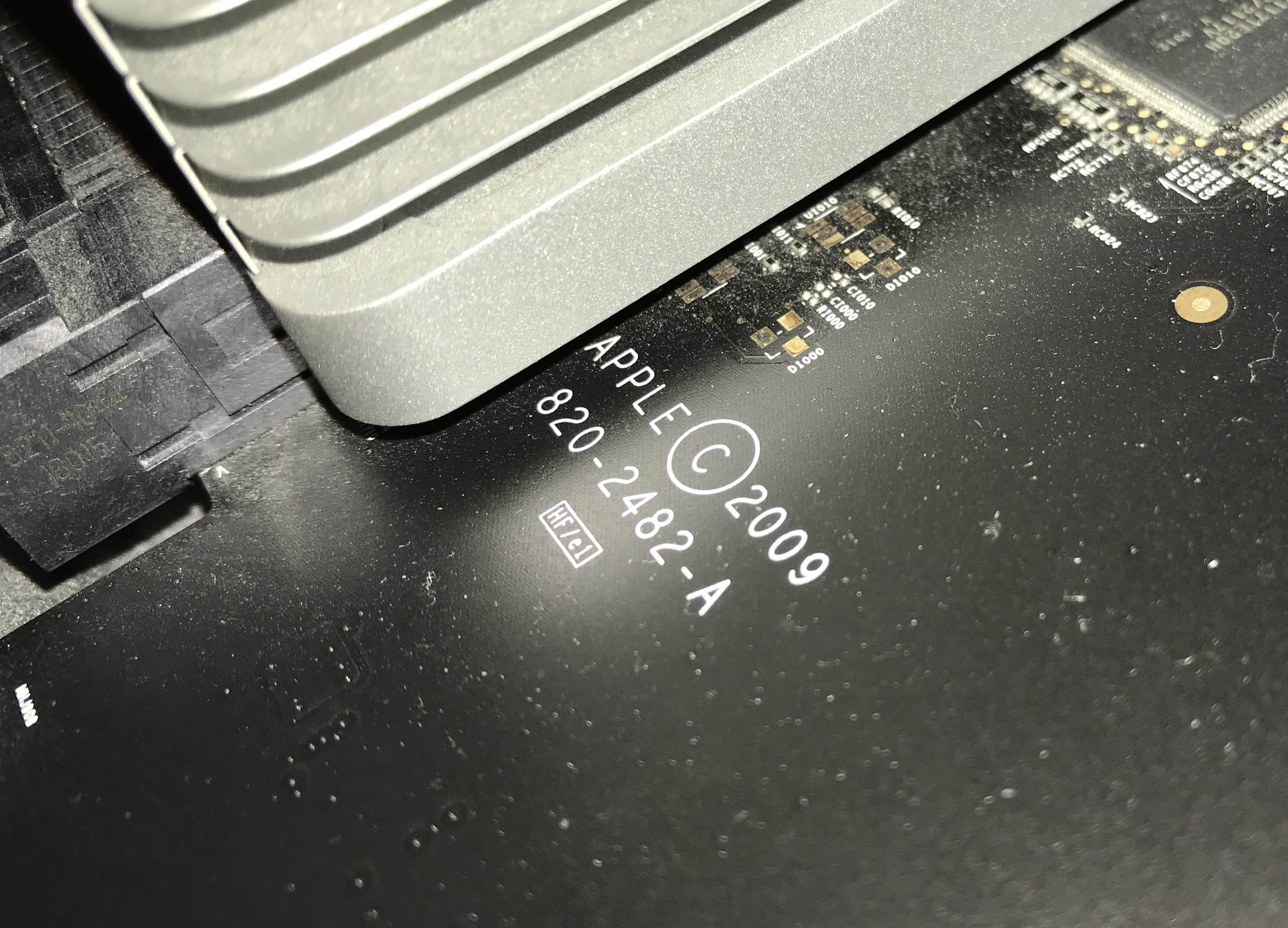

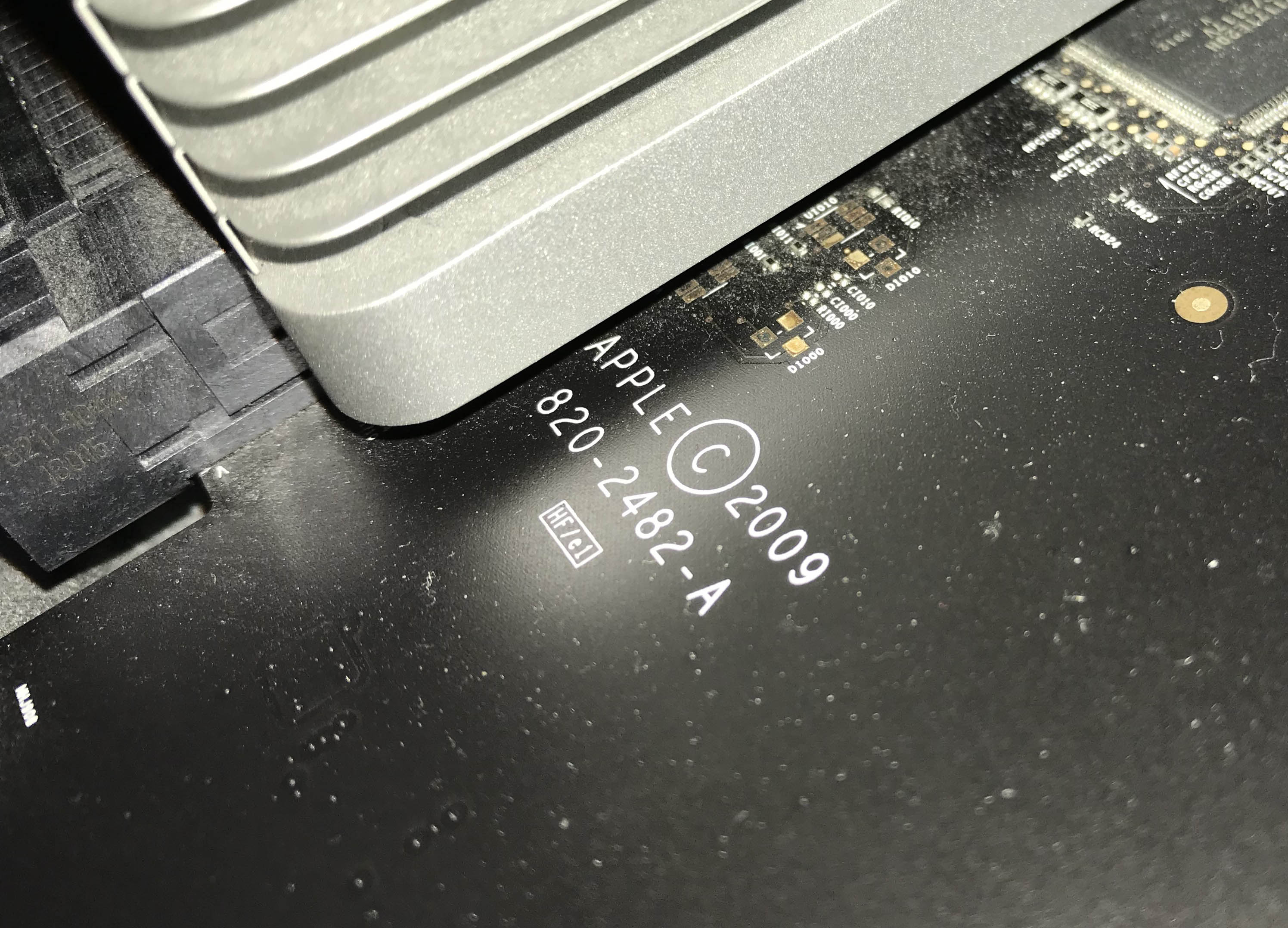

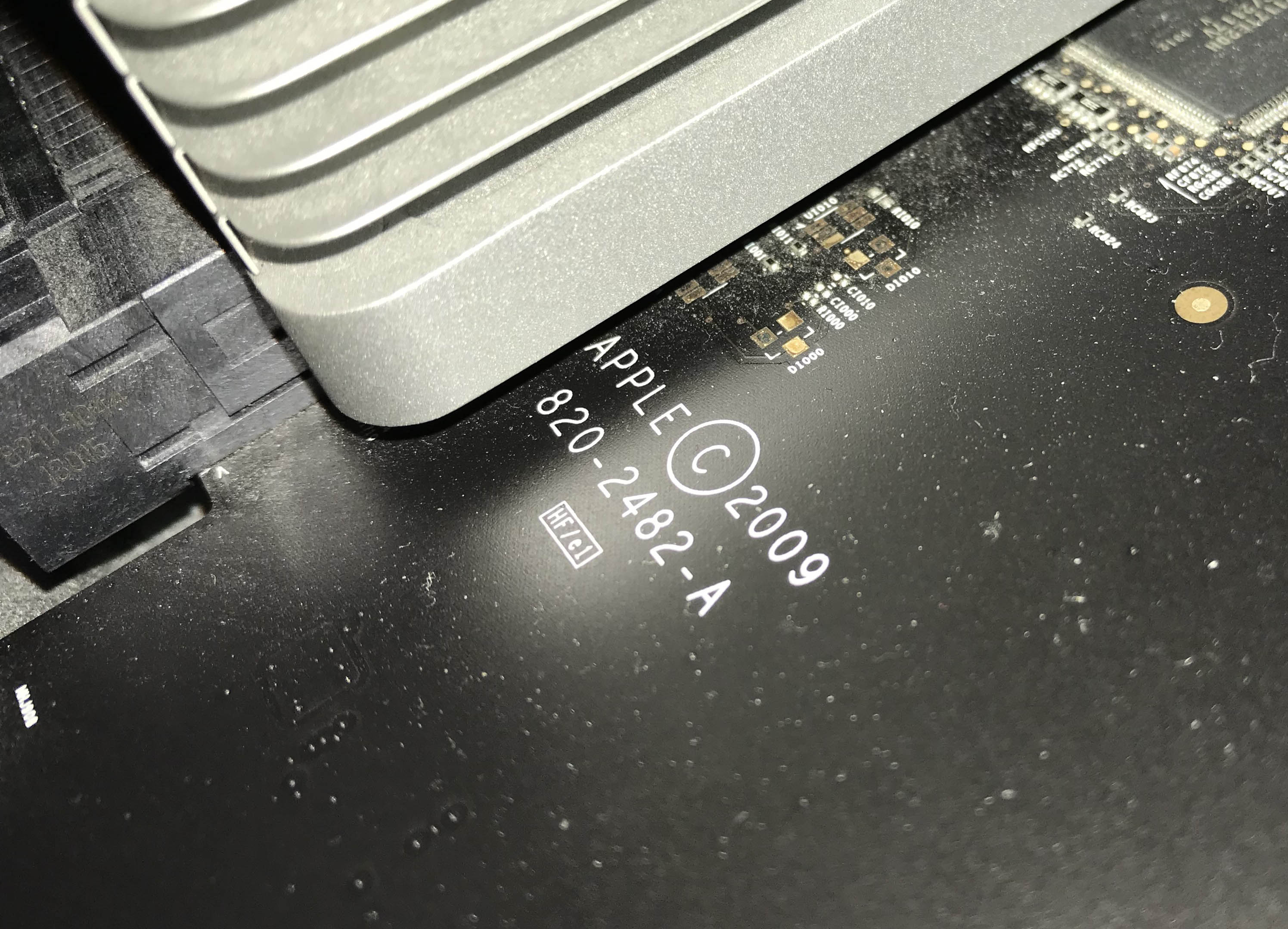

In case this is at all helpful, attached is a photo that was just taken from an authentic 5,1 mid-2012 Mac Pro with single processor. CPU board was pulled this morning to replace with a dual-processor board. You can see the part number 820-2482-A and (C) 2009. This particular machine was purchased in May 2013.

My Early 2009 Mac Pro has this identical printing on the CPU tray (a replacement part from Apple in Jul 2015). I really doubt if it’s possible to know a tray is for 4,1 by its appearance now.
The dual CPU tray on the 2009 uses lidless processors and the 2010/2012 uses lidded processors. Even if the PCB is the same, shouldn't there be a noticeable physical difference for the CPU clamping hardware?
That is correct. The issue does not come apparent when one is purchasing a 2nd hand/used tray. Without "opening it up" one will not know.
But this thread is about single processor tray. So, I really don't know how can tell this difference (if the printing, part number, etc may be shared use between 4,1 / 5,1 tray).
