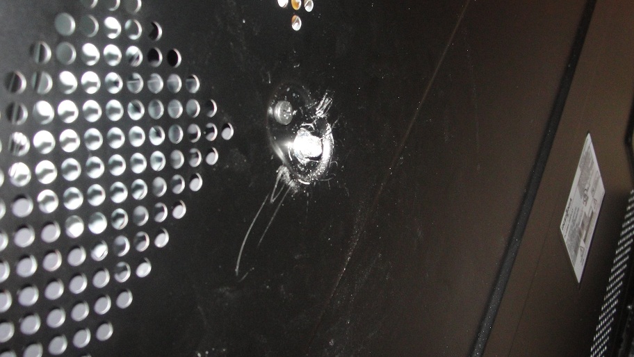

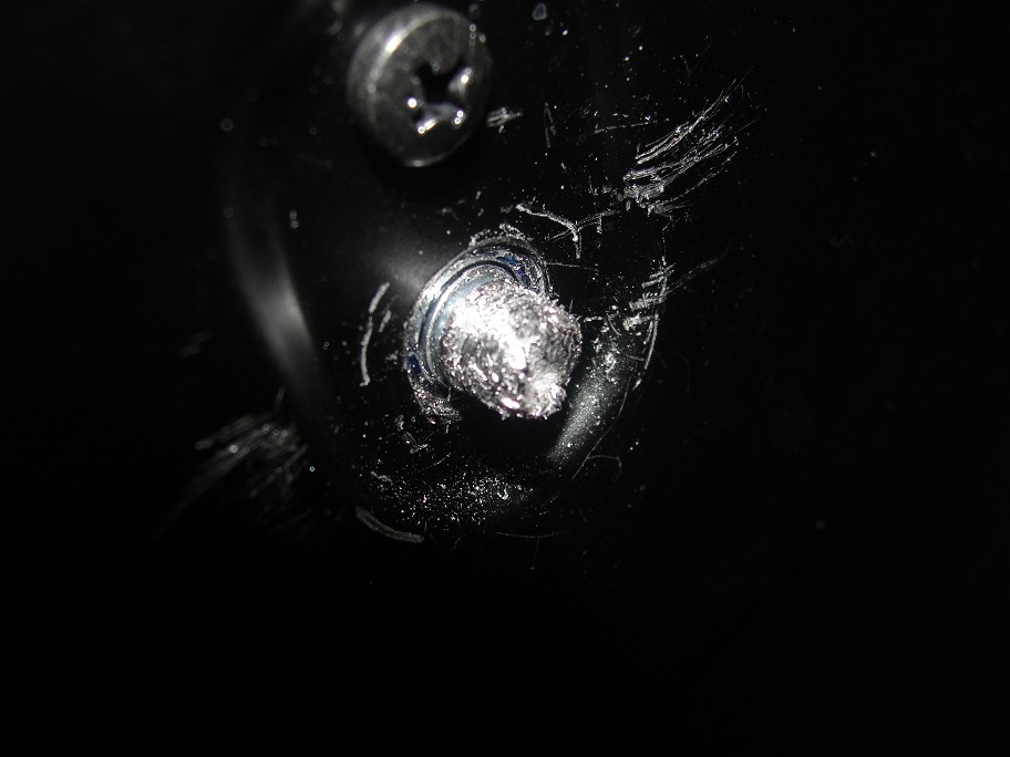

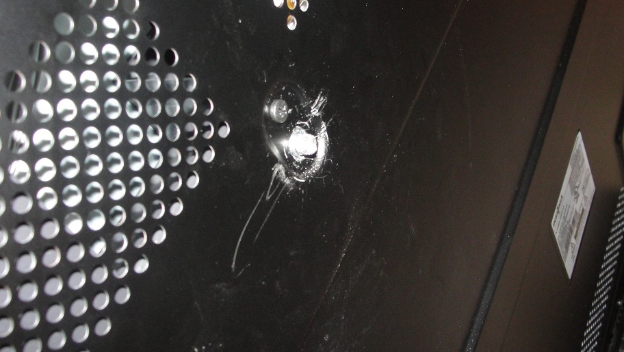

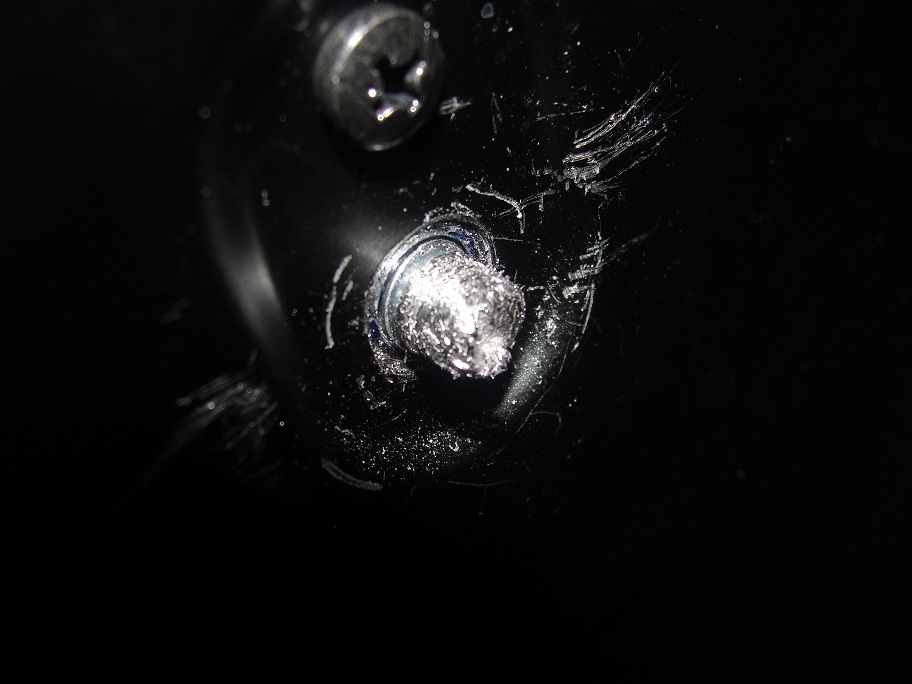

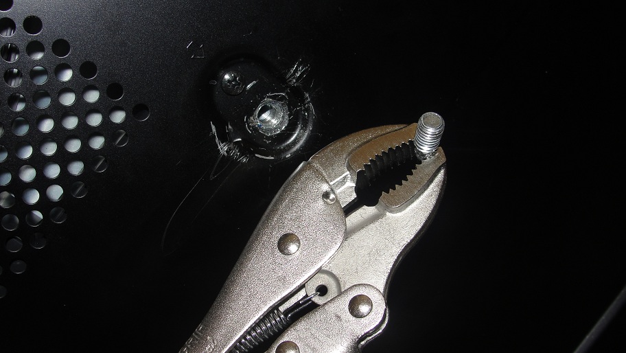

    Tonight I bough a new 50 inch TV. My current wall mount screws were not big enough so I drove to walmart after getting home to get some bigger machine screws... go home, still werent big enough. Left again, came back and this time they seemed to be going in but really, really tight. I thought that was just how it was supposed to be but then it got to a point where I figured I needed smaller. (the 1/4 was too small but the 5/16 was too big... Whats in between?!) As I was taking the screw out it broke! I CANNOT get this thing out, as you can tell, I have already scratched the back up.. HOW CAN I GET THIS OUT :(

    It is sad that the metric part never clicked.
    Simple rule. If it is a imported item in to the US it will be metric bolts. Hell even many american parts are metric.'
    If it is a domestic company then it is hit or miss if it is metric or standard. Hell do not be surprised if you see both on different parts of the same product. Annoying as well when you are working on something.
    As for OP. Cances are pretty good that you are screwed. The bolt is more than likely cross threaded and has ruined the treads on the TV. All you can do is get one of those tools that will enlarge and retread the hole assuming you can even get out the old bolt.

    plyers, small pipe wrenches might work too if you have it worn down where theres nothing to grip anymore.

    Once they have removed the broken screw there's a good chance that running the correct size tap down the hole will at least make the thread usable again with the correct size screw. If it's a little bit loose you can use some threadlock to hold the screw in place.
    If you find the thread is too damaged to use, find a local engineering workshop and ask about Helicoil thread repairs.

    You may want to try cooling the bolt (somehow) so it contracts a little and it should make it easier to screw back out with some plyers.

    Drill a hole through the screw (preferably from one side to the other, if not as deep as you can go) then slip a hex key (or suitably sized piece of metal rod) though/into the hole and simply unscrew using the hex key as a handle (the Hex key will bend, but the screw will come out).

    It wouldn't work in this case, molegrips and brute force is the answer.

    By just looking at the back of your tv, I think you may require help from someone with a bit more practical experience. I don't want to sound like I am being ass but man you need help. Do you know anyone with a good tool kit and handheld vice grips because it looks like you are past the frustration point with it. Good luck and hope it work out for you in the end.

    From your photo you seem to have enough of the screw protruding to take a hacksaw and saw a cut through the middle of the screw. This will create a new head to insert a normal minus screw driver and extract the screw (slowly). Good luck.

    The only problem with that is you would need to drill a ø4mm hole down the middle of the knackered thread to use a No.3 extractor.
    We've seen the carnage the OP has caused armed with just a screwdriver. :eek:

    The suggestions about vice grips or using a hacksaw to cut a flat headed screwdriver notch are probably your easiest home remedies at this point. Might I suggest getting someone to help. Cover the TV with towels or something to help prevent any other damage and have someone hold it securely while the other person works to retrieve the busted screw/bolt.

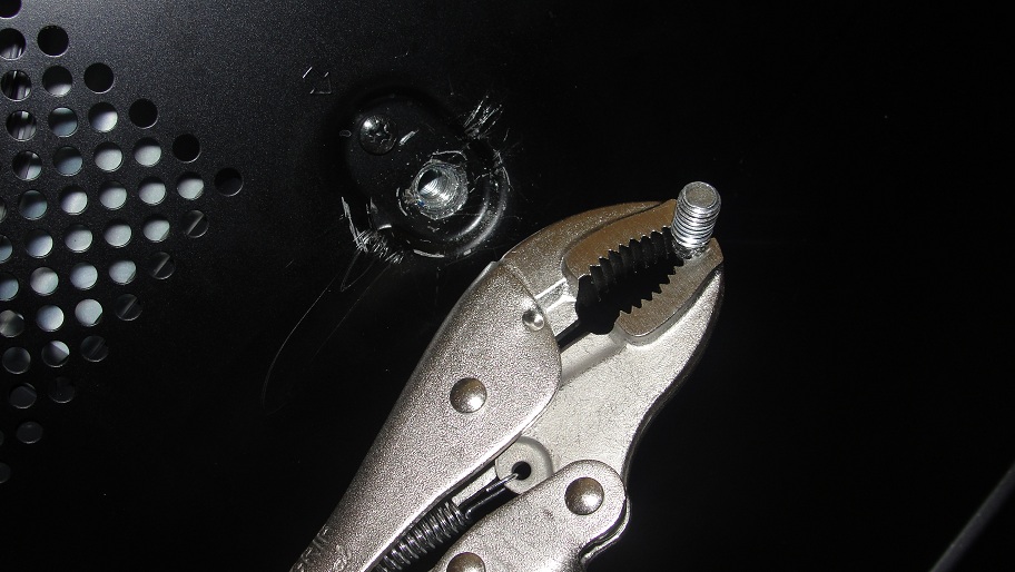

    iMJustAGuy, do you have a can of compressed air? Blast it at that thing [closely, but mind your fingers] and get it good and cold before you try getting it out, however you decide to try to get it out.

    If I lived In Cali I would come kiss you right now... on the lips! :eek:
    WOOHOO!
    :D:D:D:D:D:D:D
    (FOR THE RECORD: The guy at home depot told me that this would not work [I showed him a pic] and that it would probably only break it off more)

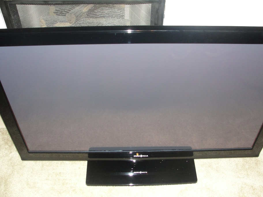

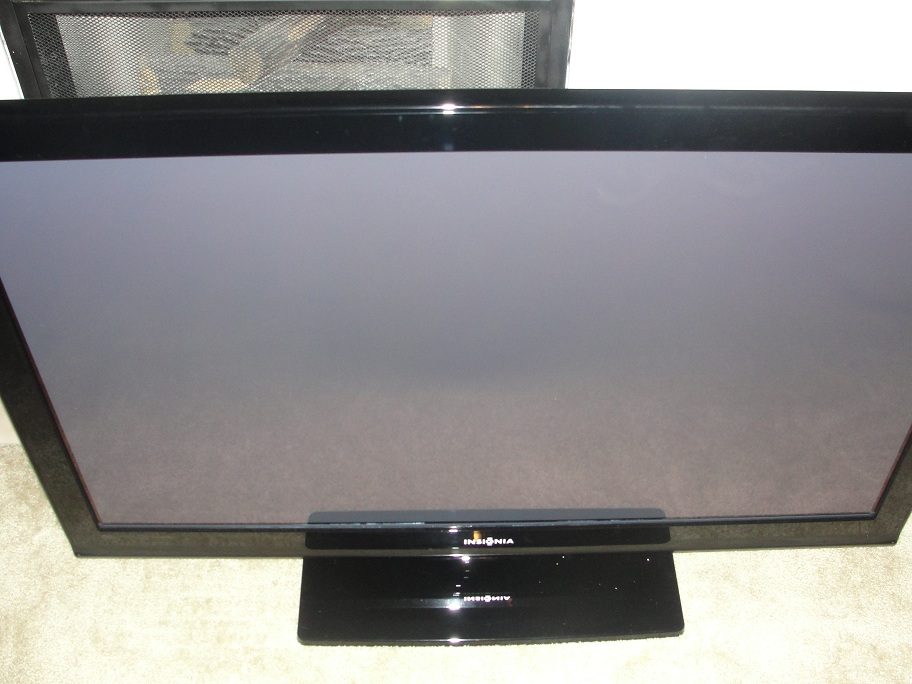

    My baby took a beating but it worked. THANK EVERYBODY! You guys are the best. If I ever get on who wants to be a millionaire MacRumors will be my phone a friend!
    Its funny because the outside is so jacked up and then when you take it out it looks as if nothing has happened from the inside... So one more thing... (hehe)

    If it says M8 then that is what you need. M8 is more or less the same diameter as 5/16 but the thread has a different pitch. This is why the 5/16 screw snapped when you tried to tighten it up.
