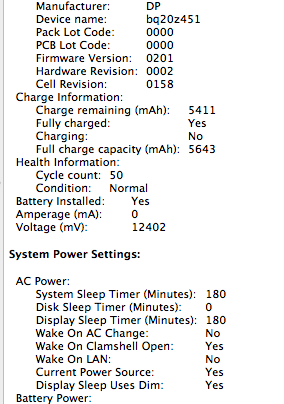

What does yours say in System Profiler for maximum charge capacity? Mine say 6644 mAh.
Interesting.. I have a new MBP and I only see 5643 mAh on mine :eek:
Which MBP do you have? If it is the 13" or 15", that sounds about right, the 17" has around 12759mAh.
Addendum: The battery in the 13" and 15" MBP is not as big as the battery in the current 13" MBA, as far as I have gathered via tear downs.
Addendum: The batter in the 13" and 15" MBP is not as big as the battery in the current 13" MBA, as far as I have gathered via tear downs.
13"
I wonder how that is as according to Apple the battery in the MBP is bigger than the one in the new MBA according to their tech specs.
The conventional wisdom seems to be that the 13 inch MBP's 10 hours of battery life, compared to the MBA's 7 hours, and the MBP's weight of 4.5 pounds, compared to the MBA's 2.9, is attributable to the 13 inch MBP's battery being larger and heavier. Is this not right?
According to the specs on the Apple site the MBP has a bigger battery than the MBA one does (13" versions being talked about )
