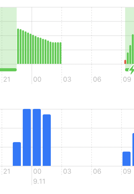

the brand new macbook air m1 came to me yesterday evening and around 1:30 a.m I've put it into sleep mode with 40% battery.
Today morning (after ~8h) I wanted to turn on my mac and battery was discharged - I had to plug charger to turn it on (and then mac showed me 10% - so why it was completly dead?)
Can someone help me? In battery preferences it looks like that:
Why it show this huge gap between 3 (I used it till 1:30 and later I think mac was awake because of some settings/bugs?) and 9?
logs from terminal:
Code:
2022-11-09 01:51:29 +0100 DarkWake                DarkWake from Deep Idle [CDNP] : due to SMC.OutboxNotEmpty smc.70070000 wifibt wlan/ Using BATT (Charge:40%) 5 secs
2022-11-09 01:52:03 +0100 DarkWake                DarkWake from Deep Idle [CDNP] : due to SMC.OutboxNotEmpty smc.70070000 wifibt wlan/ Using BATT (Charge:40%) 5 secs
2022-11-09 01:52:13 +0100 DarkWake                DarkWake from Deep Idle [CDNP] : due to SMC.OutboxNotEmpty smc.70070000 wifibt wlan/ Using BATT (Charge:39%) 6 secs
2022-11-09 01:52:35 +0100 DarkWake                DarkWake from Deep Idle [CDNP] : due to SMC.OutboxNotEmpty smc.70070000 wifibt wlan/ Using BATT (Charge:39%) 5 secs
2022-11-09 01:53:19 +0100 DarkWake                DarkWake from Deep Idle [CDNP] : due to SMC.OutboxNotEmpty smc.70070000 wifibt wlan/ Using BATT (Charge:39%) 5 secs
2022-11-09 01:54:37 +0100 DarkWake                DarkWake from Deep Idle [CDNP] : due to SMC.OutboxNotEmpty smc.70070000 wifibt wlan/ Using BATT (Charge:39%) 7 secs
2022-11-09 01:55:47 +0100 DarkWake                DarkWake from Deep Idle [CDNP] : due to SMC.OutboxNotEmpty smc.70070000 wifibt wlan/ Using BATT (Charge:39%) 6 secs
2022-11-09 02:13:20 +0100 DarkWake                DarkWake from Deep Idle [CDNP] : due to SMC.OutboxNotEmpty smc.70070000 wifibt wlan/ Using BATT (Charge:39%) 5 secs
2022-11-09 02:13:28 +0100 DarkWake                DarkWake from Deep Idle [CDNP] : due to SMC.OutboxNotEmpty smc.70070000 wifibt wlan/ Using BATT (Charge:38%) 5 secs
2022-11-09 02:16:24 +0100 DarkWake                DarkWake from Deep Idle [CDNP] : due to SMC.OutboxNotEmpty smc.70070000 wifibt wlan/ Using BATT (Charge:38%) 5 secs
2022-11-09 02:17:52 +0100 DarkWake                DarkWake from Deep Idle [CDNP] : due to SMC.OutboxNotEmpty smc.70070000 wifibt wlan/ Using BATT (Charge:38%) 5 secs
2022-11-09 02:34:50 +0100 DarkWake                DarkWake from Deep Idle [CDNP] : due to NUB.SPMI0Sw3IRQ nub-spmi.0x02 rtc/SleepService Using BATT (Charge:38%) 4 secs
2022-11-09 02:35:05 +0100 DarkWake                DarkWake from Deep Idle [CDNP] : due to SMC.OutboxNotEmpty smc.70070000 wifibt wlan/ Using BATT (Charge:38%) 6 secs
2022-11-09 02:50:51 +0100 DarkWake                DarkWake from Deep Idle [CDNP] : due to NUB.SPMI0Sw3IRQ nub-spmi.0x02 rtc/SleepService Using BATT (Charge:38%) 3 secs
2022-11-09 09:23:35 +0100 Wake                    Wake from Hibernate [CDNVA] : due to trackpadkeyboard/Notification Using AC (Charge:10%) 380 secs
