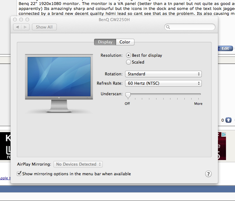

Just bought the new Mac Mini (with the latest ivy bridge and 4gb ram as standard) and connected it to a brand new Benq 22" 1920x1080 monitor. The monitor is a VA panel (better than a tn panel but not quite as good as an ips panel apparently) Its amazingly sharp and colourful but the icons in the dock and some of the text look jagged. Im connected by a brand new decent quality hdmi lead so cant see that as the problem. Its also causing me terrible eye strain and i have the monitor set at 20% brightness?
Any ideas?
Matt
Doesnt give me the option for 1920x1080 , just 1080p which is the same. By default its set to best for monitor but if i click scaled it is already on 1080p...
Something i forgot to add , ive noticed a few times the screen will go black for literally 1 or 2 seconds and then back on as normal. Cant be a power saving issue as I've set both sleep and monitor sleep to off. Wonder if i have a faulty graphics chip inside my mac mini?

I got rid of the text jaggies with my new Mac mini hooked up via HDMI to my older Sharp LC-32SH12U TV by turning down the sharpness on the TV (from the default of "25" to "5"). I guess the sharpness makes it TOO sharp, showing the text smoothing tricks (gray around white text, for example) too literally.

Thanks for that. Ive just checked and the monitor was on 5 out of 5 for sharpness. Ive turned it down to 1 and most of the jaggies has gone as when i turned the sharpness down the text went from light grey to black which stands out more now.

I just got my new Mac Mini base today and had a problem with the screen at first too. The picture was a bit blurry and text wasn't pretty or easy on the eyes. This was when I connected my screen with HDMI - HDMI. The problem turned out to be that the HDMI forces you to use 1080p screen resolution, not 1920x1080. I don't even know if there's a difference, but when I connected with a DVI cable using the adapter that came with the mini the problem was solved. Now the resolution is 1920x1080 and the picture is perfect. I think it's worth a try for the OP.

First of all HDMI does not force you to use 1080p. If anything, it's the OS that's forcing it to 1080p. I have my Win7 PC hooked up to a 55" Samsung LED display and it looks fantastic and reports 1920x1080 as the input resolution.

After a quick glance at AVS forums there seems to be another solution if your TV or monitor has the right settings. Set the TV or monitor to PC mode and turn 1:1 pixel mapping on, this will force the TV to tell your Mac that's it's a true monitor not a a television set.

I'm trying to fix similar problems and I read on another thread that you can get a 1920x1080 using "SwitchResX" on your mac. That way you can continue to use the HDMI. I'm going to try it when I get home from work.

Yeah, what I meant was that the OS won't let you change to 1920x1080 on HDMI.
I also found some discussions about that. However I chose to use the DVI cable I had from my previous computer just lying around. I have speakers connected to audio out so I don't need HDMI for the sound.

I have a regular DVI - DVI cable. My screen has VGA, HDMI and DVI ports, so I can choose what ever I want. The setup that didn't work for me (without some application to alter the resolution) was a regular HDMI - HDMI cable.
As you have no option other than using HDMI on your screen, I guess that any adapter/cable tricks won't help. I would try using that basic HDMI cable and try an app like "SwitchResX" that someone here recommended. I didn't even bother to try it.
