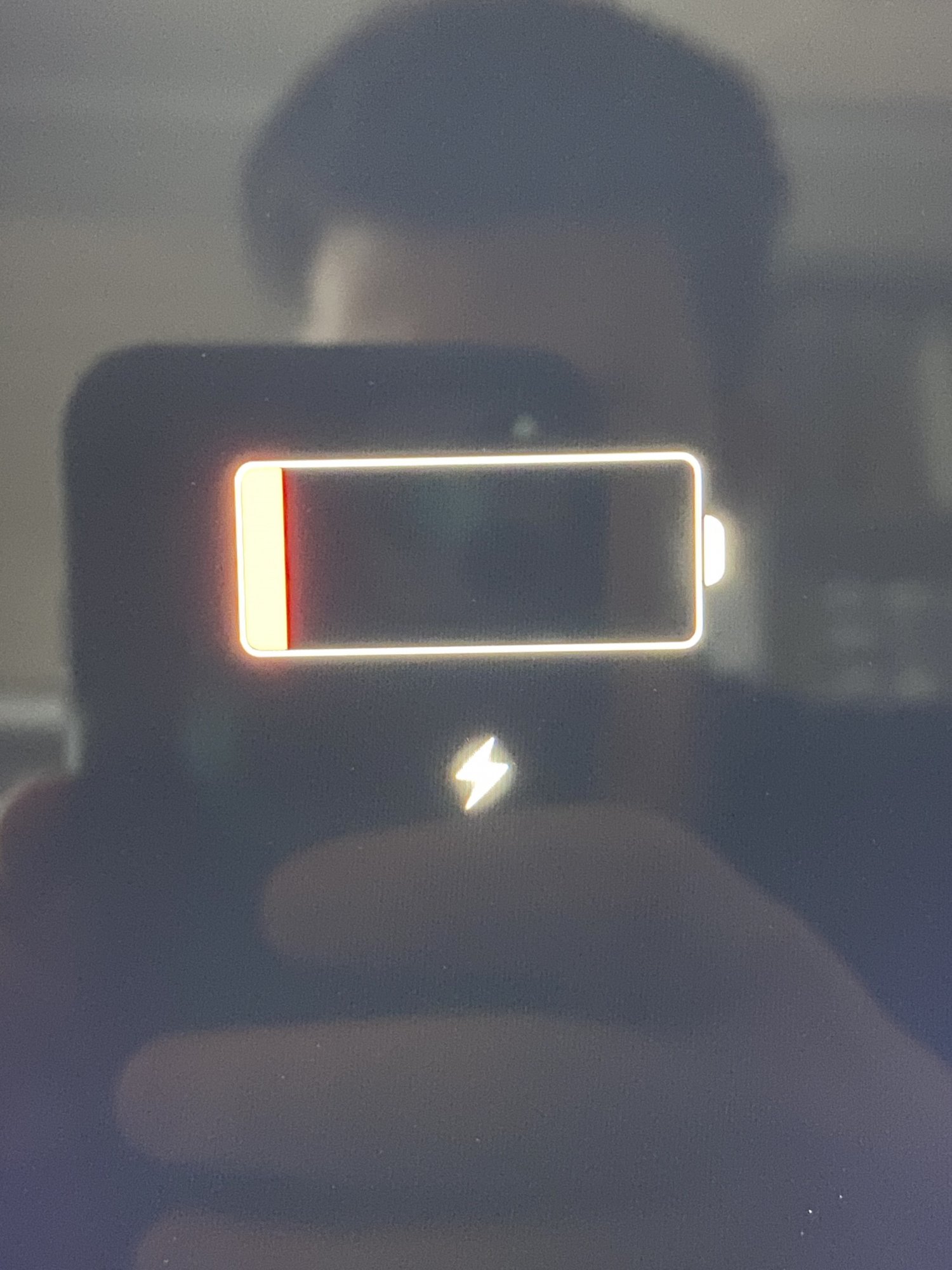

I just received a brand new Macbook Pro 16 inch today and when I open the lid the first time it does not power on despite pressing the power button as well. I plugged it to the wall charger and the screen displays battery icon in red with a charge icon just below it. Kept the laptop charged for few hours but it still will not boot and battery still seems empty.
I have tried resetting the SMC through several methods to no avail.
Anyone has a clue?

MacBooks typically aren't shipped with a dead battery, are they? To receive one with a dead battery is not a good sign and I would suspect that the battery has failed for some reason.
Do you have any way to test the USB-C charger on something else, just to confirm the charger actually works?
Correct, they aren't shipped with a dead battery at all. If all other port doesn't or other power unit doesn't do anything, it's a lemon, return it and exchange for a new one.

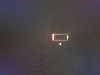

Same thing happened to me. Brand new MBP 16-inch dead out of the box. Tried all the things @ultrakyo mentioned, but no luck. Contacted Apple Support and was advised to send it back for replacement or refund
Very disappointed.
I've had so many issues with TouchBar generation of MacBooks, on multiple machines. Keyboards broke, speakers blew out. I'm writing this comment on my current MBP 15' 2018 using external keyboard (guess why) and, because its battery started to swell (bloat, expand — you name it) I was looking forward to a replacement very much. And the new one is dead out of the box.
@dmylrea That's what I thought too. Not the first time buying apple products. I have used the USB-C charger that came with Macbook Pro 16 to charge my iPad and older Macbook and it work like a champ.
@Shadowbech I tried all ports with same result. The moment I unplug the cable, the touchpad stop giving me haptic feedback and the machine is completely shut off and does not even give me the battery icon. I also tried with 87W apple charger and the same thing occured.
@michaelromanenko Guess we are out of luck this time?!?! 😡 Something that is not expected from a $3K machine.

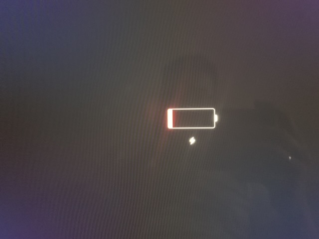

I went for an exchange and the exchange window period here is 24 hours (Crap). It seems like the issue lies with the chip driving the USB-C PD so it keeps charging at standard 5V instead of pushing it to the max.
What I see the possible official Apple Support solution is full replacement or replacement of motherboard.

Went it for the swap today. The one they swapped was identical and on the daily shipment to the store. It also did not work. From box, open, push power button. Red battery. Sat for 30-40min and wouldn’t charge. Model MVVN2LL/A - MBP 16.0 SG/2.4GHZ 8C/32GB/5500M/2TB-USA. They brought another (third) out. Noticed the model was different. Model MY222LL/A - MBP 16.0 SG/2.4GHZ 8C/32GB/5600M/2TB-USA. It powered right on. Apple logo on opening screen. Charged fine. The only difference in models is the AMD Radeon video card. 5500m mid grade choice. Vs highest choice 5600M. An $815 difference. The lead gave it to me for the same price. Out the door. These folks didn’t seem to have an explanation. Just some story about lithium ion batteries and dissipation of electrons moving too far from each other to be able to charge again. Only an issue with new batteries that have only seen the initial charge. Says it won’t happen again, should I not power it for 6mos once it has burn in time. Whatever. I got an upgrade and a working unit. Will post any issues.

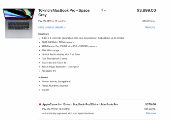

Same issue here, went through two laptops with the same dead battery from different apple stores. Reseting the SMC did nothing. Only two stores had my config in stock, which I was surprised any had it so I drove an hour for each. I attached the specs below if that matters. I'm waiting for my third unit to ship now, hopefully from a newer batch. Talked to apple support for 2 hours and their only solution was to issue a replacement.
