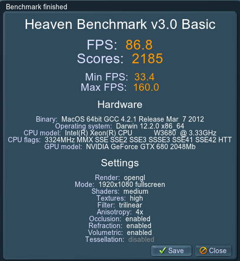

GTX680 not so good
I have installed a GTX 680 2Go in my mac pro 2010; Mountain Lion. Using Unigine-Heaven-3.0.app as benchmark, I get a score 10% lower than the score obtained with the Apple ATI 5870. In contrast, under bootcamp, the GTX680 get the same score as 2x5870 in SLI mode. It seems therefore that the 680 does pretty well under Windows 7 but behaves poorly under Mountain Lion, and this, even after installing the latest NVidia drivers for this card. I suggest that owners of 5870 wait before bying the GTX 680 that Nvidia or Apple provide decent drivers for this card...
This is not what I see on my Mac Pro 5,1. See my post: https://forums.macrumors.com/showthread.php?p=15444914#post15444914
I also ran a new test today on my GTX 680 SC and attached the result.
I can not test the HD 5870 because it is in another computer now.
My current NVIDIA driver is 1.3.4.0 (304.00.05f02).
I believe that you are in error.
Can you please specify which OS and drivers you are using?
I will recreate tests in a 5,1 Mac Pro as I have both cards handy.
Aside from which, basing purchase decisions solely on Unigine Benchmark is a good choice only if you plan to earn a living solely running the Unigine Benchmark. There are many aspects to GPU performance, this is only one of them.
