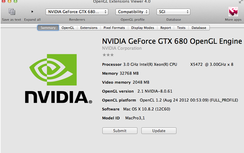

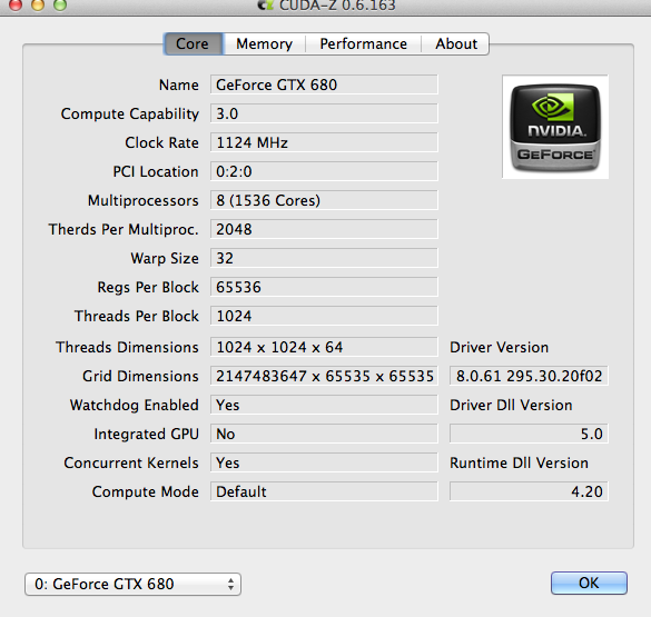

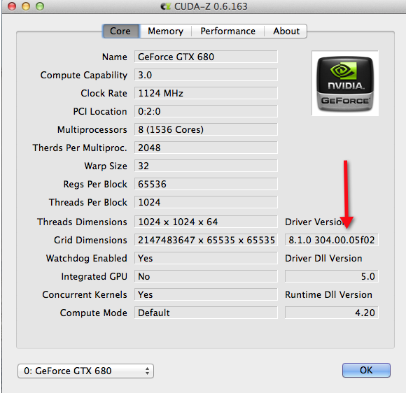

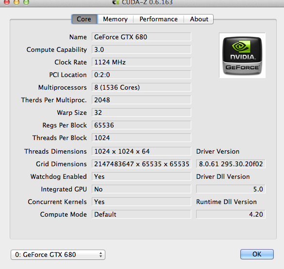

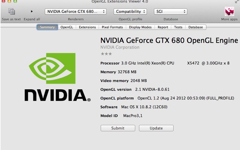

EVGA GTX 680 2GB Mac Pro 3,1 (3) ACD 2 DVI-D 1 DP
Has anyone managed to get (3) Apple Cinema Displays running on the GTX 680? I have connected two (2) of the three (3) ACD's to the EVGA GTX 680 directly and the last display with a DisplayPort to Mini DisplayPort adapter that is connected directly to the Apple Active Mini DisplayPort to DVI-D adapter that is powered by a USB port. If the DisplayPort is disconnected both DVI-I and DVI-D drive two of the displays perfectly. Once the DisplayPort cable is attached to the EVGA GTX 680, one of the two DVI connections is disabled and the GTX 680 will drive one DVI and one DisplayPort connections. This confirms the DisplayPort to Mini DisplayPort to Apple Active Mini DisplayPort to DVI adapter works perfectly which is no small feat. This new EVGA GTX 680 has been Netkas'd by modifying the OpenCL.framework files Hex. Any help / guidance is apprecitaed in advance. Thanks MacRumors forum members in advance!:apple::rolleyes:
PS. If anyone can confirm this is due to 2560X1600 resolution using (3) Apple Cinema Display (ACD's) with an EVGA GTX 680 with only 2GB of VRAM please reply! Thank you
OSX 10.8.2
Nvidia Cuda Driver 8.0.61 295.30.20f02
UPDATE: Moving to the newest Nvidia Driver labeled 304.00.05.05f02 Nvidia's 8.1.0 304.00.05f02 driver added support for the DisplayPort (DP) interface allowing 3 Apple Cinema Display's running at full 2560X1600 resolution using one DisplayPort to MiniDisplayPort Cable Dongle to Apple's Active MiniDisplayPort to DVI-D adapter. This enables native connectivity to (2) of the ACD's natively via DVI-D and (1) connection via the franken cable adapter for the third Apple Cinema Display (ACD). Note that there is no requirement for a 4GB GTX GPU with this setup which was discussed on a previous thread.
Link provided here, super hard to even when searching specifically
PS. If anyone can confirm this is due to 2560X1600 resolution using (3) ACD's with an EVGA GTX 680 with only 2GB of VRAM please reply! Thank you
You left out the most important details, OS and Nvidia driver version.
