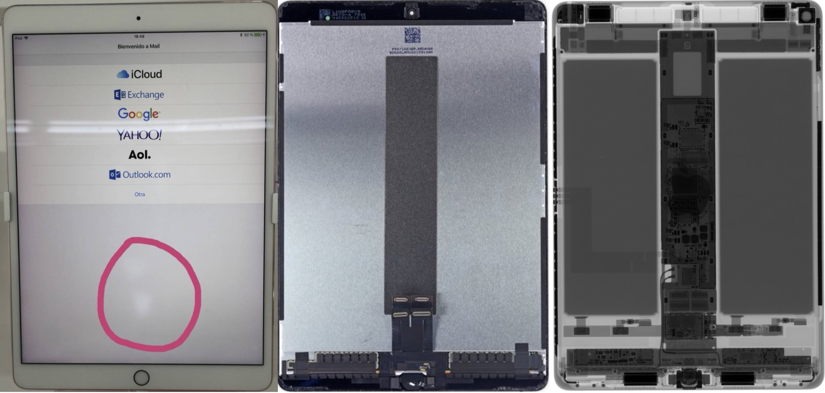

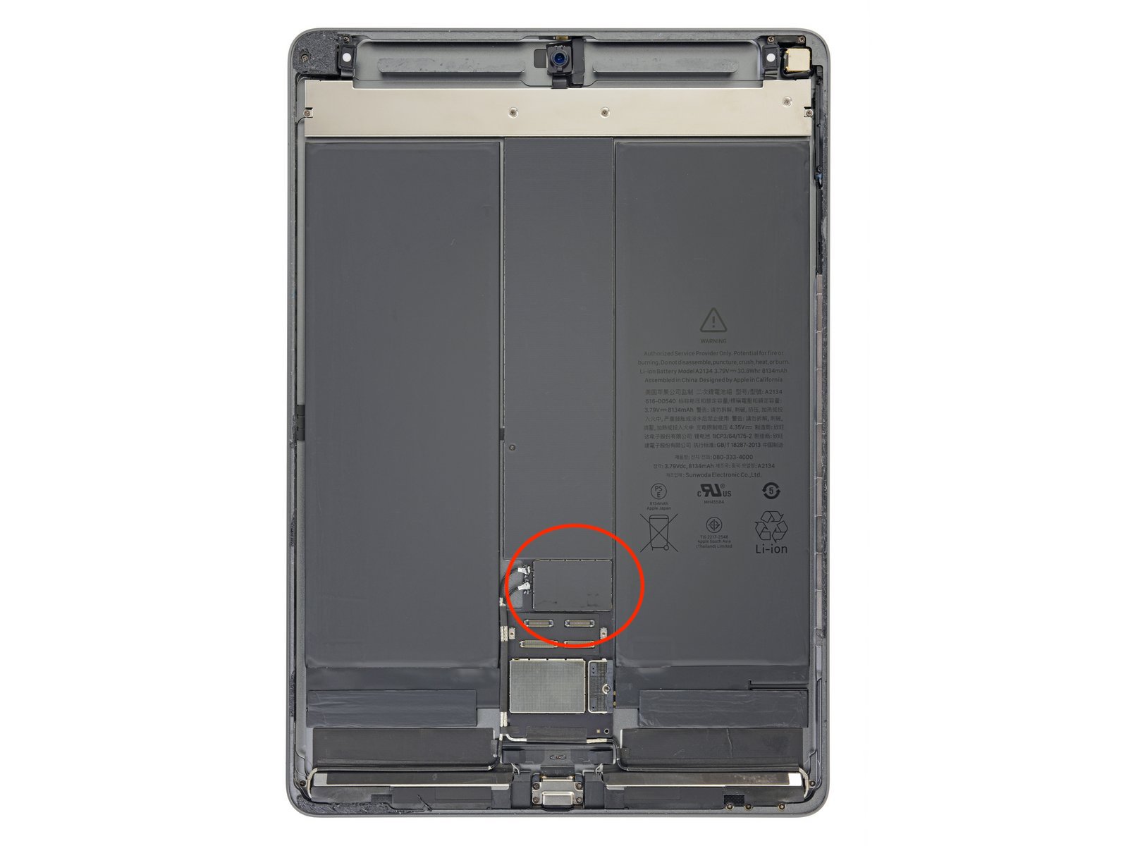

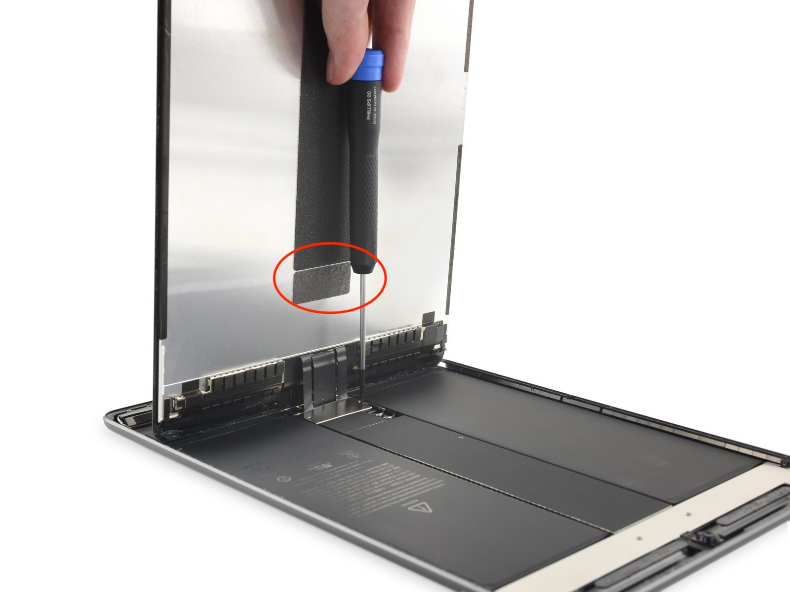

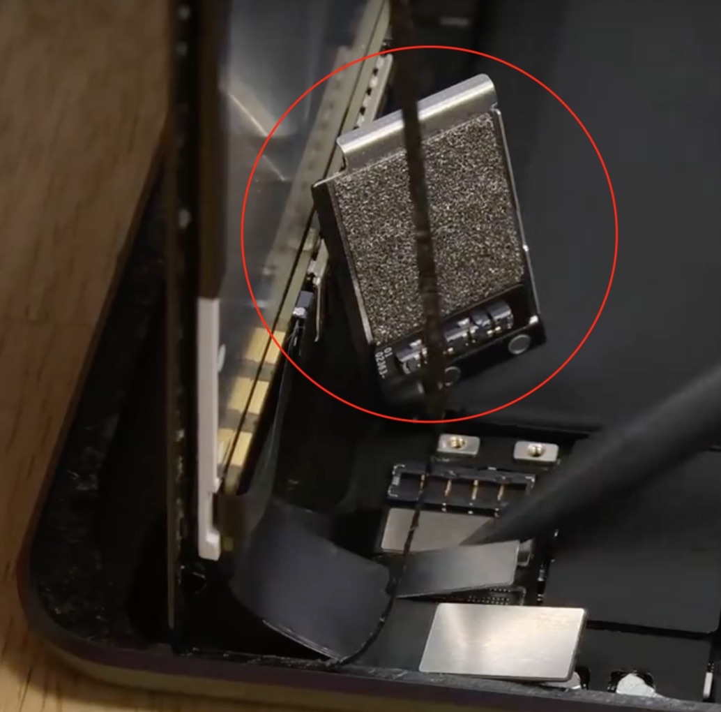

I just thought I’d post a comparison image using photographs from the iFixit teardown and one from another forum member of the problems affecting the iPad Pro 10.5 displays.
The most commonly affected area of the display does appear to line up with the four connectors and these are covered by a metal plate.
screen-shot-2019-04-02-at-11-14-47-jpg.829977

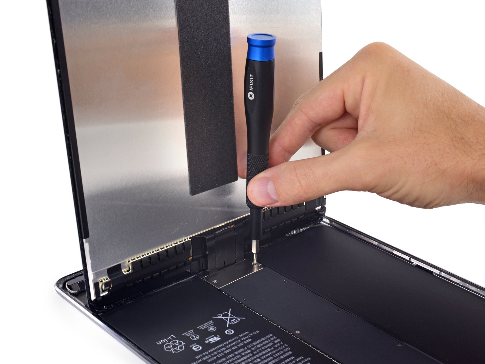

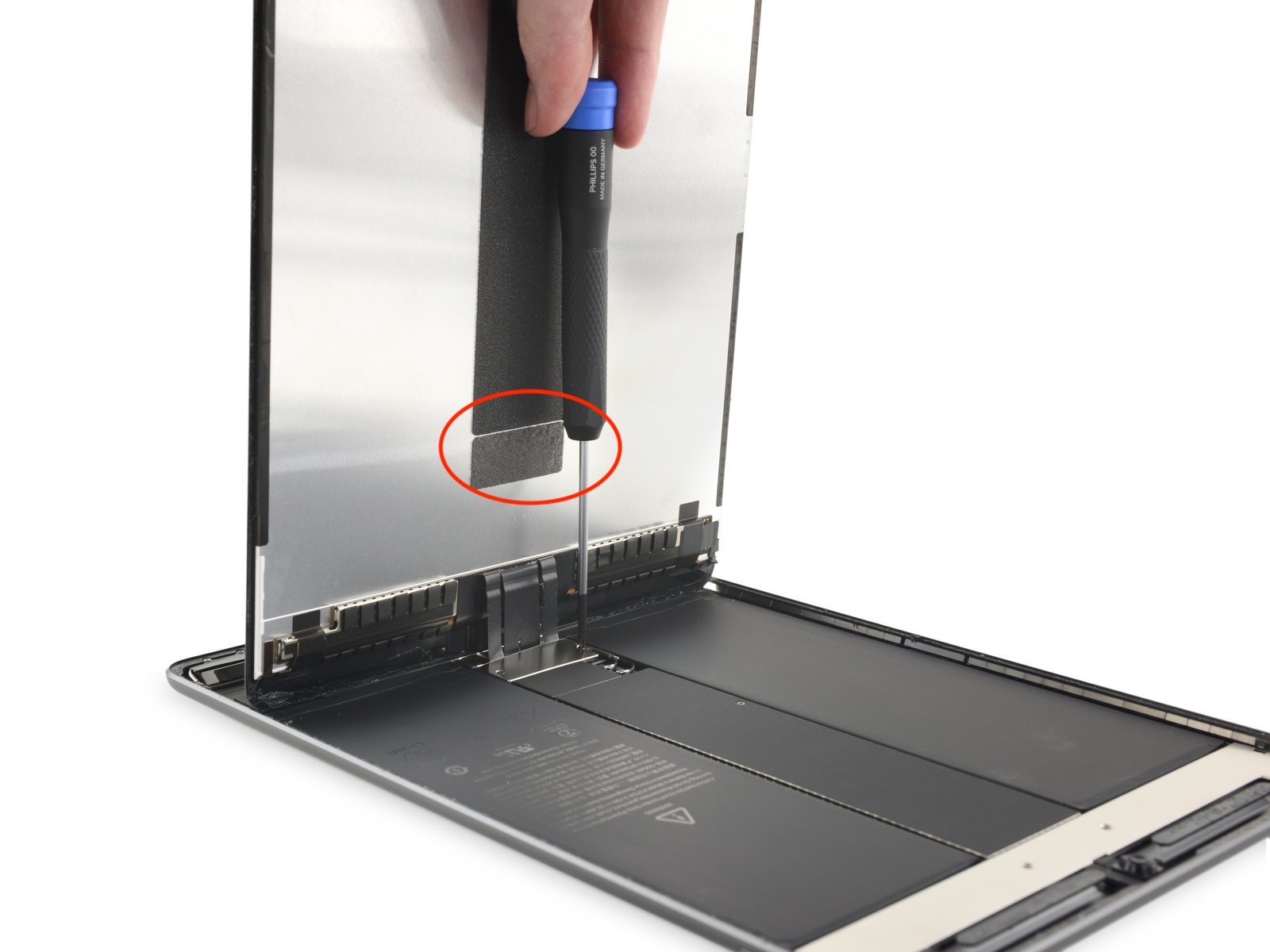

iFixit has just released the teardown of the Air 3 and there are a few changes compared to the Pro 10.5.
In terms of similarities, the Air 3 uses the same basic layout as the Pro 10.5. There are four connectors to attach the display to the logic board, unlike the three used in the Mini 5, and the connectors are still covered by a bare metal shield. The new wireless module is located in the same position as the old one, just above the connectors.
As far as changes are concerned, the material used on the back of the lcd panel, above the display connectors, is now different from that used to cover the rest of the logic board. The material looks like it's the same as that used on the underside of the shielding. I'm speculating that this material is more heat resistant -
iPad Pro 10.5
pro-10-5-1-jpg.830110
iPad Air 3
air-1-jpg.830111

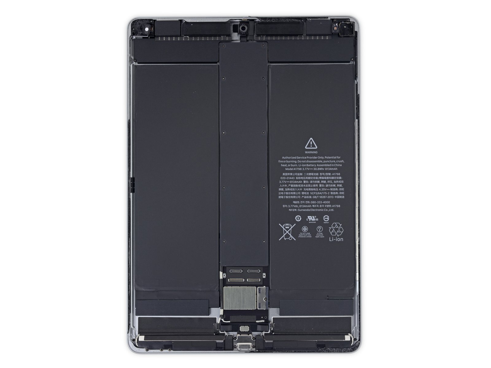

The shield covering the wireless module appears to be separate from the rest of the logic board -
iPad Pro 10.5
pro-10-5-2-jpg.830112
iPad Air 3
air-2-jpg.830113
I can't see any reason why these changes couldn't have been incorporated into later versions of the Pro 10.5, but we don't know whether they have.

The problem usually occurs directly over the display connectors, just below the wireless module. The A10X and A12 processors are located much further up the logic boards.
It looks to me as if most of the material on the back of the display is some type of foam padding, but on the Air 3 they've used more heat resistant material on the affected area. This material is also used on the underside of the metal plate which covers the display connectors.

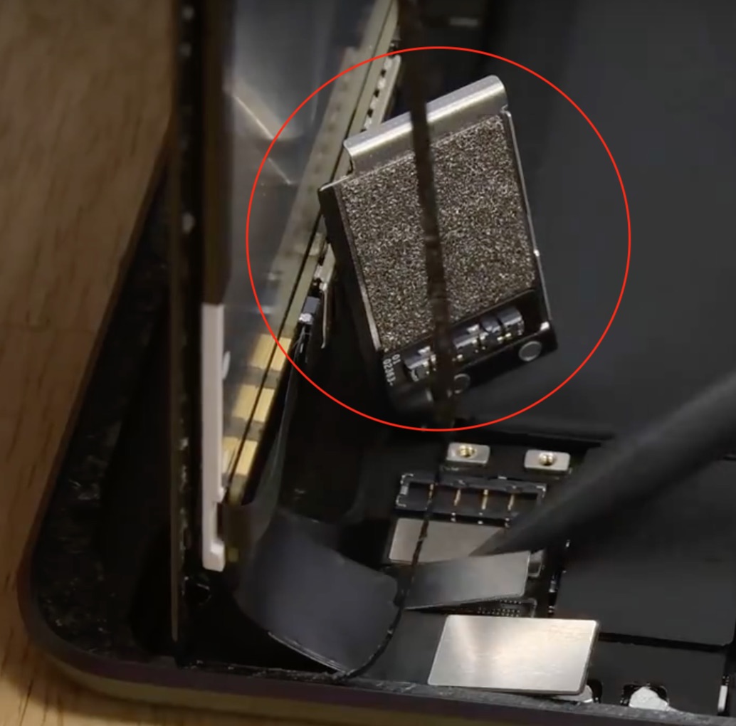

On the Pro 10.5 it was just used on the underside of the metal shield, but it looks like Apple are now using this on the back of the display for the Air 3.
Pro 10.5
Air 3
iPad Pro 10.5
iPad Air 3
air-1-jpg.830111
iPad Pro 10.5
iPad Air 3
air-2-jpg.830113
Pro 10.5
Air 3

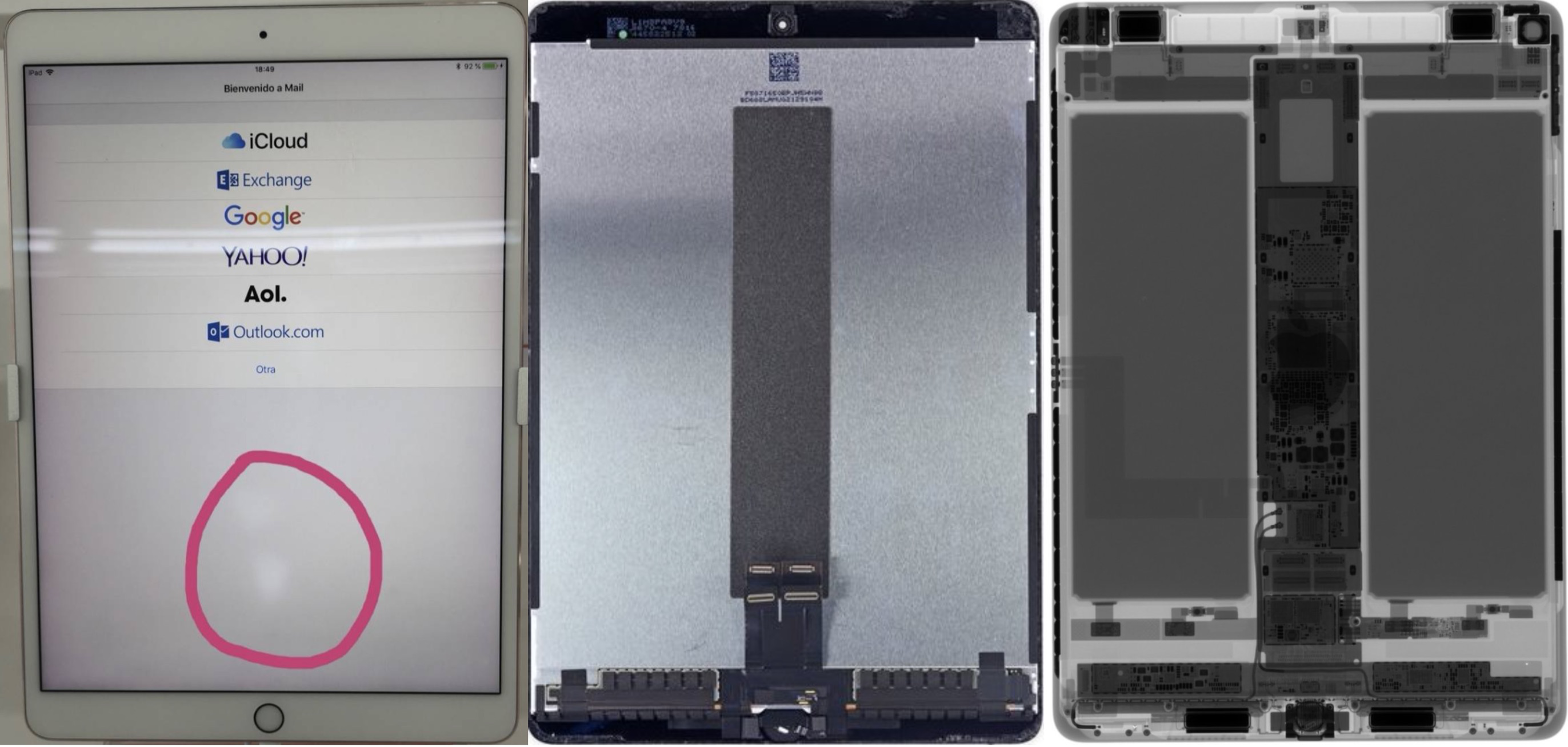

Another interesting thing is that there was a reddit post (I will post it later on here) where OP had a pretty severe case of the bright spots on his iPad Pro (12.9, 2017). He was able to use a suction cup and lift the screen to have the bright spot removed. I'm not sure how long this lasted though. Does this mean that the screen is not permanently damaged from all of this direct contact and the heat that's produced in that area?
Lastly, could there be a possible DIY fix that people could use? Perhaps they could open up the screen themselves and put material similar to what Apple did with these newer models. If they also have the bright spots, they could use the suction method and hopefully this combination will severely decrease the chances of the bright spots appearing.
Just some throwing some thoughts out there.
Reactions: 480951 and t0m4t0
So if the issue is heat related, then does an affected 10.5 pro screen permanently show a white spot, or just when working hard ?
If the former, then I am sceptical because you need quite a lot of heat to permanently damage an LCD.
^ The more I think about it, I think heat is part of the equation, but not the culprit. iPads have never had good heat solutions, as well there is.... None. Unless these iPad Pros go beyond a certain threshold that iPads before have never gotten (Which I don't think is the case), I think its the change in material used for these devices, as shown in this post, to cause the already present heat buildup to lead to these bright spots.
And as shown in that reddit post (Which I will link later), I don't think this permanently damages the LCD

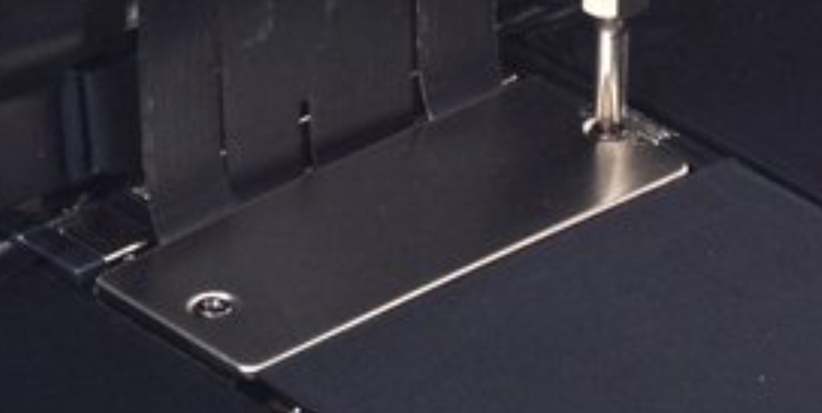

It could be a combination of both heat and pressure as the screen will probably flex slightly in that area.

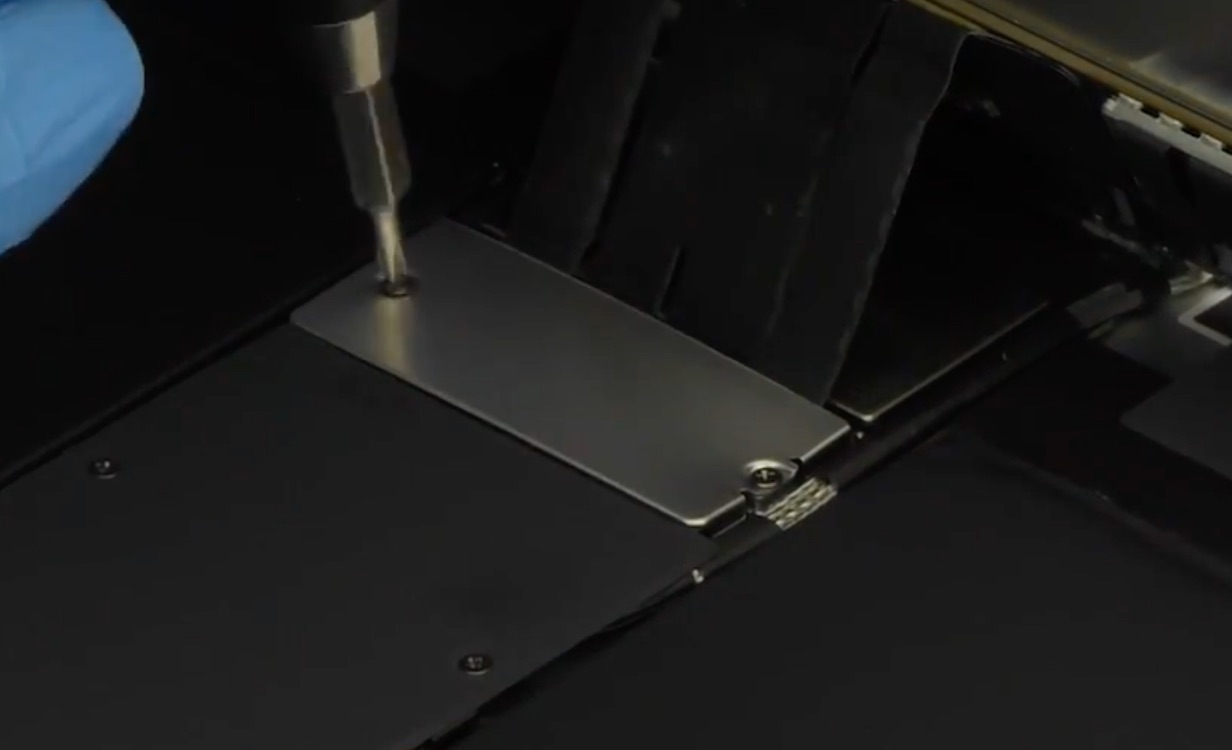

On iFixit’s teardown of the Pro 10.5 the metal plate covering the display connectors does seem to be higher than the shield covering the logic board. It looks slightly bowed. There’s only what appears to be a thin layer of material to separate the metal plate from the back of the lcd panel, which is also metal.
I just wanted to highlight that changes had been made to the Air 3 and that they were in exactly the same place as most people had encountered the issue on the Pro 10.5. Anything beyond that is pure speculation.

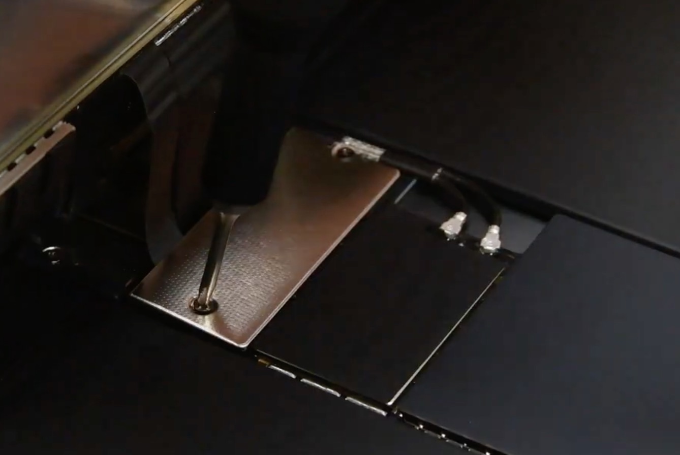

One other subtle change, I think, is that the plate covering the display connectors appears to have been redesigned. It now has a different finish, with lines etched into it, whereas on the Pro 10.5 it looks as if it's completely smooth. The Air 3 image was taken from the iFixit teardown video.
Air 3
Pro 10.5
It's difficult to judge on the Pro 10.5, but I can't see any lines on the plate when watching the following video. It's the 45-second mark -
