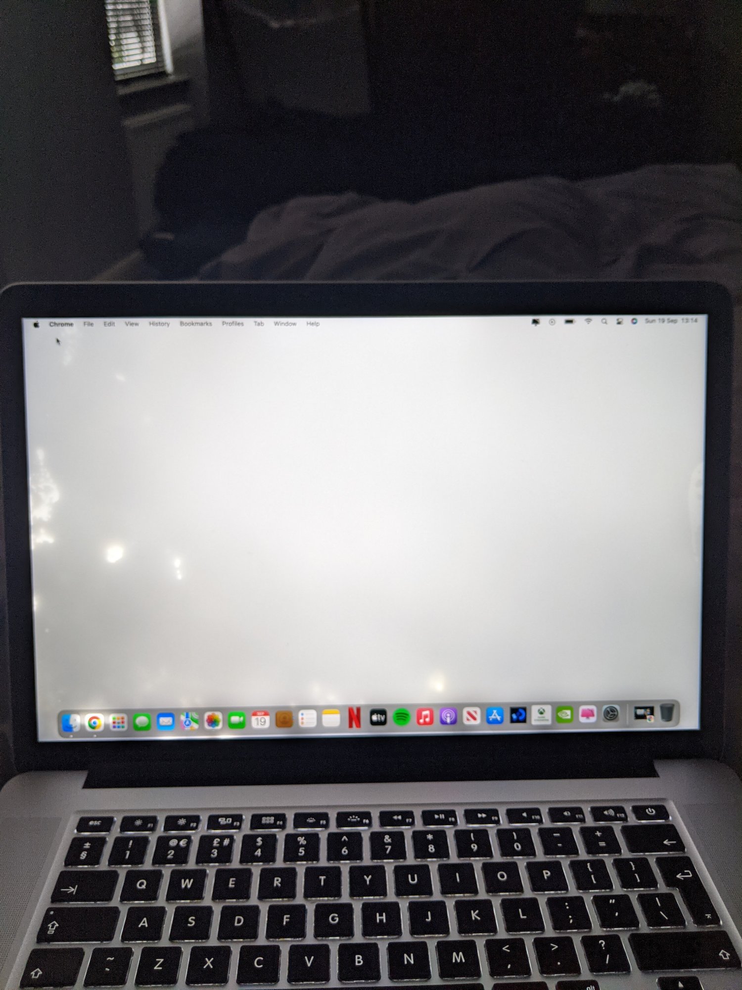

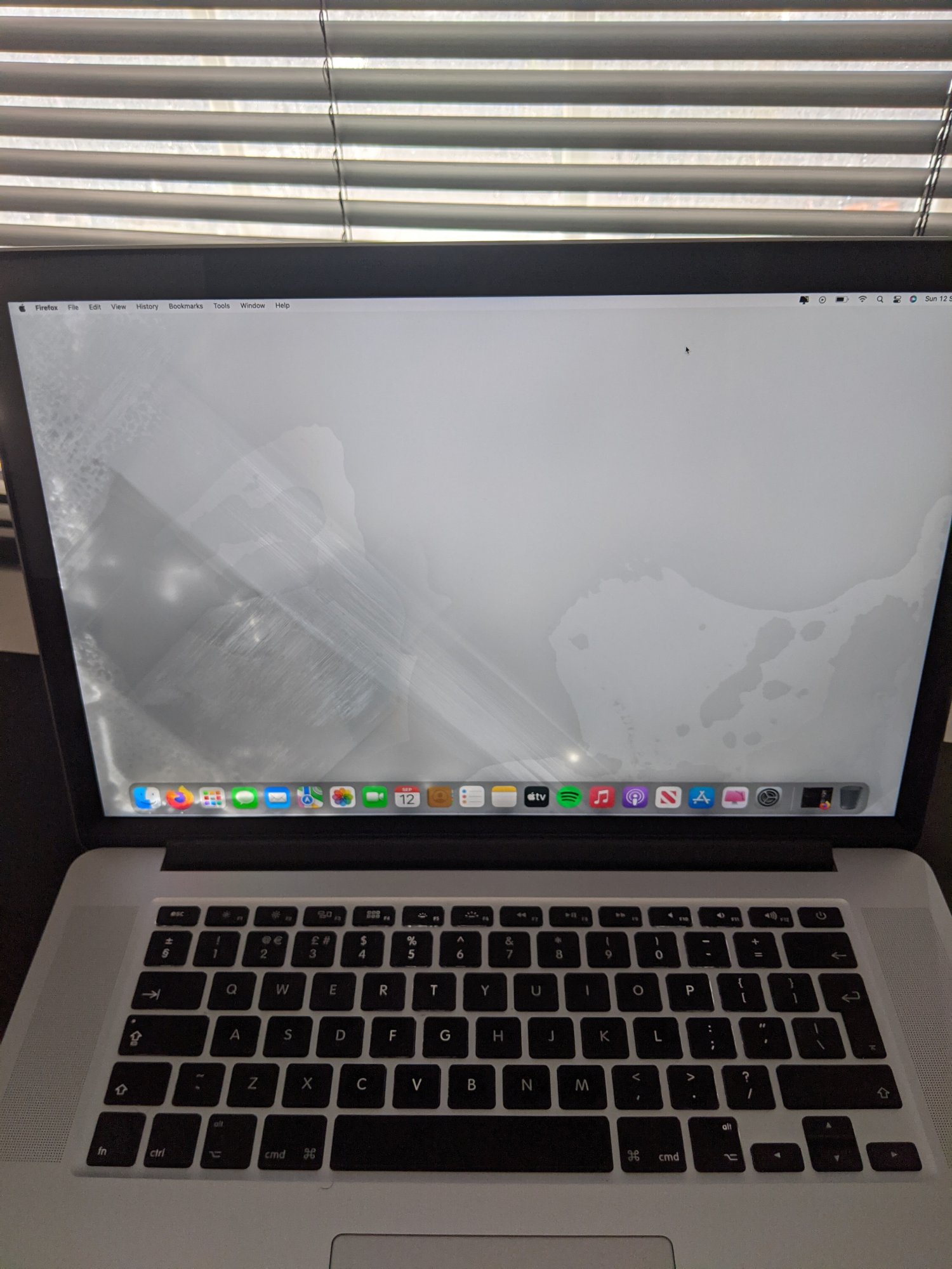

Hello, i recently tried to remove the anti glare coating on my 15" MacBook pro mid 2015 on the 10th of this month. I managed to remove all the anti glare coating but when i powered it on afterwards i noticed blotches on my screen. It seems as if the alcohol somehow managed to get in my screen. Please have a look at the pictures. Is there any chance the light spots will completely clear up? or is there anyway that i can remove it? i really don't have the money to replace the screen right now

Looks like bright spots caused by pressure on the screen, possibly while rubbing the coating off? I had a desktop monitor that was knocked by a heavy object, and it resulted in a patch of permanently bright pixels right where the object had made contact.

It might well have been the pressure i applied. I am fairly heavy handed and i was aggressively trying to remove the coating. I didn't even think the amount of pressure could have caused it. Some of the bright spots disappeared days after the problem occurred. Thanks for your reply
Your choices:
- Live with it.
or
- Get the display replaced.
There's no way that you can "fix" this, other than by replacement.

Thanks for your reply. I don't think i can live with it like that, i guess i just have to replace the screen.

Yea, you have to be really gentle when rubbing the coating off. While it's too late now. I will say it comes off with baking soda and water using gentle rubbing. It just takes an hour or two or polishing, cleaning to check if complete and polishing more.

Thanks for the advice. If my new screen requires delaminating, i will try your method whilst being very gentle. Thank you.

You can find the mixture online. Just have a towel ready as it doesn't really make a paste. More of a slurry and they will separate while rubbing. I think I made it a little dryer than recommended. I also put the screen on a towel to prevent scratching.
