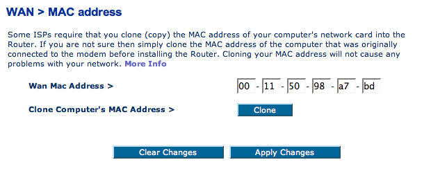

Another thing is to clone the MAC address of the computer and the router/modem. That could help significantly. It helped with me (tripled my iTunes download speed).
explain, please 🙂
beatsme said:
explain, please 🙂
I'm not saying it'll help for everyone but,
I'll try. 🙂
Depending on what router you have (and I believe all of them should have it), there should be an option of cloning the MAC address, eg, the MAC address of the computer and the MAC address of the router. When you clone, you're cloning the computer's IP. This is above all important, as it is the first key to ruling the world. 😛 No, just joking. I know with Comcast Cable, that immediately right when I did that, I got incredible bandwidth (bandwidth I should have been getting all along).
