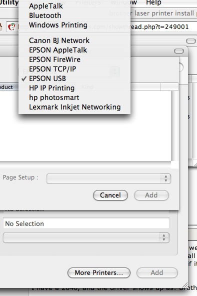

I'm getting an error message when trying to install a brother HL2070 laser printer. I've attached screen shots.
Usually, my Powerbook has been able to find a new printer when attached and do the install for me. However, it's not recognizing or finding a new printer under Printer Setup Utility.
Any help would be appreciated!

It says to select USB on the Printer Browser at Printer Setup Utility. But, that option is not appearing.
I am directly connected via USB at the moment, with the idea of making it a wireless printer via AirPort Express.

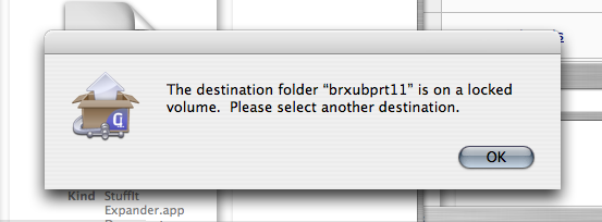

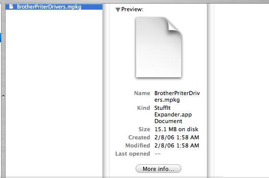

I can't get the pkg file to expand to get access to the driver! Ugh!
EDIT: the same error message as I showed in my original posting appears with the driver package on the CD and the one I downloaded. It's not expanding the drivers.

EDIT: apparently this is some sort of permissions problem. I've repaired permissions to no avail. You would think an authentication box would pop up, but it's not.
Yeah, I'm still struggling to see how it's a permissions problem, but I'll keep looking into it. 😱
I changed the Stuffit Expander option for destination to have it expand to the location specified by the archive. I no longer get the error messages, but the drivers aren't showing up in the Printer Setup Utility either. So, where is it expanding to? What kind of files should I look for in Spotlight to determine this?
