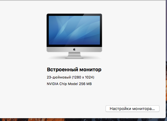

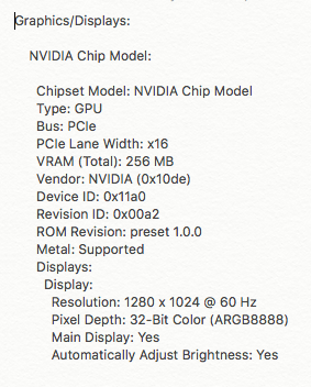

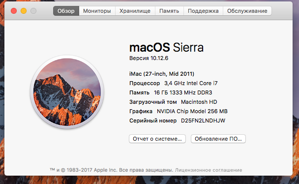

@Synchro3 Guys help. Tell me what to do. Where to read what to watch. I re-read all the threads, but I got confused. The native video card died. Put 680 from Dell. The dark screen and in the description wrote: nvidia chip model 256.When my card was dead I took the system disk from my Macbook 2009 (where the 256 nvidia on board???) and put into imac, and imac drive put to my macbook so i can to work with. But I have already updated from El capitan to Sierra on imac and nothing has changed. The web driver is instaled. If I need to turn off the sip, I can put the system disk back on the MacBook and disable sip. Please help .. a week already digging myself. Sorry for my english, i'm from Ukraine. imac - it's my primary working horse... without i loose my money and i have 3 children...please help...
open
open
open
'Nvidia Chip model 256 MB' means the card is not recognized properly by drivers (not likely because the GTX 680 does not need the web drivers, but is supported natively in OS X), or not powered properly. Did you connect the two six pin power connectors of the GTX 680? Which EGPU enclosure do you use?
i'm sorry, i'm using internal mxm card no enclosure. it was replaced from original gpu because original amd 6970 was died...
Reactions: sd70mac
sorry. ok i'm posted there. Thanx!
[doublepost=1503403634][/doublepost]
Ok, you are in the wrong thread. This thread is about eGPU's.
You should post your issue in the iMac forum.
Or here: http://forum.netkas.org/index.php?topic=8422.0
please show me imac forum! plz 🙂
