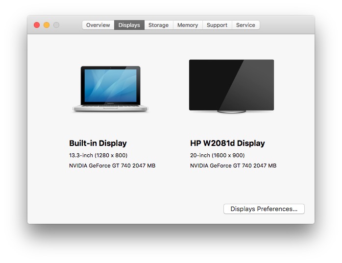

I recently got an eGPU. I noticed that Minecraft seems to only use my CPU even though I have the eGPU plugged in. Does anyone here know of a program which will allow me to force Minecraft to use the dedicated eGPU instead of just using the processor? Would GFXCardStatus suffice?
Is the eGPU installed and recognized by the system? Did you connect an external monitor to the eGPU?
Yeah.
And the external is you main display? So Minecraft starts on that external display?
