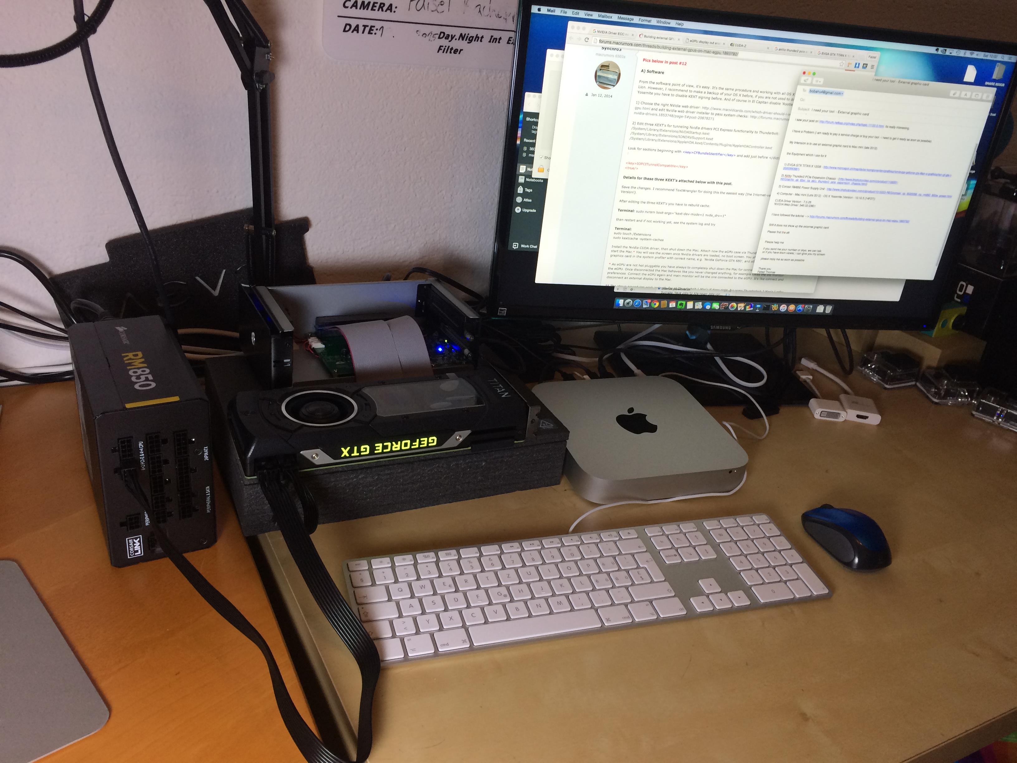

is it possible to connect EVGA GTX TITAN X 12GB to Mac mini Late 2012
i followed your steps but not working
can you please help me
the Equipment which i use for it
1) EVGA GTX TITAN X 12GB - http://www.microspot.ch/msp/de/pc-k...gtx-titan-x-grafikkarten-gf-gtx-t-0000990981j
2) Akitio Thunder2 PCIe Expansion Chassis - (http://www.bhphotovideo.com/c/produ...tia_aktu_thunder2_pcie_expansion_chassis.html)
3) Corsair RM850 Power Supply Unit - http://www.bhphotovideo.com/c/product/1015223-REG/corsair_cp_9020056_na_rm850_850w_power.html
4) Computer - Mac mini (Late 2012) - OS X Yosemite (Version - 10.10.5 (14F27))
CUDA Driver Version : 7.5.25
NVIDIA Web Driver: 346.02.03f01
Ok I see two weak spots:
1. the riser, is it a powered riser? Can you test without the riser?
2. Seems like you didn't the barrel plug mod or are using a powered riser. You really have to power the AKiTiO from the Corsair PSU!
Bonus: Did you apply the paper clip trick to power on the Corsair PSU?
Thanks a lot for all suggestions.......
Finally i got it run.....
the problem was that i was not triggering the PSU...
I triggered PSU with a Paper Clip.......
Thank youuuuuuuuuuu
