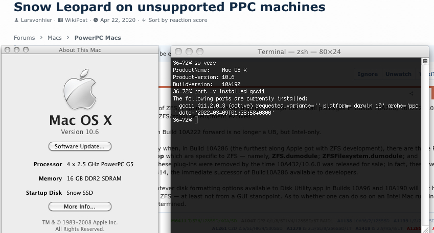

Regarding Xcode set-up
On 10A190 it is advisable to use Xcode 3.2 from 10A190. Alternatively Xcode 3.2 from 10A222 can be used, however it needs manual fixes, such as replacement of `ld` and `gnumake`:
UPD. Xcode 3.2 from 10A222 has Intel-only plugins and Intel-only PackageMaker. If you plan to use Xcode and not just Unix tools, rather stay on 10A190 one.
Provisionally Xcode 3.2 tools from 10A261 may also work after replacing `as`: https://forums.macrumors.com/thread...s.2232031/page-64?post=30769928#post-30769928
On 10.6.8 you can choose between Xcode 3.2, Xcode 3.2.6 and Xcode 4.2 (or a combination of these). However while Xcode 4.2 can be made to work for ppc, that requires a rather non-trivial procedure and even then it does not work smoothly with Macports since llvm-gcc-4.2 is faulty, but Xcode 4.2 sets it as a default compiler. Benefits of Xcode 4.2 tools are non-obvious if any, at least for ppc. More on Xcode 4.2 and ppc here:
It is easier to stay on 3.2.x as long as ppc is concerned.
I am currently using Xcode 3.2 from 10A222: it mostly works (as you can see above), however there is an occasional but nasty linker problem (reason unknown atm). Tools from Xcode 3.2.6 are likely to have less bugs, but on the other hand they may be less compatible with 10.6 PPC. No perfect recipe, work in progress.

Code:
36-47% port -v installed gcc10-bootstrap
The following ports are currently installed:
  gcc10-bootstrap @10.3.0_1 (active) requested_variants='' platform='darwin 10' archs='ppc' date='2022-02-19T12:02:07+0800'

And finally, a natively built gcc11:

A quick update on Xcode on 10.6 PPC: plugins in /Developer/Library/Xcode/Plug-ins from 10A222 are Intel-only. Another reminder to either stay with Xcode from 10A190 or have it ready to replace select components after updating to 10A222.
More on broken components from Xcode 10A222:
Code:
/usr/bin/bsdmake
/usr/bin/gm4
/usr/bin/m4
These are to be replaced with respective ones from 10A190.

I sorta got tired of looking for fixes and used pre-built gcc10-bootstrap from 10A190 (destroot stage) to install into 10.6.8 directly. That worked (nothing surprising, it should have).
Left MacMini to build proper gcc10 natively using gcc10-bootstrap. Gonna update in a while if that succeeds.
Success eventually. (It was slow in a VM!)
Code:
macmini:~ svacchanda$ port -v installed gcc10
  gcc10 @10.3.0_1 (active) requested_variants='' platform='darwin 10' archs='ppc' date='2022-03-23T18:34:48+0800'
macmini:~ svacchanda$ sw_vers
ProductName:    Mac OS X Server
ProductVersion:    10.6.8
BuildVersion:    10K549
