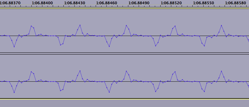

He is a picture of the signal highly enlarged!

Thanks. Good tech info to work off of.
The waveform looks like something switching at around 1176 Hz. As you can see, it's not a sine wave, or at least it's highly distorted.
Looks like it's sampled at 22 kHz (I got 20 just eyeballing it, but the nearest standard is 22). I'm curious to see what it looks like at a higher sample rate - 44 kHz or higher. A screen shot of around the same length would be fine. I'm not sure I can identify it, but maybe seeing a bit more of the waveform would help.

Thinking a bit more on this: switching supplies and even the Macbook inverter run at much higher frequencies, so there's less chance they're generating any noise in the audio frequency range (though, in the back of my mind I remember some reports a long time ago of audio noise in a notebook). However, there are some inverters that do operate at relatively low frequency, in particular, those for electroluminescent lighting (EL panel, wire, strips).
For instance, the Motorola Razer had an EL backlight and I personally went through a couple of them to find one quiet enough to use while the backlight was on. Going back a tad further in time, my Newton 130 has a nice whine to it when the backlight is on.
Add any new gadget recently that might fall into that category (or moved nearby the Macbook)? An experiment would be to move the Macbook into a different room and see if there was any change. It still wouldn't explain why the noise fades, but something to think about anyway.
When you're doing tests, try turning off the noise reduction feature (in Sound Pref pane). That might explain why the sound seems to ride up and down in volume along with a voice (kind of a long shot, but noise reduction can have some odd effects at times).
