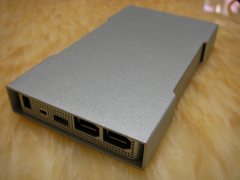

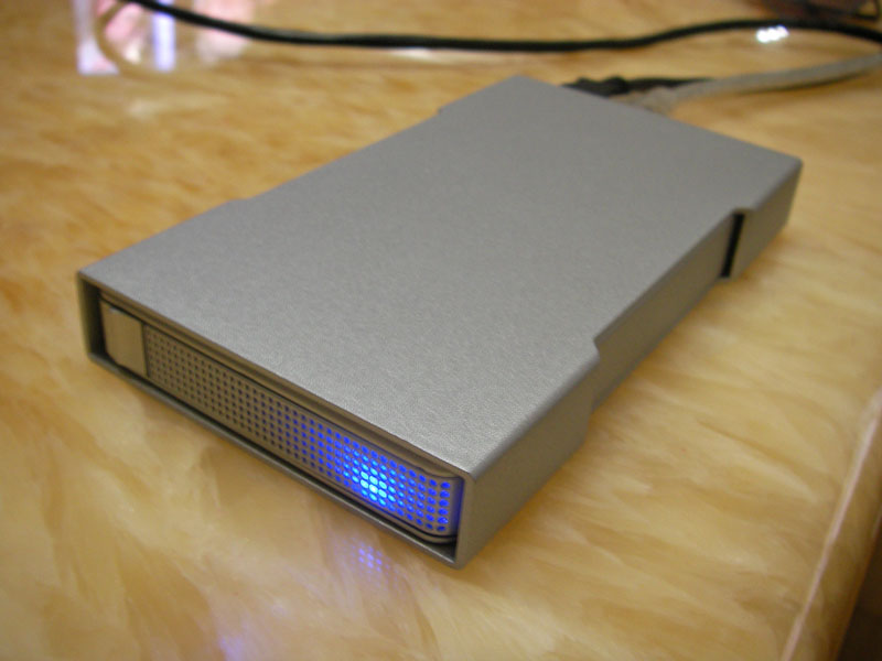

I've just bought a 120Gb dual USB and Firewire external bus powered drive. Works great over firewire, I'm daisy-chaining it with a HDV camera and still with bandwidth to spare even for HDV editing. I bought it in Taiwan and its so good I'm thinking of selling them on ebay considering it was extremely cheap and it matches my Macbook Pro quite nicely! 🙂
