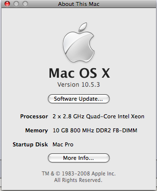

MacPro, My Way...
Here's what did just 4 weeks ago...
Purchased the MacPro basic unit at retail store in Maryland with my educators discount. I teach graduate school part-time so I saved $200. The base unit cost me $2599. I purchased (2) 23" Apple Cinema Displays for the $1,500 that the extra processors would have cost. I just could not see spending another $1,500 for .6GHz. I ran some real world tests in the retail store on both the 2.8 and 3.2 with the 256MB card and the times were extremely close. I rendered an 8 element 1GB movie on both at the exact same time. The 3.2 finished about 20 seconds faster. Both took over 15 minutes.
I also have a new MBP which I use for other tasks when rendering some heavy duty content.
I purchased the 8800GT from CDW and shipped it to my home. No tax and free shipping. I then stored the original card in case i needed it for rebuild or emergency reasons. Since you generally cant run to your local BestBuy for a video card, I wanted the second around.
Do not purchase the second optical drive from Apple. I love Apple but thats one of the biggest rip-offs I've ever seen. I went to the local computer OEM house and purchased a Samsung IDE 20X DVD-RW with Lightscribe for $19 brand new. It takes 2 minutes to install but don't forget to remove the DVD face plate otherwise the MacPro door wont open. Generally you just pop it off with a small screwdriver of pocket knife.
I then purchased 4 2GB FB Memory Chips from CDW for a total of 10GB. Its too much. I really only needed 6, but the heck. The memory was lees than $90 a stick...
Now for hard drives. I too use FCP. I chose not to go any higher than the 320 that Apple ships. You're going to like this. The first thing I did was to remove that and stick it in my closet. I found at BestBuy Western Digital Firewire 800 External Mac Editions 750GB for $129 on closeout. I purchased two of them and proceeded to remove them from the case and placed them directly into drive slot 2 and 3. At the same time I purchased a 1TB Western Digital SATA drive for $199 and that went into slot 1. I installed a 500GB WD I had laying around for back-up in slot 4. Drive 1 is the boot (I reinstalled the software without ever booting to the 320) and Drive 4 is Time Machine. Drive 2 and 3 is used exclusively as my scratch disks for FCP.
I added a pair of Bose Companion 3 speakers.
The 2.8 with 10GB of RAM and all that HD space is ridiculous. I love the machine. It the fastest computer I've ever owned and highly recommend it.
I hope this helps. Enjoy...
