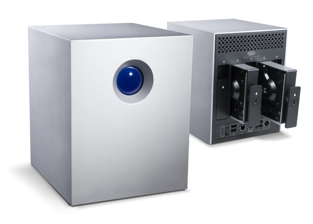

i own a mac mini 2012 and at the moment i have a drobo second generation stoarage device with 4 bays
im thinking to sell this and get the lacie big nas storage but i have two options and still havent decide
the one option is this one:
http://www.lacie.com/products/product.htm?id=10604
and the other one is this one:
http://www.lacie.com/products/product.htm?id=10485
the main difference is that the first has usb 3 and second one doesn't. I dont take into account the eSata option since there is no input on my mac mini...
Since there is a great difference money wise between these two my question is
if i connect the Lacie that only has the gigabit will my speeds be the same as the ones with a USB 3 connection?
since the hard drives are mechanical and they have a transfer speed limit
any thoughts?

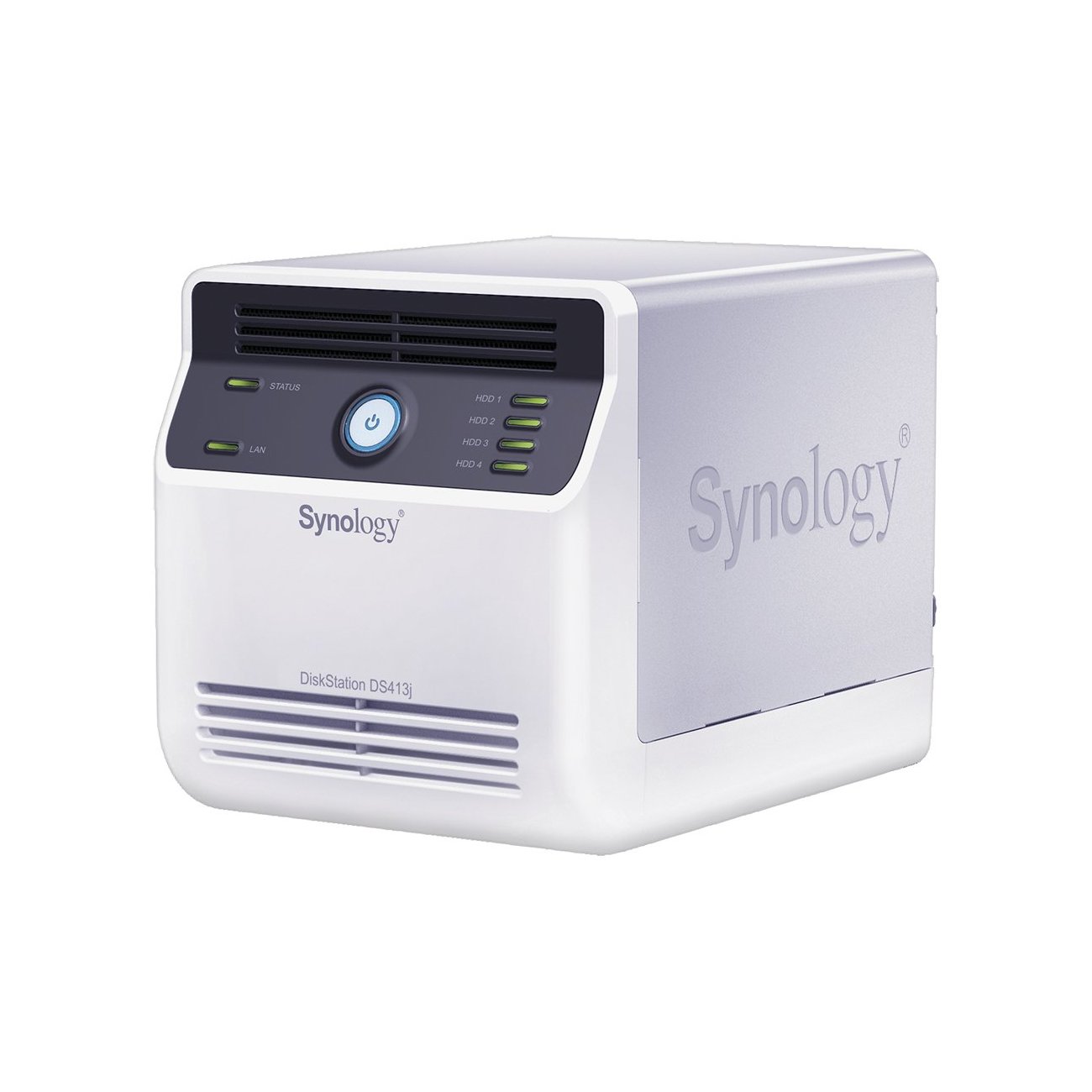

Before you decide, make sure to check out Synology as well.

At $349, the LaCie 5big NAS 2 is actually a valid alternative to the Synology DS413j at $379.99, as it not only has a companion iOS app like the Synology to play movies and music, but it also has one more bay while being less expensive and well, you be the judge on the design of the enclosure made from aluminum:
That is, if it happens to work as well as the Synology and had SimplyRAID like the 5big NAS Pro.

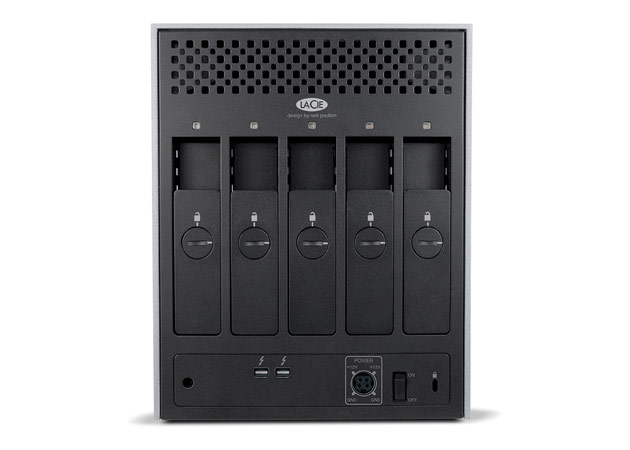

If you want to connect it directly to your machine, go with a USB3 or Thunderbolt model. As stated previously, running via ethernet seriously limits the speed that you can operate the 5big.
Strong preference for a DAS (vs NAS) given what you said. A TB or USB3 DAS is significantly faster.
In addition to the slower wire speed... a NAS also has to deal with the entire networking software stack which also slows down the performance by a lot.
NAS is great when you want to share data... or access it anywhere on your LAN. That ability comes with a huge performance penalty.
DAS is high performance... but is not natively shared. However... you could always set up your Mac to share DAS data on your network.

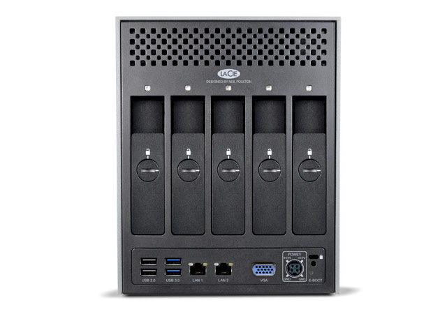

The 5big doesn't have an USB 3.0 output, it has USB 3.0 inputs to attach more hard drives. The difference between the two units is that one can combine the two Ethernet ports to increase the bandwidth, and you need a faster CPU to feed the data fast enough. The Pro model also has NAS OS 3 with the SimplyRAID that lets you combine different size hard drives into something akin to a RAID 5, while the non-Pro model has NAS OS 2.
There is no LaCie 5big with an USB 3.0 connection to the computer, there's the LaCie 4big with USB 3.0 and FireWire800 or the 5big Thunderbolt.

this one has usb 3
http://www.cyberport.de/lacie-5big-...x-sata-2x-usb3-0-2x-usb2-0--3F02-135_409.html
oh really?so these usb 3 ports are only for expansion and not for connection for the 5big?seriously?
Right, that is a NAS - Network Attached Storage. It's not designed to connect to a computer, it's designed to connect to a network. If you want local disks use the USB3 or Thunderbolt products @Giuly mentioned. They'll be faster and usually cheaper.
Edit: Well, cheaper fully populated anyway. Looks like LaCie doesn't offer the USB or Thunderbolt chassis in diskless options 😛
Yes, on that model. But there are two other models to consider that use USB3 or Thunderbolt connections. I have 2 of the Thunderbolt 2big drives. They are really fast and daisy chaining is very convenient. I would strongly recommend the Thunderbolt model.
Another nice thing about Thunderbolt is that the drives in the enclosure show up as standard SATA devices on the host computer. So you get SMART status, etc.
