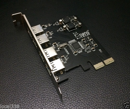

Since I've been getting such excellent answers to all my questions, I thought I'd take advantage of you all yet again and ask if anyone has ever had any experience with the NanoTech 4 port USB3.0 PCIe cards? They seem pretty reasonably priced (~£23) for a card that claims to work with Mac OS X natively.
... ask if anyone has ever had any experience with the NanoTech 4 port USB3.0 PCIe cards? They seem pretty reasonably priced (~£23) for a card that claims to work with Mac OS X natively.
When I was researching USB 3.0 cards, the main difference is how many controller chips are present to support multiple streams of USB 3.0 data.
Some cards have a single chip set to support multiple USB ports, and the data stream thru the chipset is divided among the ports, so (2) USB 3.0 devices connected to the card could run at half their potential data speed.
Some cards have multiple controller chips so that each USB 3.0 port will run at 5G/s super speeds regardless of how many ports are used.
Both designs can be a good solution depending on what you need. I need to be able to connect multiple USB 3.0 devices without limiting data I/O on any of the ports. That may not be what others need.
The cards with multiple chipsets are more expensive. I have been using the Sonnet Allegro Pro which is more expensive than the card you referenced..
http://www.sonnettech.com/product/allegroprousb3pcie.html
@Bytehoven Thanks, that makes some sense. The only reason I would want USB3.0 (that I can immediately think of) is to load/save quicker to removable media. Currently my USB ports are only used for a keyboard, USB cable for my camera and a USB 3.0 drive for time machine so I don't think I'd ever need 4x 5Gb/s, certainly not for any regular use anyway. For £22 I may have a look at the NanoTech card unless anyone can think of a reason not to.
