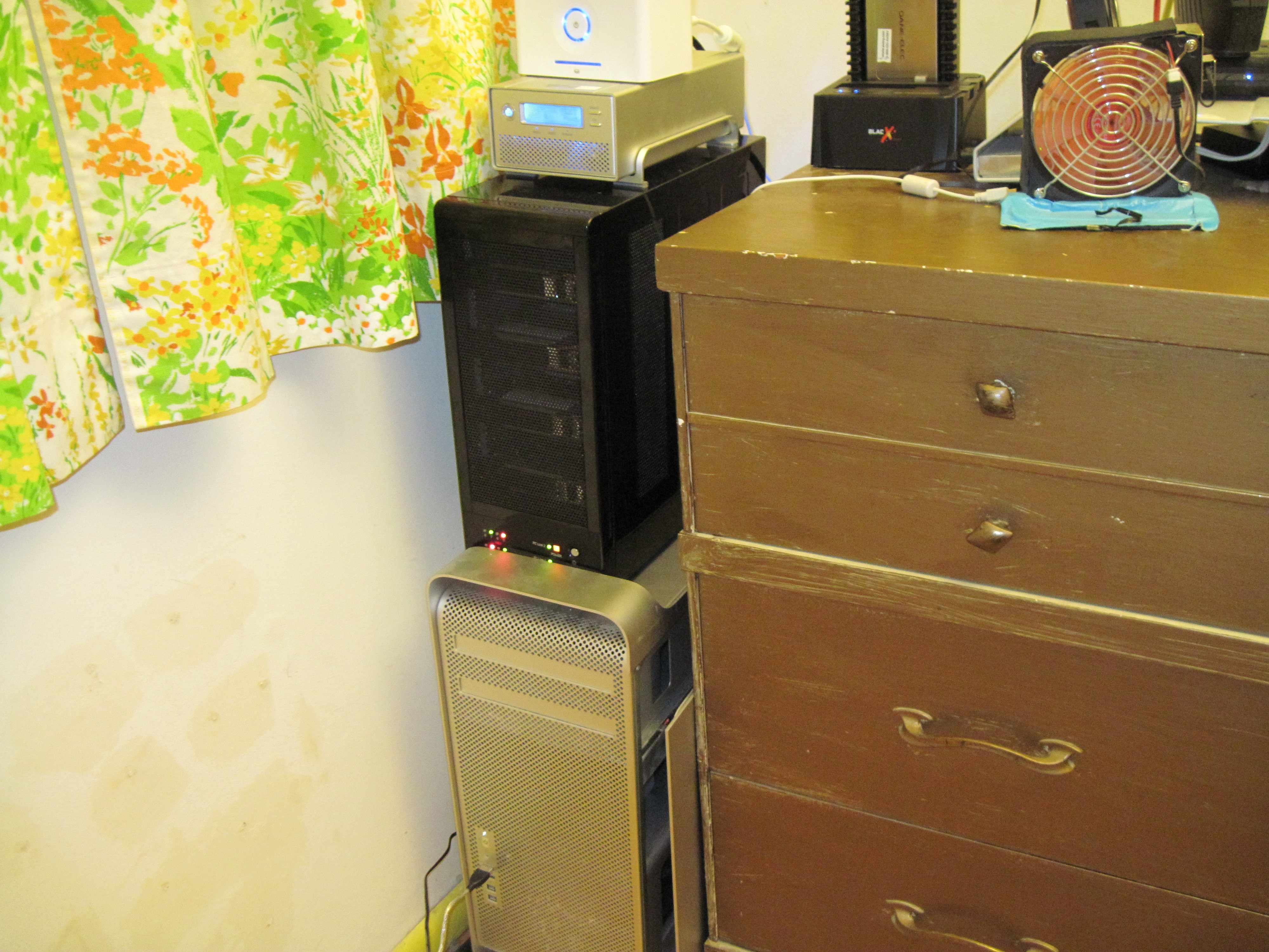

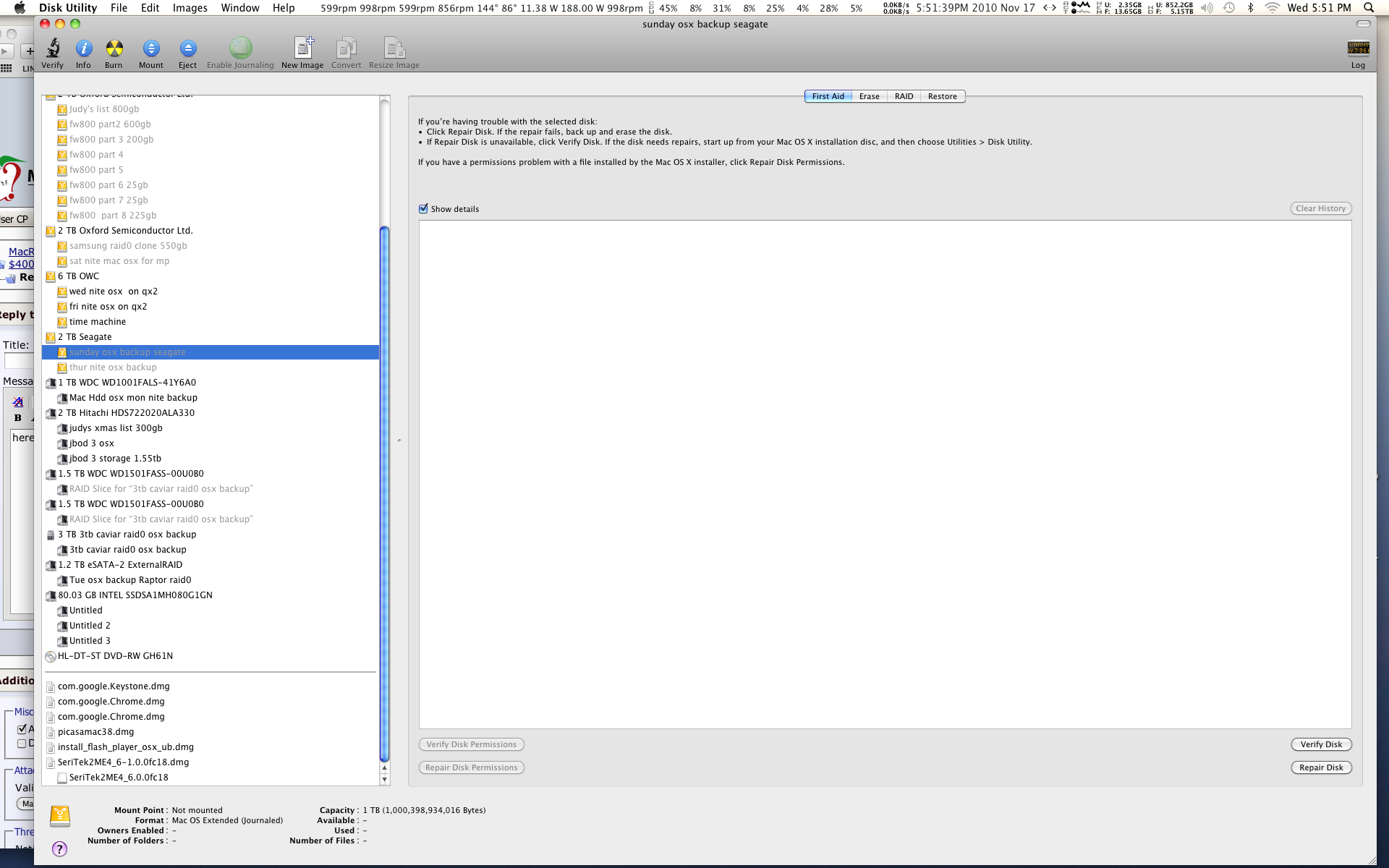

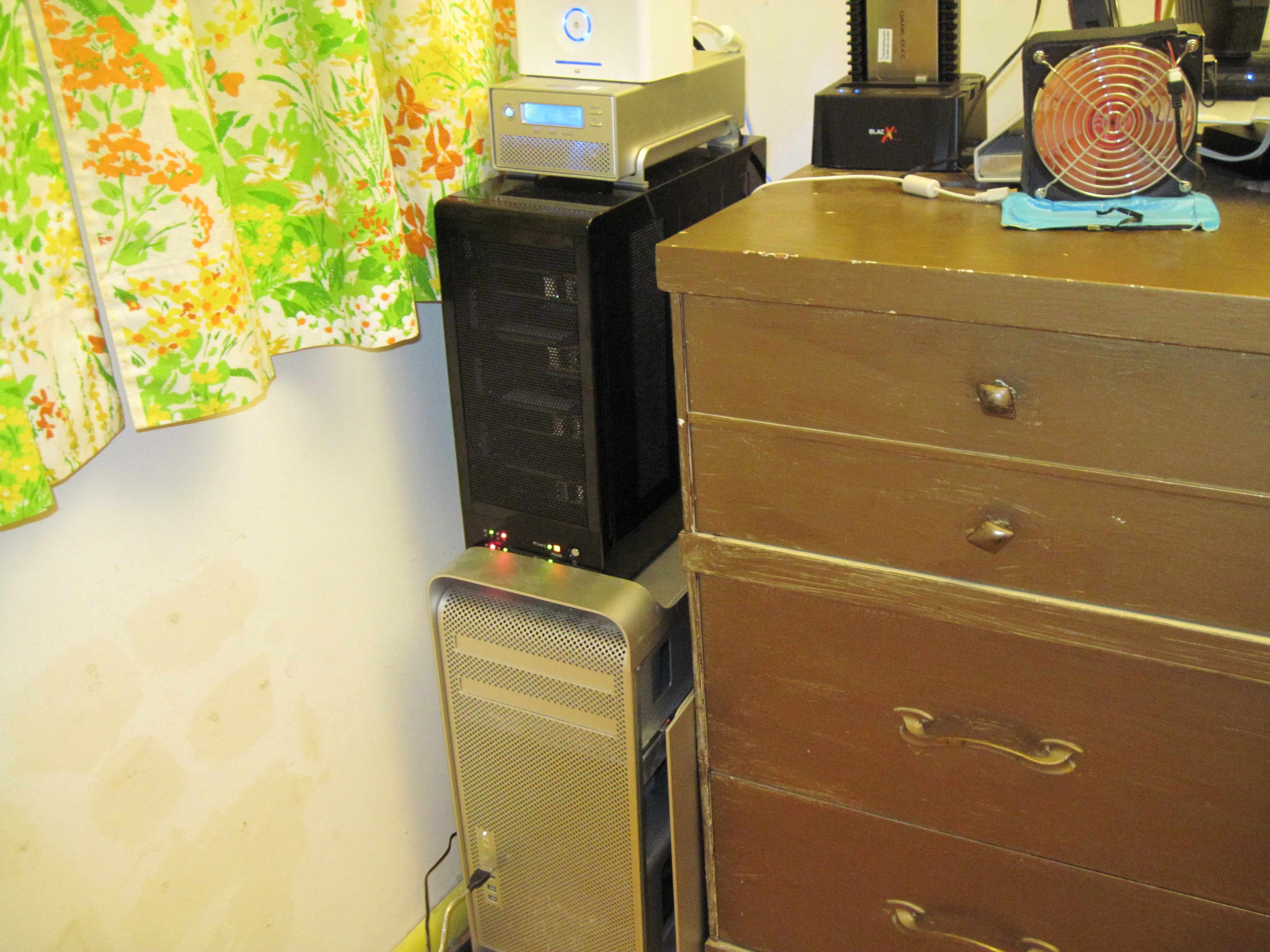

here is an example of an external raid0 it uses 2 hdds in an eight hdd case. it is a bit tough to read but the black external case holds 4 drives
a 1tb
a 2tb and a pair of 1.5tb drive in a raid0 giving a fast 3tb raid0 volume. that black case can hold 8 2tb hdds your macpro can hold 4 2tb hdds. that is 24tb no problem at all.
a 1tb
A bit off topic but please could you tell me the make/ model of tha dasit looks exactly wha i have been looking for if you dont mind thanks - op sorry for oftopic

link to the case
read reviews on it.
http://www.newegg.com/Product/Produ...6&cm_re=rosewill_8_bay-_-16-132-016-_-Product
a 1tb
Holy crap dude. That's a lot of drives.
