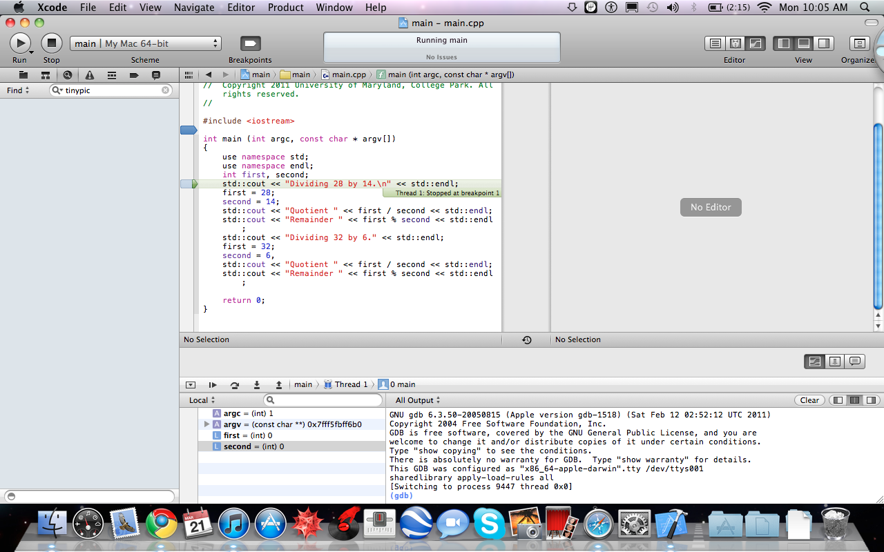

It is not working. On the fourth line that begins with "std::cout..." it says "Thread 1: stopped at breakpoint 1" and I tried messing with the "\n" that I saw in Xcode examples within quotes (I don't know that it means) as well as with std::endl but nothing seems to be working correctly.
1. There is no need to try to declare namespaces; beginners tend to do that because writing std::cout instead of cout is so much more work, but in a large program it is really useful to see the full name std::cout and to be sure that it means what you think it means. I see you are using std::cout and std::endl anyway, so that is fine.
2. It seems you are using a debugger and you are stopping at a breakpoint. Command-Shift-Y shows the debugger window if it isn't visible yet. Then you have buttons to step over the next statement, to step out of a function, or to just continue running. Very useful when you first write a program and want to test it. For example, you could _see_ the values first and second changing as you execute statement by statement.
Here's a screenshot, I just don't understand what it doesn't like. I understand your first point about namespaces (kinda) but my debugger is in fact open... here's a screenshot, the debugger is in the bottom left corner
The blue flag above the int main line is a breakpoint. It stops on the line below because that is the first line of executable code it hits.
