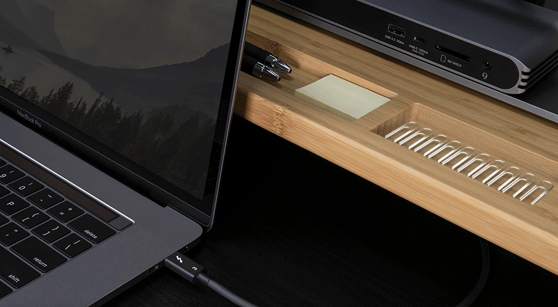

Half a second after that picture was taken:
Amazing, how do you do this? Is it Blender? C4D?
