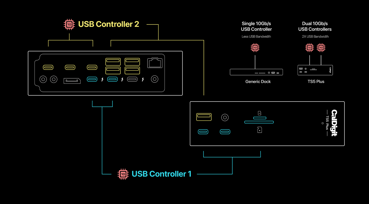

“The TS5 Plus has dual USB controllers inside (one for the front and one for the back).”
This is not accurate. Both controllers are used on the front and back. They have a nice diagram.

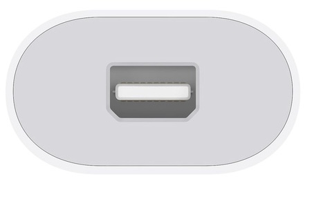

Why we don't get any adapter for Tunderbolt 1 and Thunderbolt 2 - I've got wonderful Promise Pegasus Raid Level 5 HD drives and cannot use them with new Macs 🙁
The only I know that there was a story of Intel connected with these two
The CalDigit TS5 Plus image is not entirely accurate. At least the Thunderbolt 5 ports should be capable of USB 3.2 gen 2x2 20 Gbps speed. They can't work at that speed connected to an Apple Silicon Mac unless there's a Thunderbolt 3 device between the dock and the Mac to disable USB tunnelling. Other ports connected to the first USB controller might be connected using a 10 Gbps hub (they could have chosen a 20 Gbps hub so that other ports can also be 20 Gbps).
When connected upstream to an Apple Silicon Mac, the first controller is the 10 Gbps controller of the Apple Silicon Mac (due to USB tunnelling).
When connected upstream to a PC with Thunderbolt 4 or 5, the first USB controller may be 10 or 20 Gbps depending on the PC's USB controller (due to USB tunnelling).
When connected upstream to a Thunderbolt 3 port, the first USB controller is the 20 Gbps controller of the Thunderbolt controller of the TS5 Plus (USB tunnelling is unavailable).
Why use USB tunnelling when the Thunderbolt 4/5 controller has its own USB controller? I dunno. It's useful if you think not using tunnelled PCIe is useful (for security?).

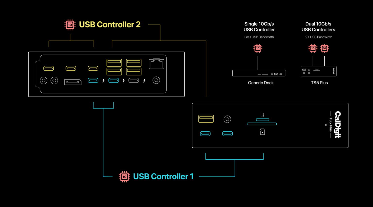

@ralph_sws , what part do you disagree with?
