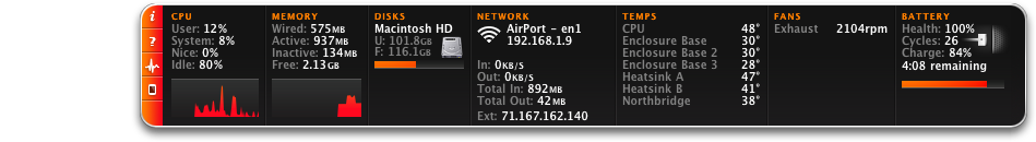

So I know there are a few other discussions regarding this subject but none of them are providing me with the info I'm looking for. I am looking to get a few responses on other MacBook Unibody's (Pros welcome too) temperatures when running intense programs (games, video conversion, etc.).
So here's why I am concerned. When running VisualHub in particular, my fans and temp go up absurdly. According to iStat, my fans are over 6000 rpm and my CPU temp hit 92c the other day. I shut it down bc I was having visions of my MB melting in front of me. I have even gone as far as propping up the back to allow for more air flow but that hasn't made any difference as long as I use pretty much any video conversion apps. Games (like Spore) make it hot, but not like this.
I can find links to the previous MacBooks temps (which I had and this was never a problem) but nothing on the Unibody's. So please everyone, do share. Please include what apps you were running or if your MB's ever shut down from overheating. Thanks!
PS This was originally posted on Apple's discussion page...and they deleted it 3x on me!! Hmmmm.....

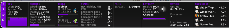

Err, not under load, but not totally idling either; running at 54° C, sitting on a cold tiled floor, with AirPort on and surfing the internet - plugged in and charging.
Usually idles at ~50° C, will check next time I'm encoding/transcoding something 🙂

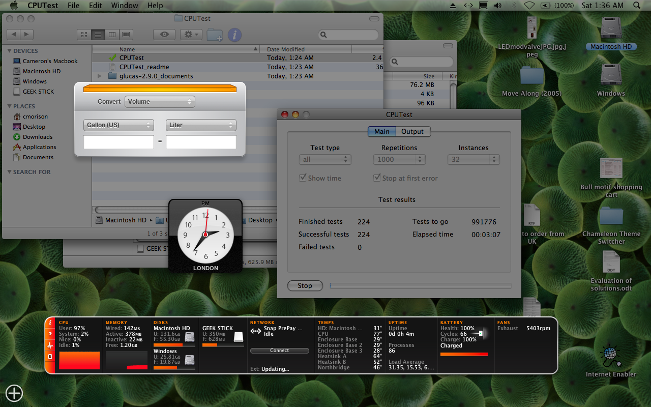

here is my unibody, running that test for 3 minutes as you can see. The temperatures peaked at about 1 minute into the test
the macbook is just sitting on my desk, not in the fridge or anything silly like that!

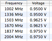

hey could you be kind enough to post your coolbook voltage settings?
would really appreciate it
