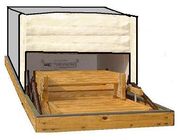

In my attic insulation research I discovered the concept of attic door boxes or tents that insulate around the attic steps, one of the main areas of heat/cold transfers due to the lack of insulation associated with an attic door. I ended up purchasing the Battic Door and am very pleased with it. The R50 model cost $100. It consists of a cardboard box, insulation, and a aluminum type reflective cover that did not cost much more than if I tried to make one myself. Of note, one of the quotes I received from an insulation contractor included a stair tent/box for $250.
Battic Door Attic Stair Insulation:
