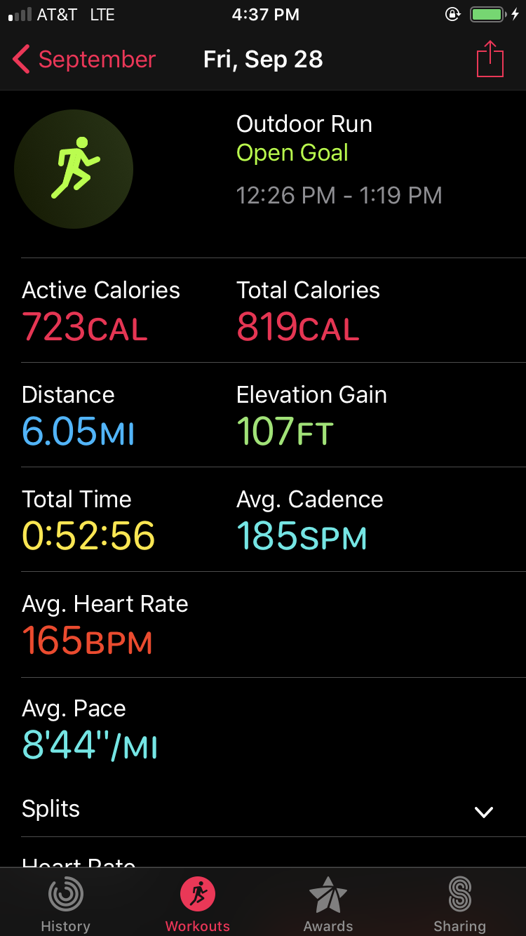

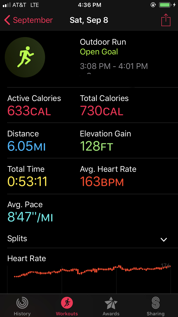

Mine is still off for my running. Not sure what’s going on. At least it’s not ticking up the exercise minutes all day anymore.

It is way easier to close my move goal since I got my 4. I wish this meant I would be losing more weight but somehow I think that will not happen. The update did not seem to help. My exercise today was only about 25-30 mins and my watch thinks I burned 462 calories. I would have expected closer to 350.
