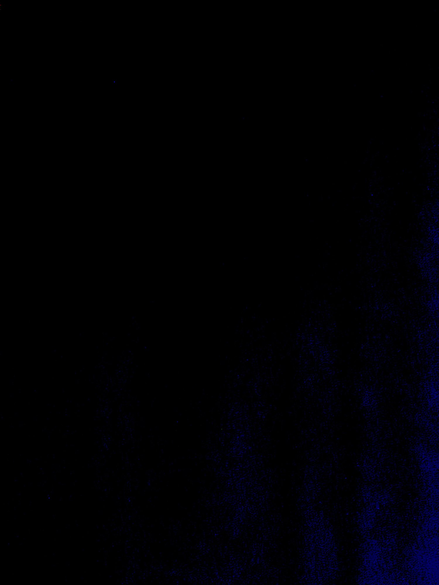

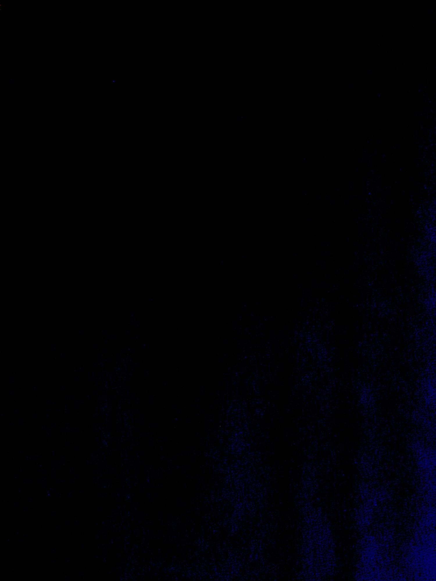

My iPhone 16 Pro Max shows the blue in the bottom right. iOS 18.2 beta 1

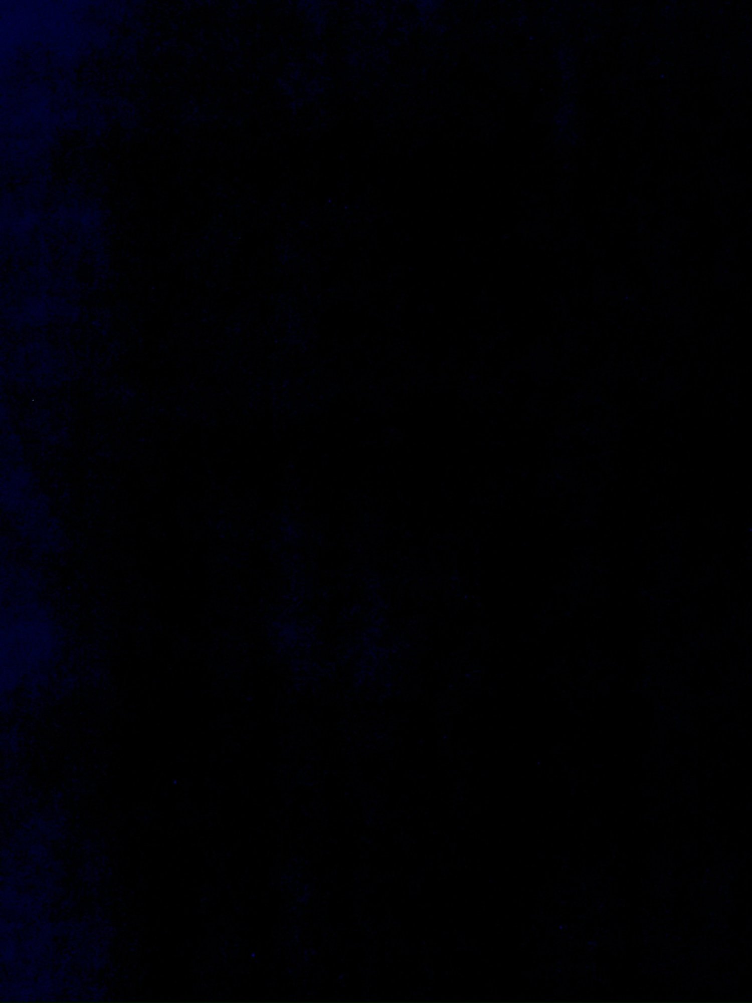

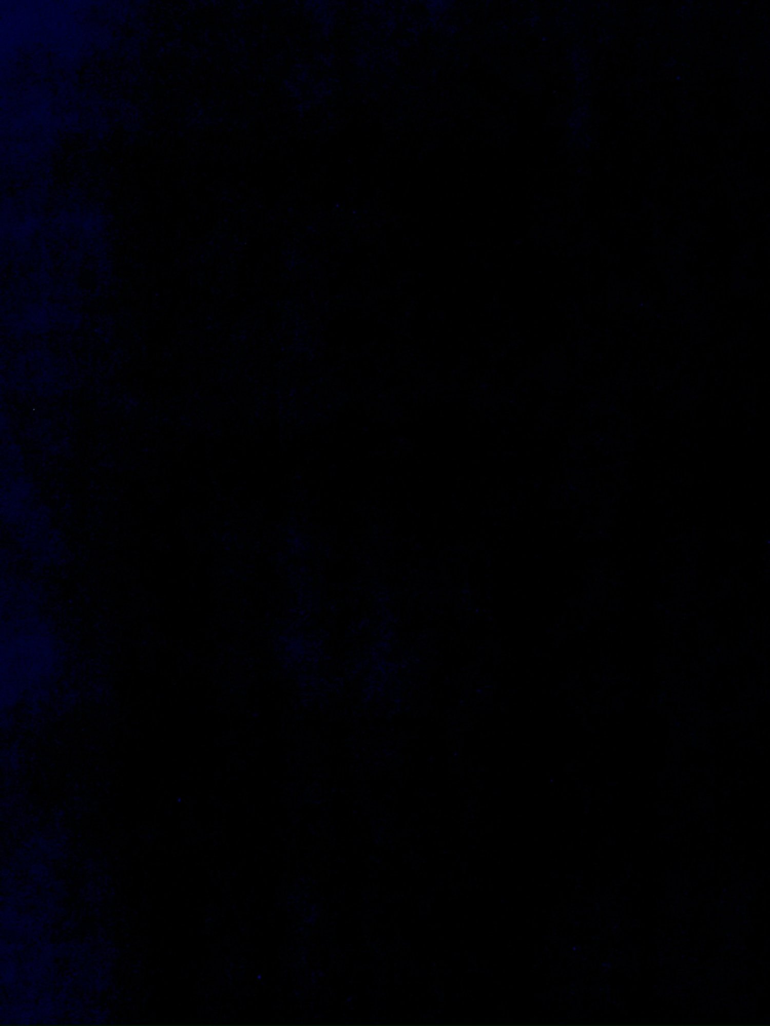

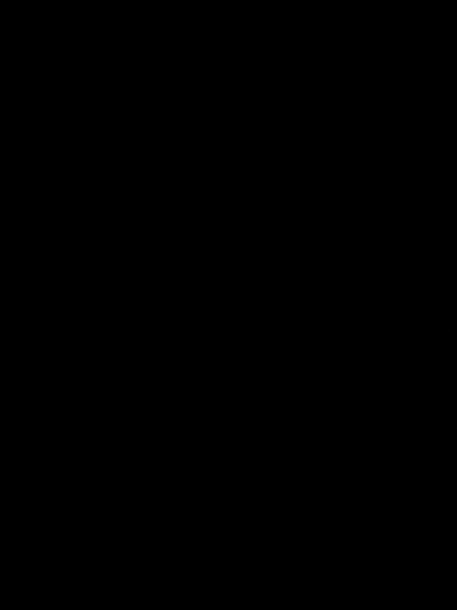

16PM, this is what it looks like for me - vertical ISO8000, horizontal ISO10000. Exposure time 30s
This is normal. Will not be an issue in normal photography.

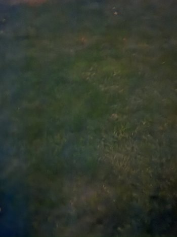

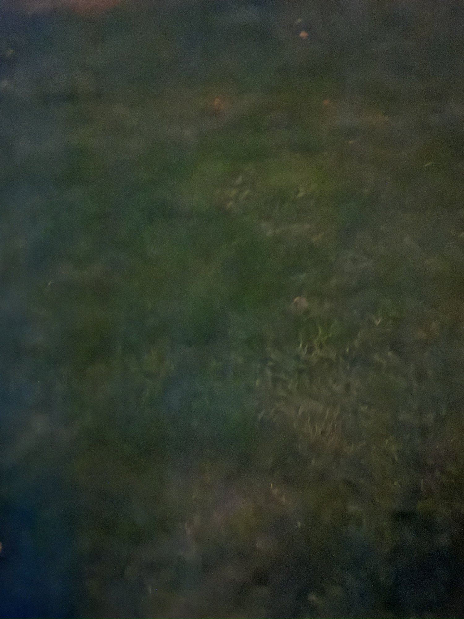

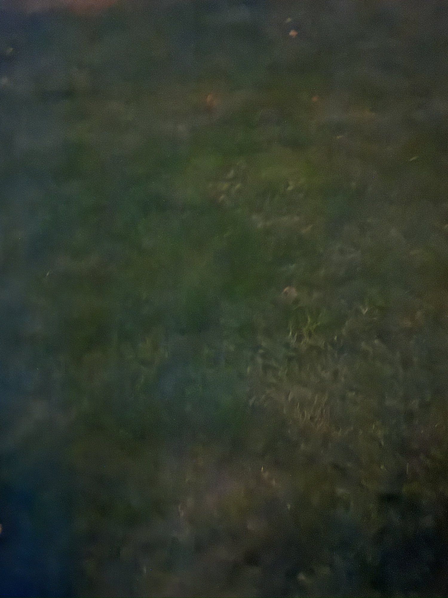

Yes, I understand what you're saying but I would like to do some astrophotography in the future and I'm worried it may be an issue at that time. This is a picture I took in my backyard on a dark night. Long exposure without a tripod high ISO: Crappie photo but blue streaking is noticeable
And herein lies the problem. It is not good enough from Apple, this really needs to be addressed. I’m convinced it’s a hardware problem.
If the blue lines are showing up in an image, then it’s not fit for purpose. No point having a long exposure night mode if it doesn’t work properly

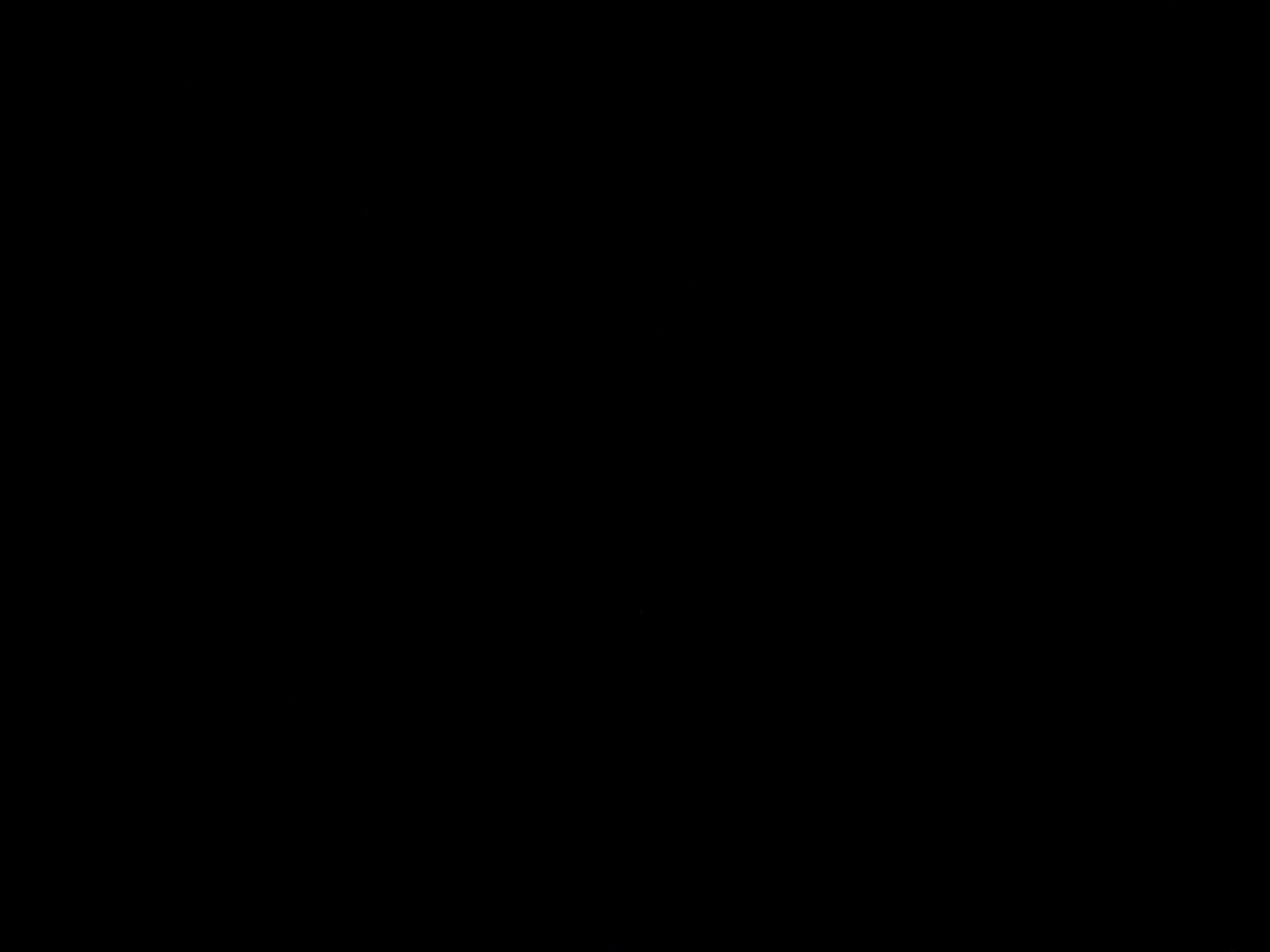

My newest natural 16 pro seems to be better, but the ISO was only 5000 (30 sec shot). I’ve had some phones with hot pixels, some with the blue streaks, but this is the first one that had nothing.
