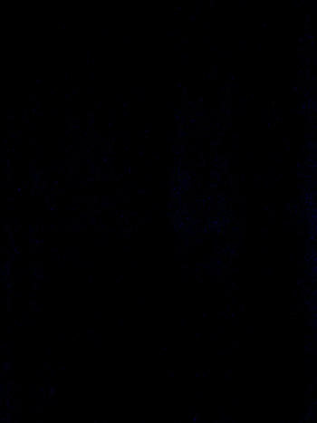

Today I have taken the first full black picture (even though I updated to 18.1 RC one week ago and tested it then too). I do not know if Apple has fixed it via software somehow and how good the fix is, I will test more tonight and report back.

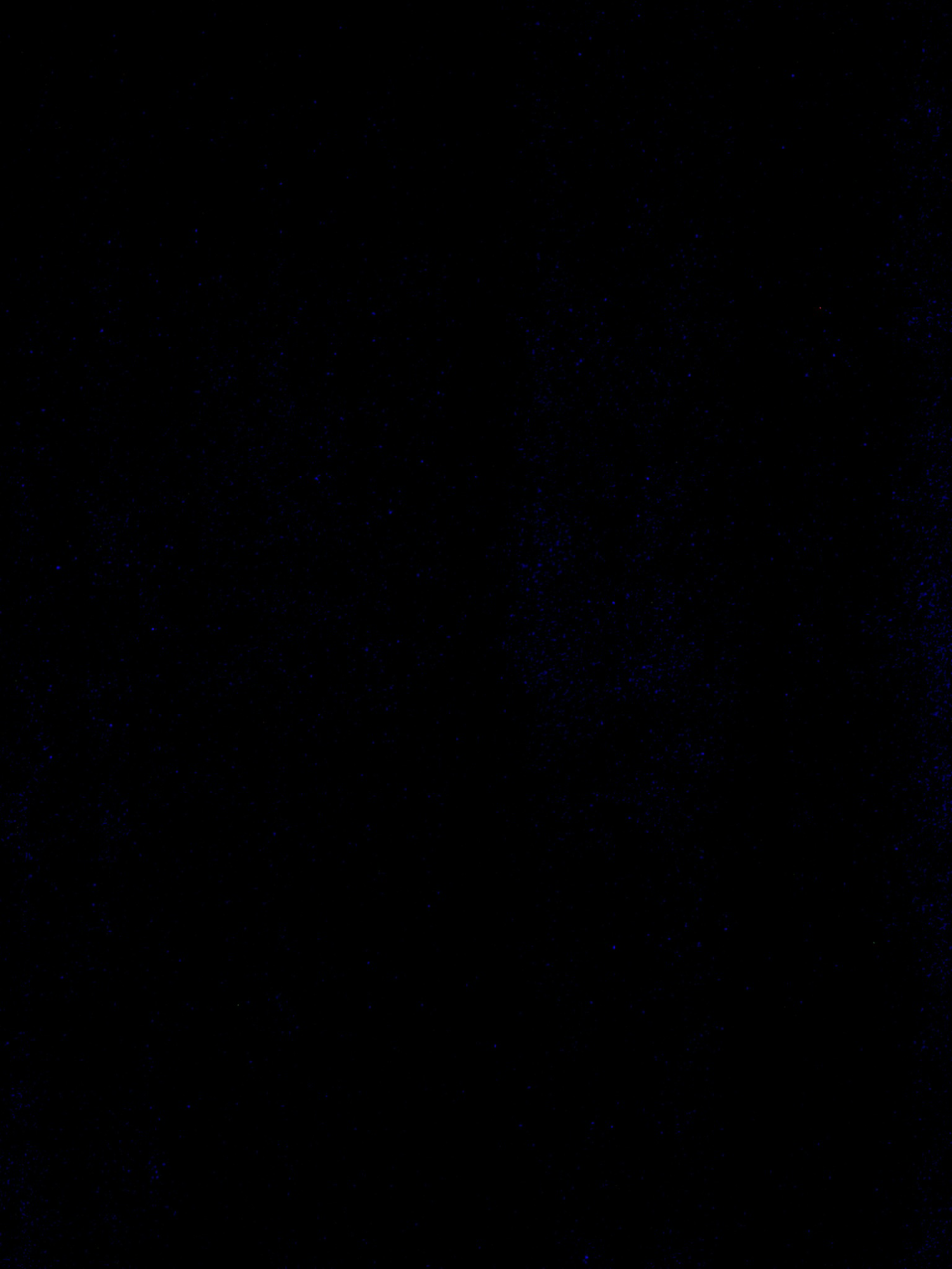

Jajos "scientific" night mode test

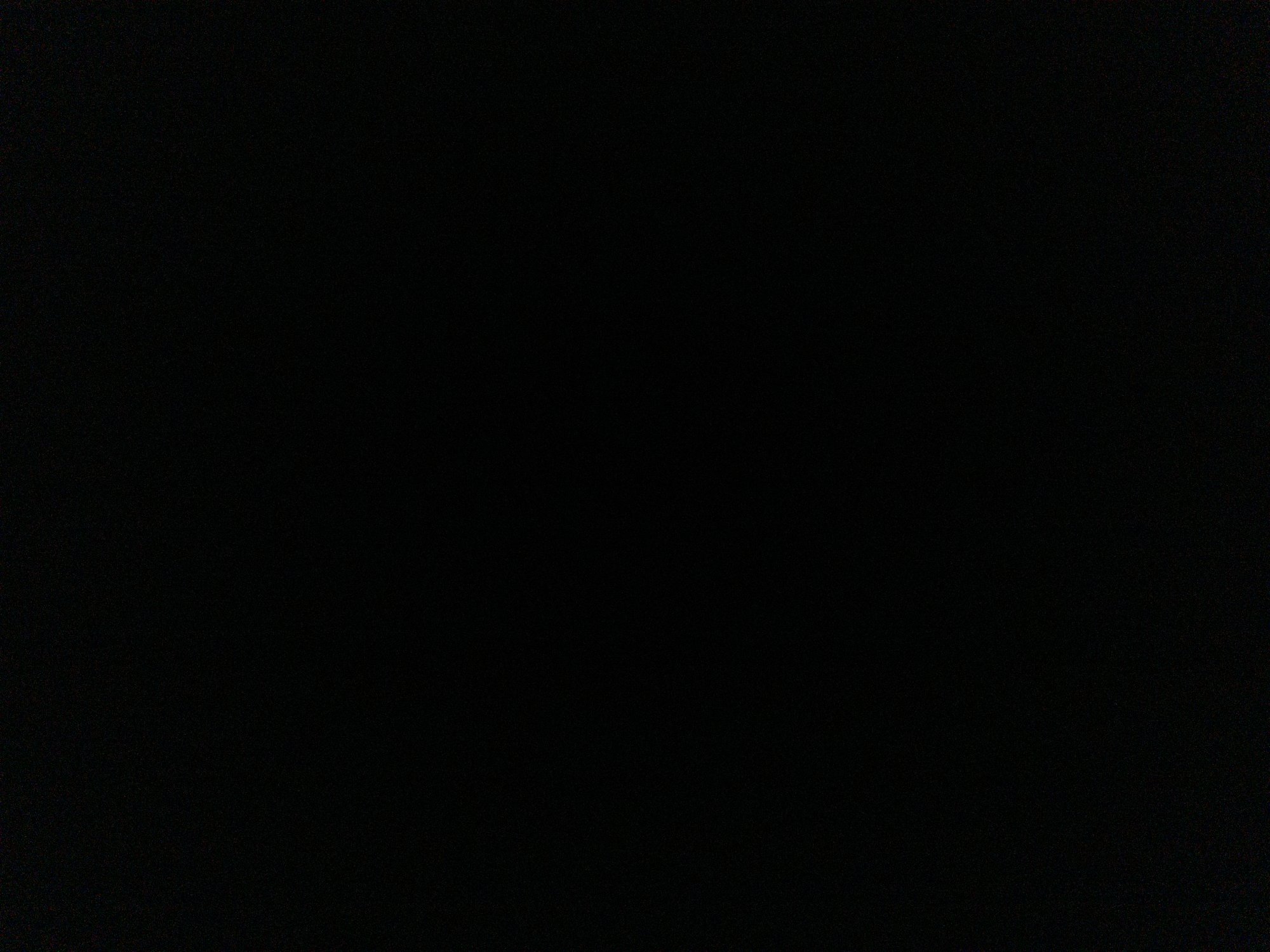

Using night mode to shoot 30s in pitch darkness is not 100% scientific because the ISO will vary between shots. That makes it much harder to judge if a sensor is faulty or not. This is a better way to test:
  1. Download a manual camera app that allows ISO and shutter speed to be set manually (forced).
    Recommended apps:
    Pro Camera: https://apps.apple.com/se/app/procamera-raw-manual-camera/id694647259?l=en-GB
    ProCam: https://apps.apple.com/app/id1562150140
  2. Set file format in the app to Regular RAW (not ProRAW). This prevents any automatic denoising algorithms to trigger.
  3. Set ISO to the max value which is 12800
  4. Set shutter speed to 1 second (1s, 1/1 or 1")
  5. Take a photo in complete darkness (for example: under your bed covering with all lights turned off, preferably in night time)

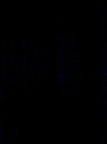

The image should look something like this if your phone is unaffected:

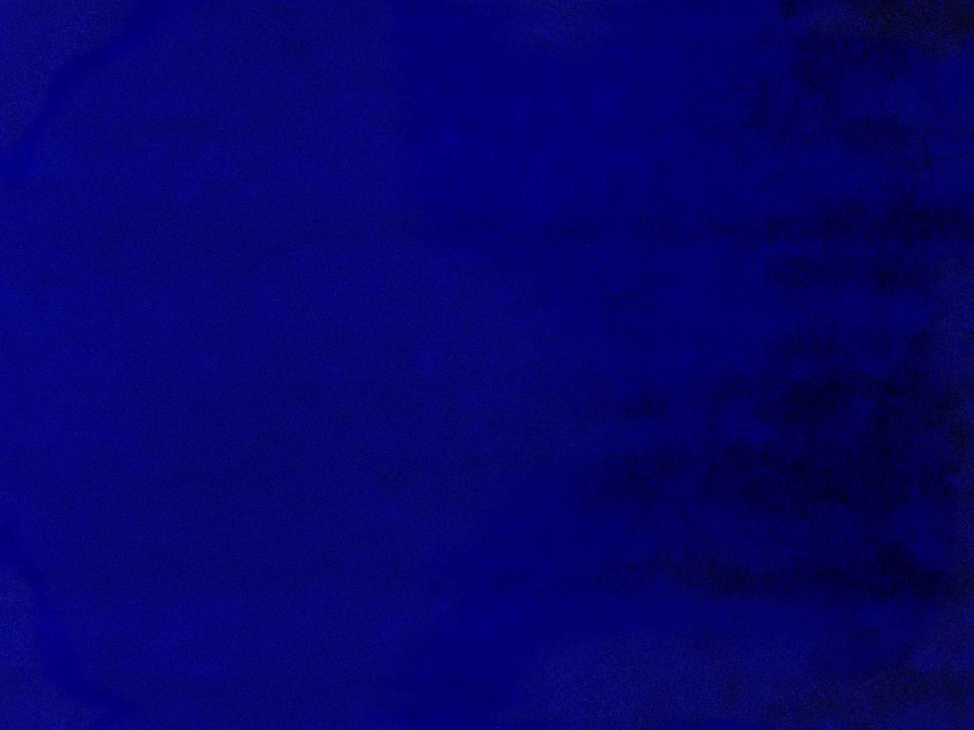

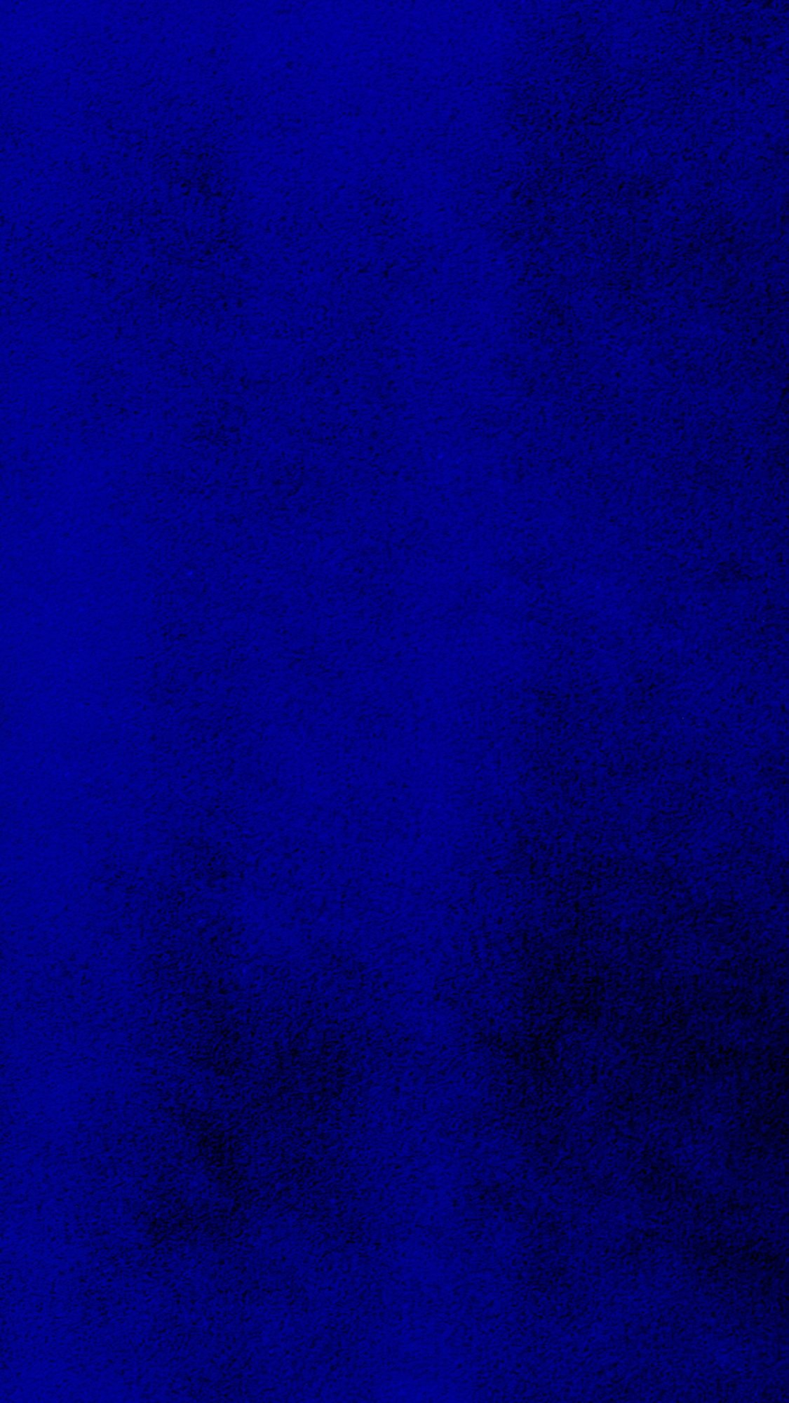

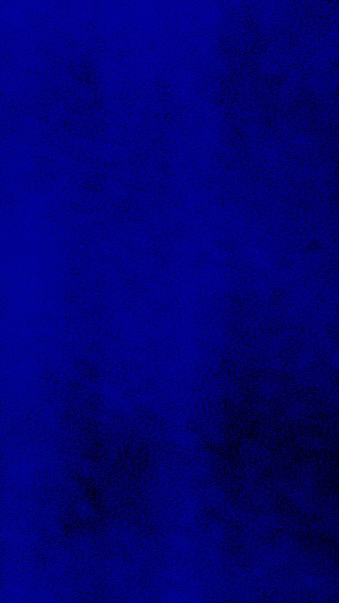

This is an example taken with a 16 Pro that had the sensor issue:

Yes, mine is definitely affected, as my pictures used to look way worse than the example you provided, I had not taken a pitch black picture until today. I will test it with the method you suggest too, and hopefully one of these evenings too, to see how it performs in the realworld now, as I also used to get the blue noise in most night pictures.
Nevermind, it only affects the "face down" test and all the blue noise is back as normal in actual night time photos :/
Still interesting whether the change was done on purpose to make the error less reproducible/ noticeable at the shops.

Hi All, I have the same issue, do you think that we would be able to analyze which series are faulty? Based on the serial number? Mine: CJ79W3XXK7

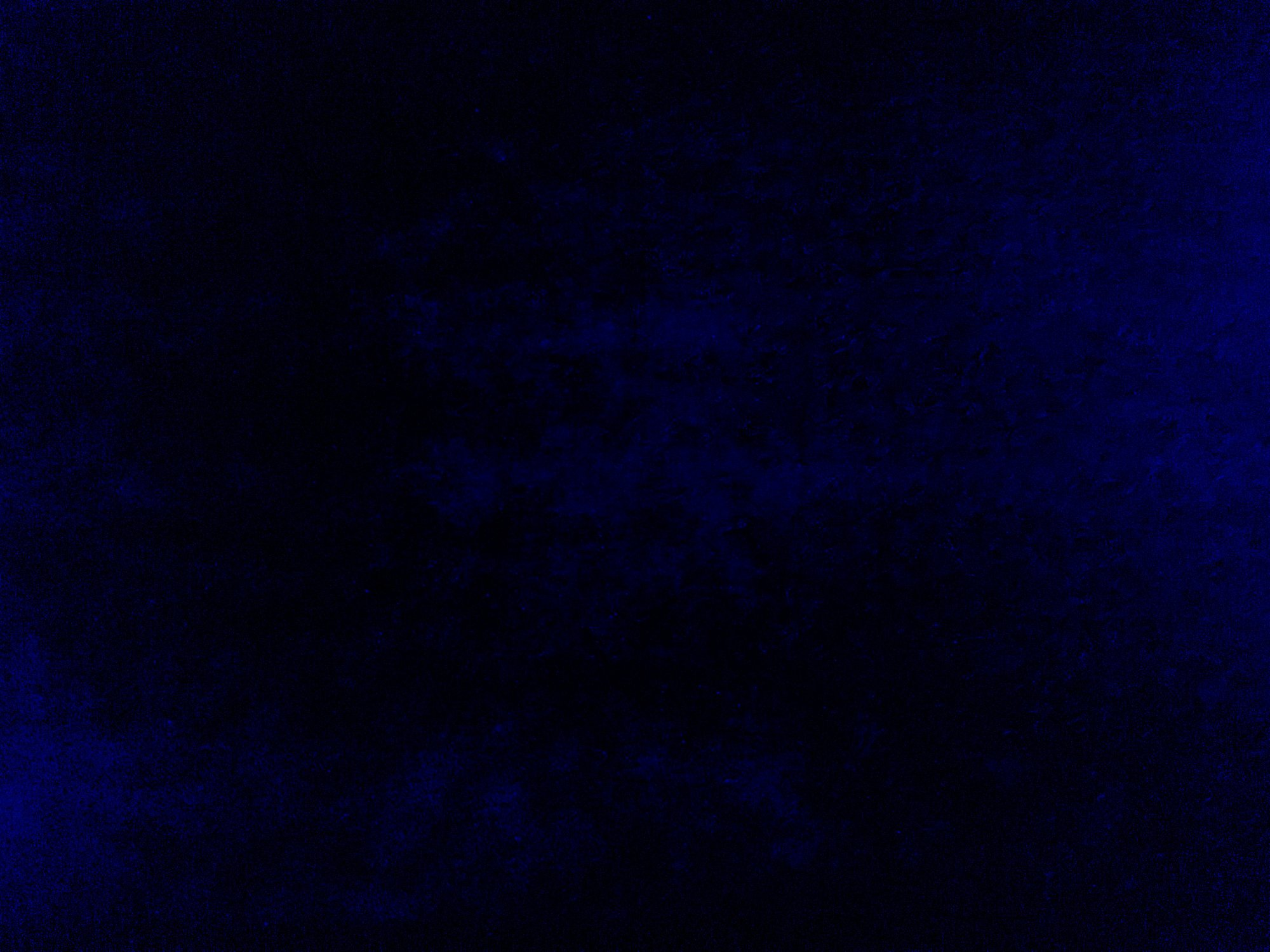

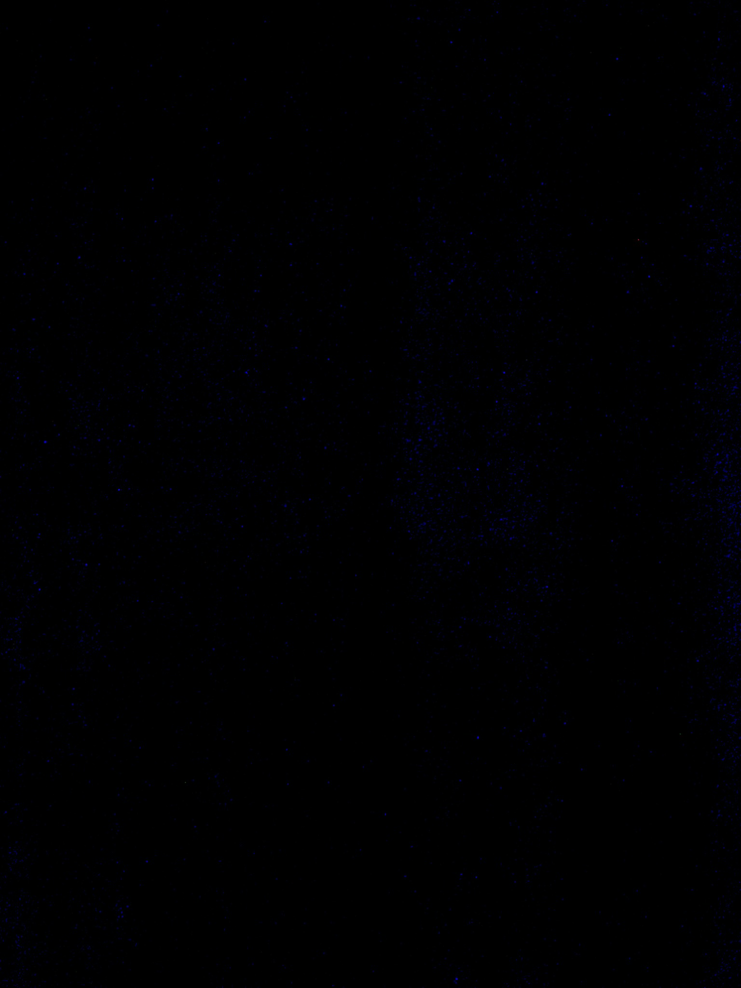

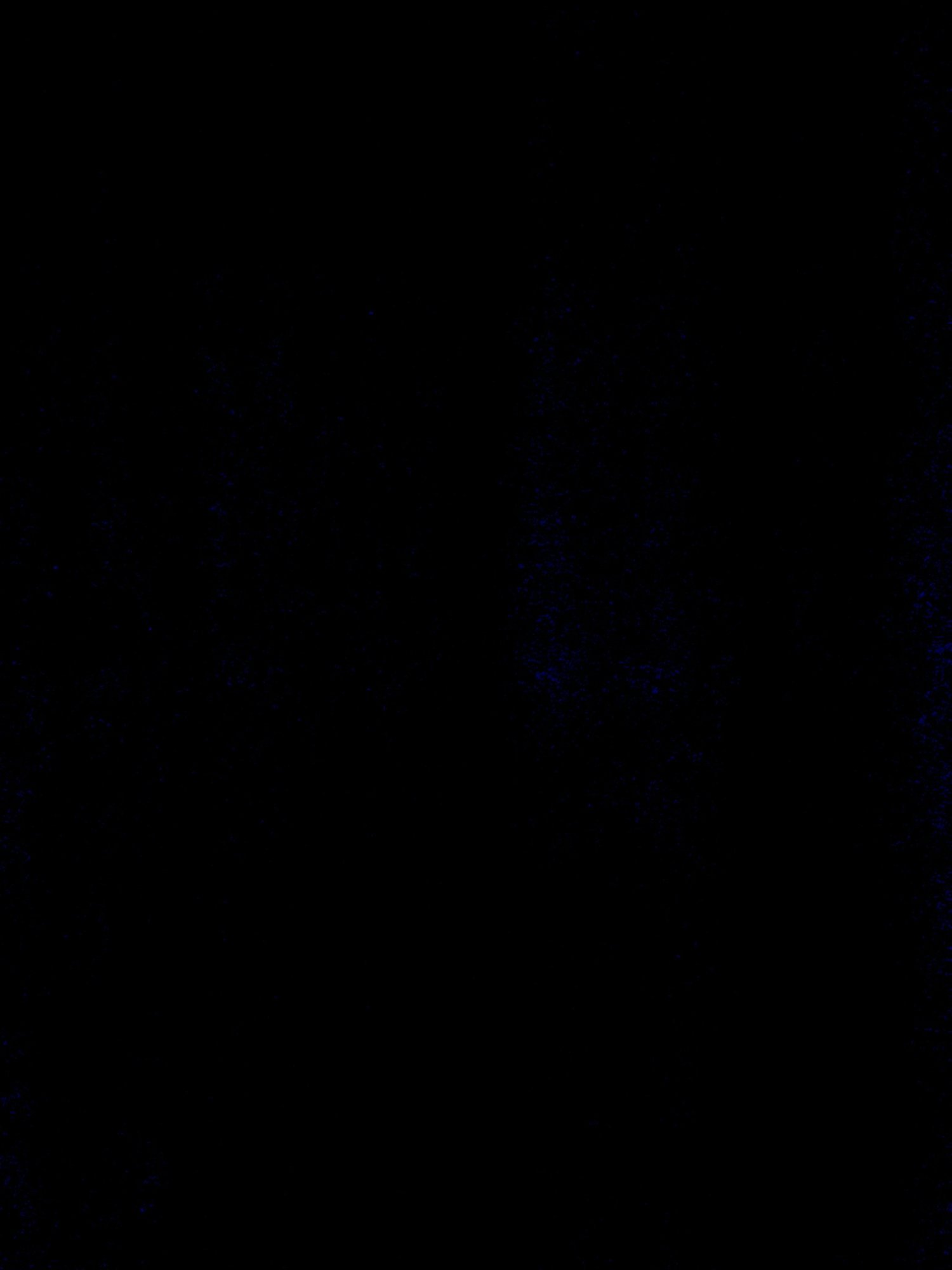

I tried this few weeks ago and i have very little blue on my unit. I tried today like 3-4 different scenarios and sometimes it has a lot of blue (almost entire screen... I think I tested with ISO at MAX), on default is very little. I think it's something with the processing and the new sensor.
This is how my mostly looks. It's very random.
Meanwhile my 14 Pro is 100% dark with few hot pixels here and there (also blue)
Edit: I'm attaching from today (from_today.JPG) with 18.1 installed. First is made like few weeks ago. You can see it follows similar pattern, but the blue quantity is different.
No idea it what category I'm in - defective or not..
This looks normal. Take a few real life astro shots and see if you can spot anything coming from the sensor rather than the actual scene. If not you are good.

What about the all blue screen with ISO on MAX? It looks like his @dantay

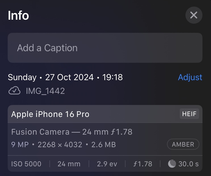

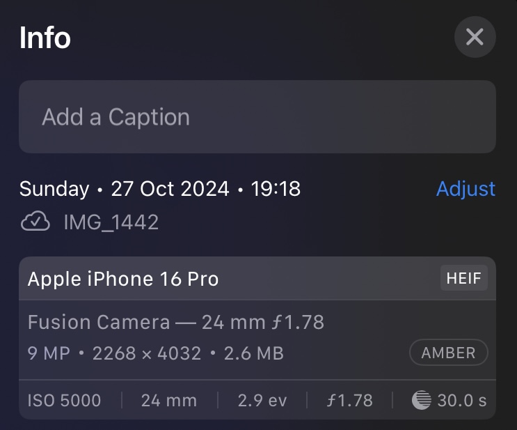

Spoke with Apple tech support today, and they informed me that they had released a fix in iOS 18.1 for this issue. However, my situation worsened while I was testing the fix with phone flat on couch. I noticed since 18.1 that the camera was going up to 10,000 ISO, whereas before on iOS 18.01, they only reached 5,000 ISO. This higher ISO setting is likely the reason for the worsening issue. While my Astro photos appear to be okay, the ISO setting was only at 2500.
In any case, I’ve sent more photo uploads and diagnostic data to Apple for further analysis.

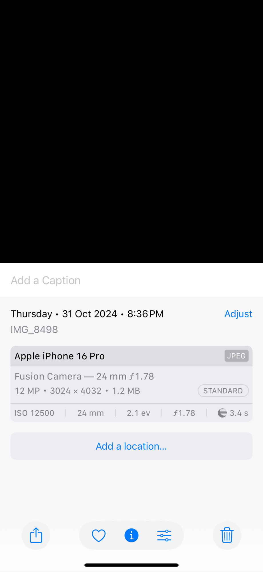

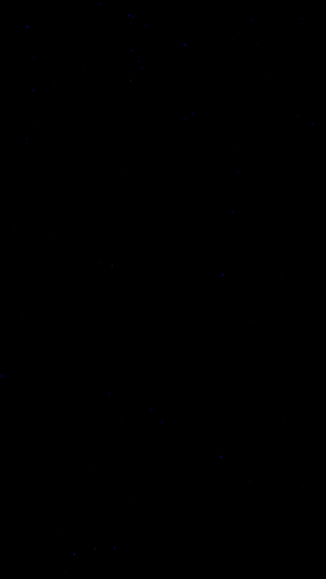

I just took a photo under my bedsheet in a dark room and got this photo with 3 seconds Night Mode at ISO 12500:
Since there are no blue dots/streaks, I’m assuming my phone’s camera is normal?
