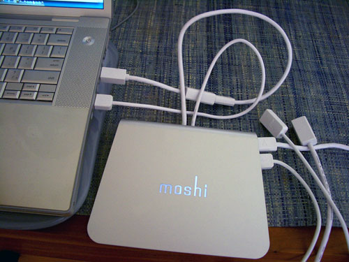

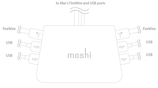

I saw Moshi has a product called iLynx FireWire 800 hub can convert firewire to several usb2.0. But I'm not sure weather USB ROOTER can run with it or not.
Notice at the top that has a USB and FireWire going to the computer. There is also nothing short of a full blown computer that can convert USB to FireWire.
The usb plugged to computer is for getting power for the hub. I believe it will give Cube USB2.0. I just confuse that it support USB Router or not.
You are mistaken about this. As the description on Amazon (and other websites) shows, "iLynx provides four downstream USB 2.0 ports (backward compatible with USB 1.1) and two FireWire 800 ports (backward compatible with FireWire 400). " In other words, it connects by USB to the computer to act as a hub with four USB ports, and it connects by Firewire to provide two Firewire ports. Since the Cube only supports USB 1.1, the USB ports on the Moshi will only run at 1.1 speeds. That will give you roughly the equivalent of wireless G, not wireless N.
