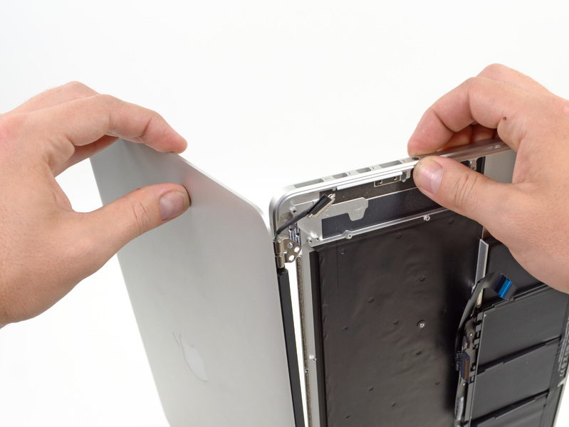

There has never been any air intake or exhaust vents through the keyboard on any Mac notebook. For all Mac notebooks except the MBP-Retina, both intake and exhaust has always been through the vents in the rear near the hinge. The new MBP-Retina has intake vents along the sides at the bottom and exhaust through the rear vents, near the hinge.
Learn about the fans in your Mac
Mac computers have air vents that allow heated air to exit. The vents are in the back of the computer on the MacBook, MacBook Air, MacBook Pro, and Mac Pro computers.
This arrangement allows for venting with the lid open or closed (for operating in clamshell mode). There is a solid panel under the keyboard, preventing any meaningful airflow.

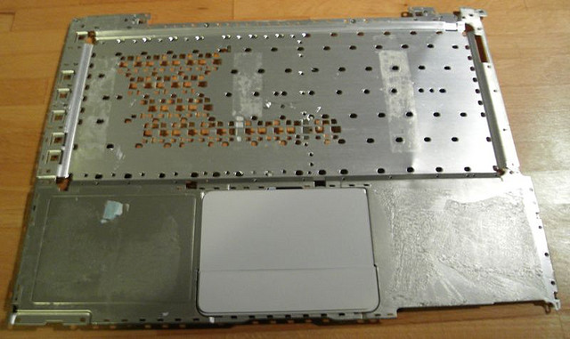

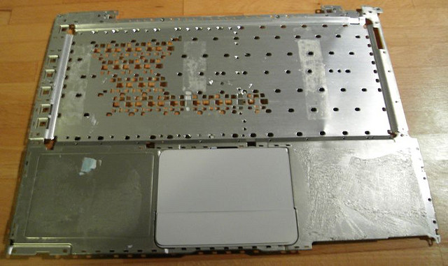

This statement isn't accurate. The non-unibody Macbooks have many holes in their keyboard to allow air to be pulled in through them. They have a high concentration of the holes over the fan and extending out over the logicboard. While the image below is of a bare 2008 Macbook, the 2006 and 2007 ones have more vent holes in the middle part of the keyboard area just over the fan.
Image source: https://secure.flickr.com/photos/34268406@N06/3188462923/in/set-72157612409546653
Those are not vents. The vents are located in the rear. That is a picture from a white MacBook being modified by a user. Those holes are covered by keys and are not used as vents for cooling the MacBook. If they were, Apple would never recommend using clamshell mode, which would block vents. While non-unibody models did have some holes in the keyboards, they were not used as vents. Naturally, some incidental airflow may have occurred in such older models, but not enough to affect primary cooling, which has always been through the intake and exhaust vents at the rear, near the hinge.
The holes in the back are the primary vents with the ones in the keyboard being the secondary vents. The way you phrased your statement makes it out as being that the holes were put there by the user, they were not. The keyboard and the keyboard circuit ribbon do not block those holes. Apple designed those holes to correspond with other holes so that the holes in the metal top case line up with holes in the circuit ribbon and are in the keywell. Air is pulled in around the keys and through the keywells into the case. Running a non-unibody Macbook in clamshell mode results in the fan coming on more frequently and staying on longer. It also results in the GMA950 throttling down due to too much heat within the case. The same things happen when a keyboard skin is used. I chose that picture to illustrate that there are indeed vent holes in that model Macbook.

The Macbook Pros, as you state to use, don't have any vent holes in their keyboard. That's why you are able to use it without much heat increase. The Macbooks in question have the vent holes and need them for optimal performance. Apple knows about this limitation and that's why the GMA950 downclocks to 250Mhz from its default of 400Mhz when in clamshell mode. Your overall knowledge with these Macbooks seems to indicate that you have never used one for very long or examined one's interior in great detail. The article you posted indicates air exit vents, not air intake vents. It fails to mention the Mac Pro's intake vent at the front of the machine or the Mac Mini's and iMac's intake at the bottom.
