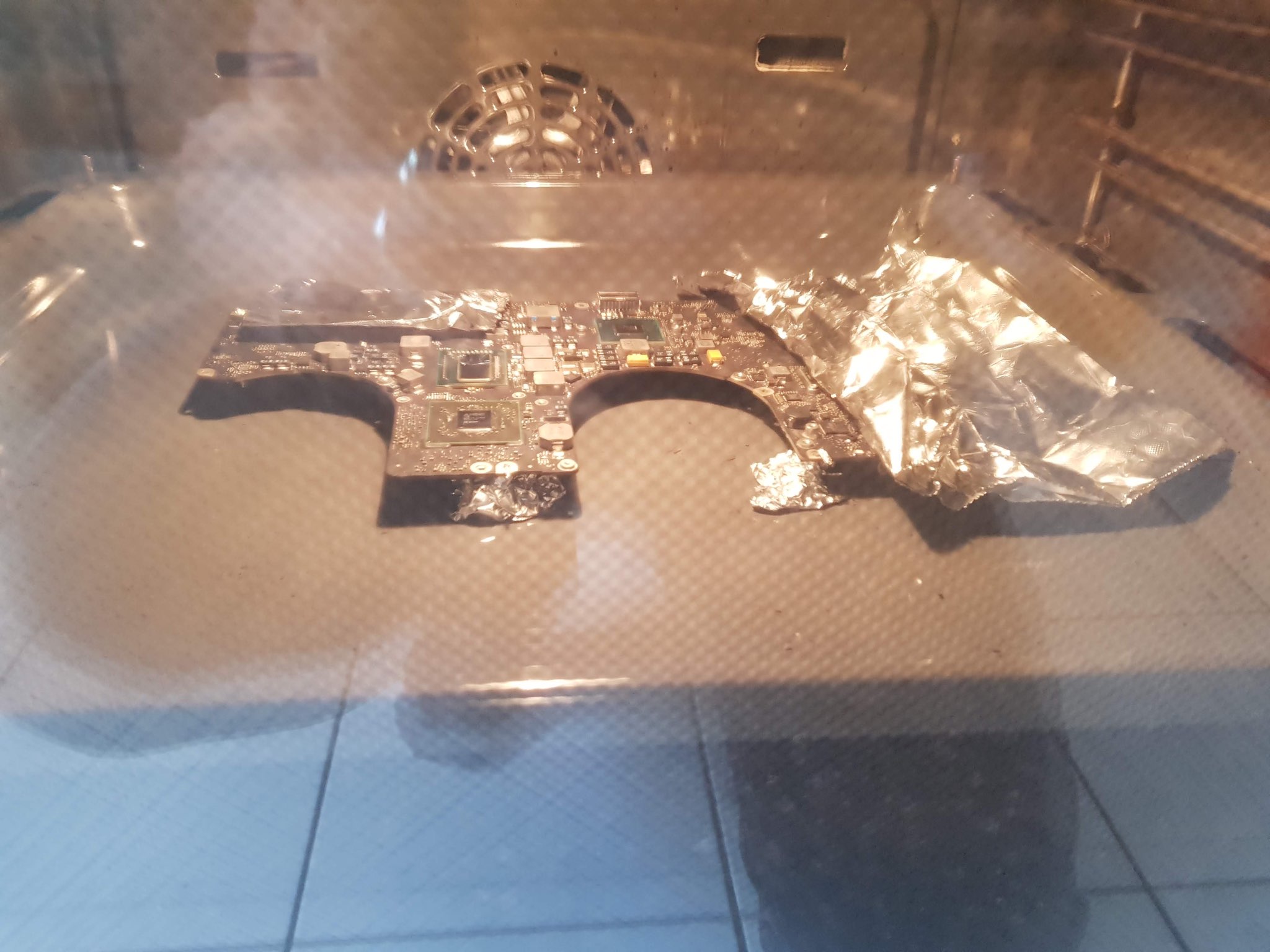

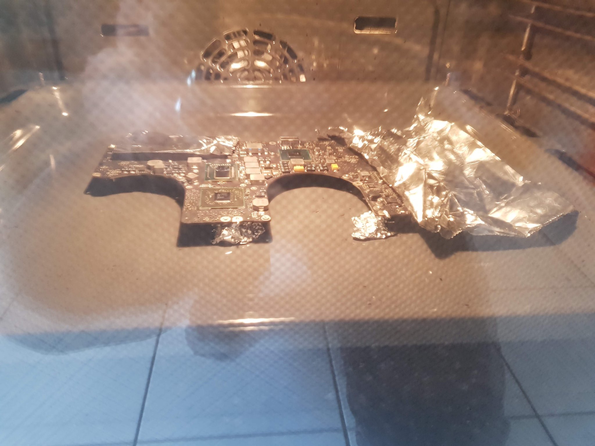

I had the same problem and I tried to get repair parts for a month or so with no luck. The solutions posted by @JMVB sounds great and I would recommend to give it a try.
I did something else, maybe a little bit crazy, but I found some reports from people who baked their MBP 17 in the oven. It seems to work for some GFX cards, too. I tried it and I am typing this post on my beloved resurrected MMP 17 2011.
But caution! You might kill your MBP with this method, it worked for me does not mean it will work for you, too!
What I did:
1) You will need some thermal paste, buy this before.
2) My guide to disassemble the MacBook is form iFixIt. You find everything here, needed tools and a really good step by step guide.
3) Remove the CPU cooler and clean the cpu / gnu from thermal paste.
4) Remove the RAM. Now you should have just the logic board left.
5) Take aluminium foil. Important - don't put the logic board directly on a baking try! Build some "legs" using aluminum foil.
6) Cover the ports on the left side with some aluminium foil.
It should look like this:
edit: please see image in attachment, link does not work...
7) Heat the oven to 200 degree celsius.
8) put the try with the logic board in the oven, bake it for 7 minutes
9) After the seven minutes, get the try out of the oven and give the logic board time to cool down, about 30 minutes or so.
10) Assemble it again, reverse order with iFixIt. Add some thermal paste to CPU and GPU. Oh yes, and take a moment to clean everything from dust etc.
That's it. It worked for me, the purple line were gone and I can use the GPU again.
But remember: There is no guarantee that this method will work for you. You should know what you are doing, I mean you should be familiar with assembling computer parts. Read the iFixIt guide closely, ask yourself if you can do it.
Reactions: kvncrw46
