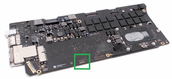

I had a mid-2013 MacBook Air with an EFI password that I purchased from a friend of mine. She put on a password and forgot what it was. I had a Mac repair shop remove the password by attaching a programmer to the EFI slot on the logic board. After running the program, I could switch between booting from internal and external drives.
The retina MacBooks also have an EFI slot.
The video uses a non-retina logic board for the demo. I would not recommend removing any chips from the logic board to bypass a fimware password.
