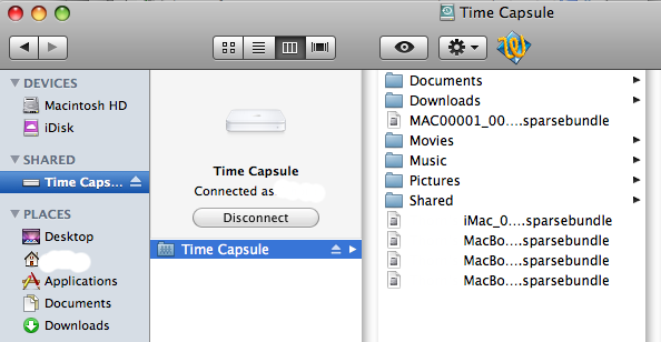

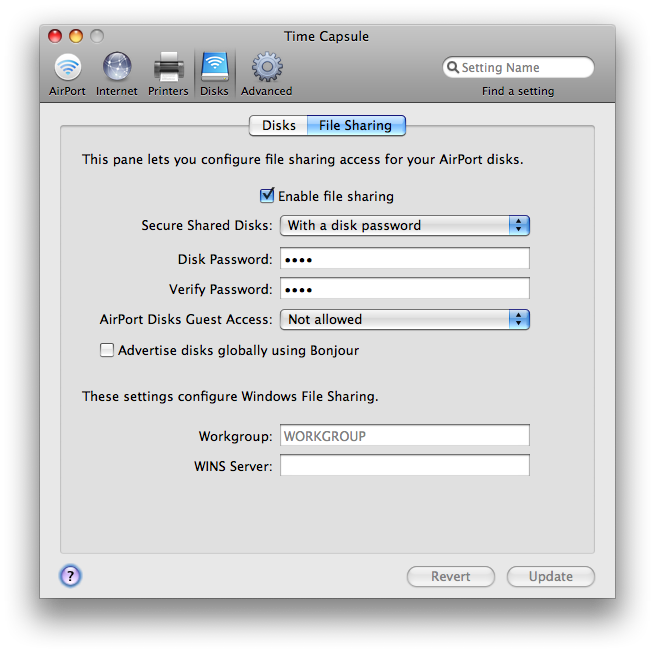

Here's the setting I enabled on my Time Capsule (using the Airport Utility program on my Mac) to enable file sharing (if you're still want to play around with that). 🙂
Once that's enabled (and you save the settings), it should show up Finder under 'Shared'. Give it the password and it should mount up a regular volume.
I have a 1TB TC with 5 Mac's backing up to it and some files that are shared between them.

Thanks for that aristobrat. Much appreciated
How do I get that timecapsule preferences window that you have in the first picture?
I found the airport utility and the settings were already as those in your first picture. So all is well and files can be shared. Thank you
It's in the Airport Utility program on your Mac. I launched that, double-clicked on the Time Capsule, and then clicked the Disks tab, and then the File Sharing tab (on the Disks page).
Edit: just saw your post. Glad you're all setup 🙂
